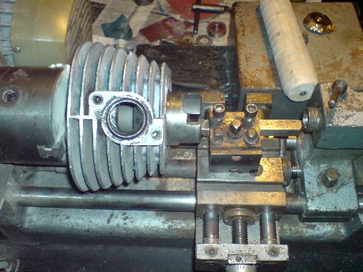

sbech
Jan 7, 2011
61
Latvia (Europe)
In short, steel (or cast iron) inner tube in cylinder does matter in repair. It can be repaired without buying new cylinder - just bore old one (if you have appropriate equipment, of course) and use a bigger piston. It has no scene, if you dont have spare pistons, bigger, and if new "normal" cylinders are cheap.
And - steel cylinder is not so easy to devastate. If you run it with bad fuel, bad oil, and overheat it, so piston started to stuck inside - you just stop, wait until it cools down, and move again. Steel cylinder will not be damaged.
sbech
Jan 7, 2011
61
Latvia (Europe)
Even damages like this:
can be repaired in case of thick steel cylinder, that is the matter.
Cylinder repair:
