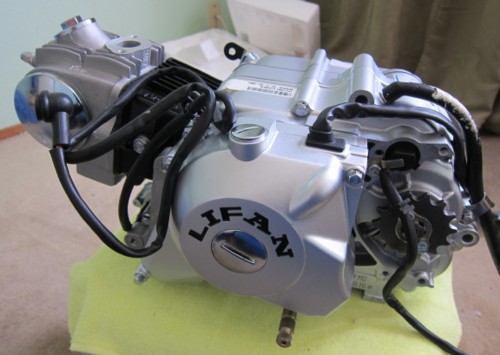

The motor I ordered up a while ago and it's here now. Very pretty, a 70cc Lifan auto clutch with 4 down (neutral on top) shifting.
Just gorgeous, perfect finish.

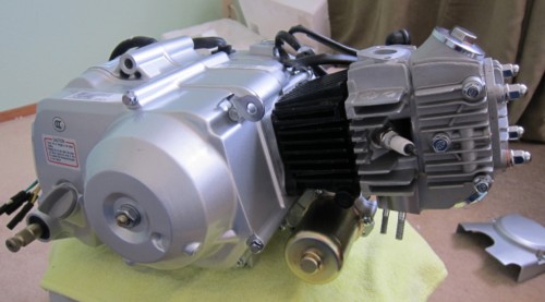

The gold colored thing under the cylinder is the starter. Yup, I'm going electric start too. Don't really want a kick starter with pedals. I'm gonna have big fun riding the rail road right of ways.

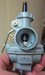

I am very happy with the motor. I didn't know what to expect having never dealt with these things before and also that it was Chinese. There really are 2 Chinas out there. That Lifan is so removed from a "happy time motor" that you would swear they came from different planets. The castings have no flash, the fit is perfect, the cases are smooth, painted silver and clear coated. This is the carb;
Keihin. Simple slide-needle, but with additional air circuits and bleeds.
