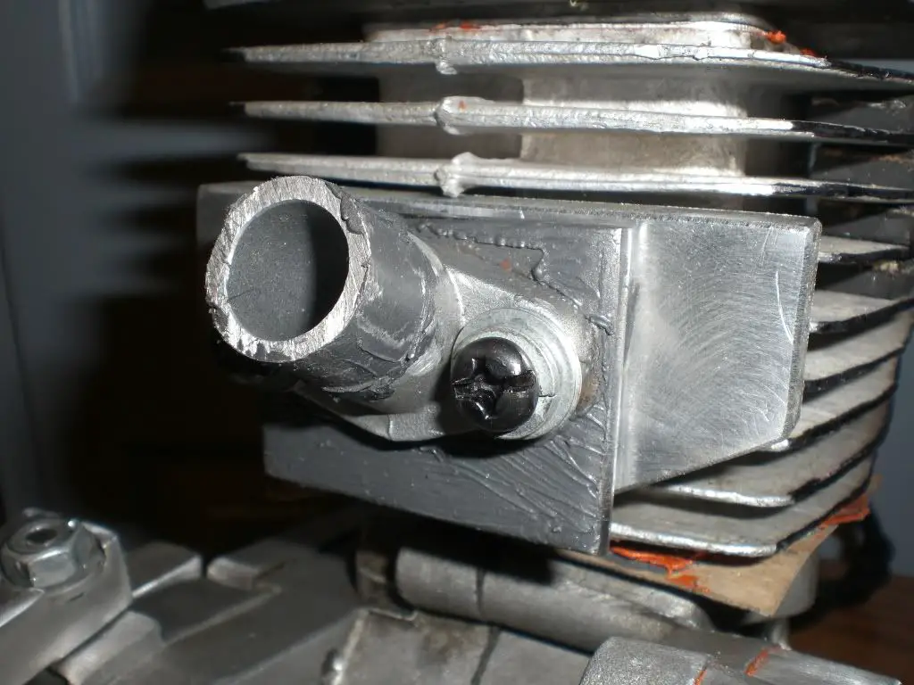

Reg,
Please post pics of the 2" spacing intake you made...and also the 1"
Jim

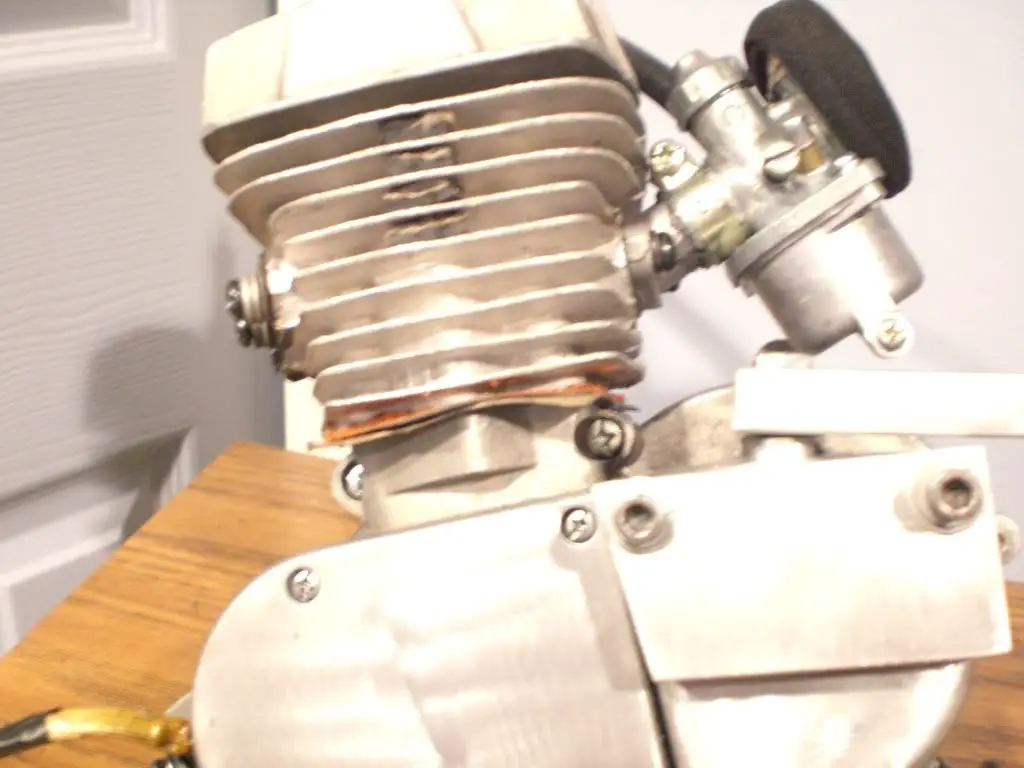

I just got back from another ride. lol's - I need to take a link or two out this is a different bike than I had before everything was fine earlier but not now chain fell off but thats an easy fix I am going to get rid of that crappy chain tensioner I have a rear derailer that I am going to modify to mount but if I can get away without one even better.
Plus the little pin that holds the clutch arm in fell out. What I did to fix it was, I found a screw a little bit bigger than the hole, drilled through the hole and screwed in the screw and it worked then I cut the remainder of the screw off becauce it was long (this is just a temp fix till I get a new clutch arm cover

This one is just a cut down version of the regular intake this is the one I get the crazy rpm range and the most HP.
Sorry not 2" more like 1 3/4". This pic the rpms are alot lower and their is bogging when you open up the throttle.
In the first pic I was doing some poking around and their is room for the carb the clutch cable will go behind the drain plug if their is just enouph room to mount the carb on the intake manifold.
Manic try it out just cut one of the custom ones down

Reg,
If I remember right, the first intake I made was 1-3/4" total from the face that bolts to the cylinder to the carb mount.
The majority of the last production run was 1-1/2" total.
This production run, I made them 1-3/8". The nipple that the carb mounts on to is just under 1". The flange is 10mm.
I did shorten one up as far as it could go...1-1/4". I can't remember if the lengths made any difference, because it was weeks between having installed each one.
The one thing I did notice was a much better idle quality. I don't know if it's the straight run or the O-ring seal that has made the improvement.
Did you actually run yours with the carb at that angle? Was it O.K.?
I've been telling people not to buy an intake unless they can get their engine fairly level. Maybe it's not that critical. I can see 5, maybe 7 degress as being acceptable.
What is that between the cylinder and the intake?
Jim

Jim yes the motor runs really well except when I run WOT for a while I can feel the carb bubbling or overflowing from the vibration but that was to be excepted from that angle, if I run at a normal speed it does not matter. Those things you saw were spacers that I made to test the difference of the spacing they are both the same diameter i clamped them together before drilling them and the main hole diameter is like 1/16" larger than the stock carb. the 1 1/4" one you made is very close to the spacing I have, mine is 20mm for the intake length and the flange thickness is like 7mm. My idle is perfect, how much would it cost to get an intake 1 1/4" made up, would it be the same price because my motor is setup to run the intake level if it is straight. I am thinking I will get better performance when I do switch to a level intake.
Did you read the post I made about my motor running lean then I did the piston skirt trimming and then it was running perfect.

20mm for the intake and the stock flange thickness is like 7mm so 27mm total. But if you read the post above this you will read about one of the symptoms I have with that carb angle that I am running right now. But if I can get a straight intake then that will solve it.
