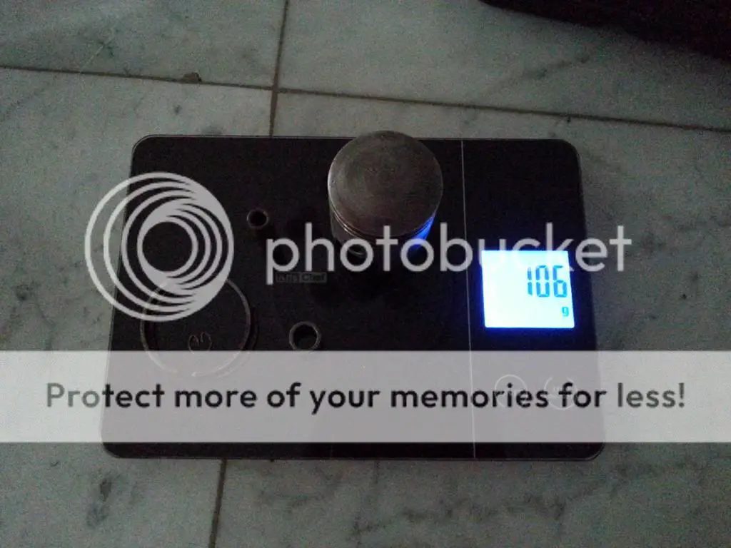

These are the measured weights:
Con rod small end = 26 gr
Piston + rings + needle bearing + pin + pin clips = 106 gr
Balancing weight = 57% × (26 + 106) = 75.4 gr
Ballast = 75.4 - 26 = 49.24 gr
I ended up shaving this much from flywheel = 36 gr (at crank pin side)

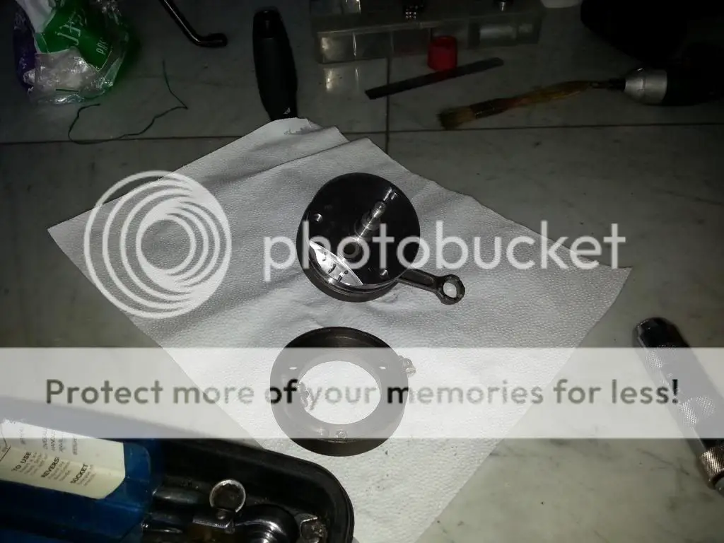

misel
Nov 22, 2012
39
Jakarta
My crank shaft is one piece type.
I think impact screw driver can be very useful for some screws in there.
And while in there, I changed all 4 bearings with Japan made ones.
I splitted the crank case carefully, then I could reuse the crack case gasket with no leaking problem.
The flywheels have a metal cover each side.
I used angle grinder to shave some weight off inside both of the flywheels.
Then when I put the covers back on, the shaved cavities were all covered, thus no change in crank case pressure ratio.
I found trouble when unscrewing the wide flat head screw on the small pinion gear, even the impact driver couldn't work, it still stripped the flat head screw, so I machined a flat head screw driver out of a chisel that can take the whole width of that stubborn flat head screw. Using this, it unscrewed easily by also using other tool to help turn the chisel.

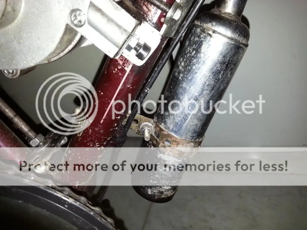

Update about vibrations.
I added a brace to hold the exhaust pipe (as shown in the picture - pardon the dirtiness)
After a few test runs, I am sure the exhaust brace took away some more portion of the remaining vibrations.
