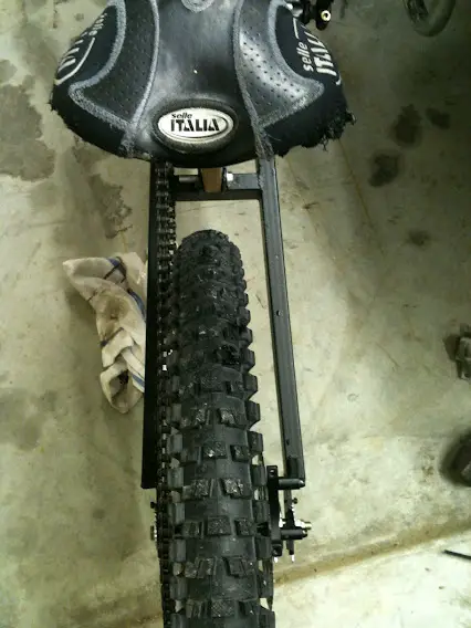

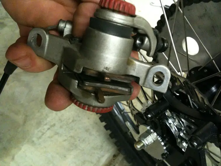

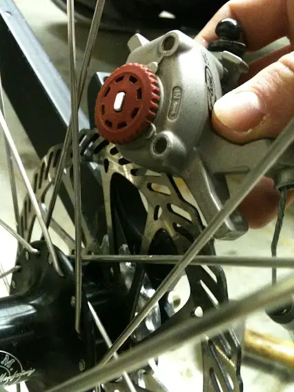

I am trying to figure out what brake to use. I can't tell what kind of hydraulic disc brake will fit with the clearance the rear of my boxer has. I know easy rider has Hayes 9 brakes but don't know if its a front or rear on the back since the boxer frame mounts the caliper on the right side of the bike. My BB7 mechanicals I have won't fit on the right side. Clearance issues and the piston is offset in the wrong direction. I will try and illustrate in images.

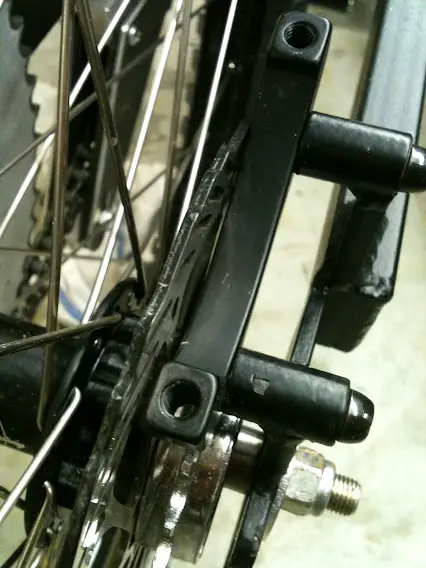

see the offset of the caliper? Won't allow it to sit on the adapter right
also once I got everything officially aligned the wheel is not in the center of the swingarm. Not sure what to do about this? When I try and put the pedal side chain on we will see how it lines up.

I see your point.
Even if you could reverse it, the cable would pull the opposite way.

I understand that. I don't have any intentions of using those just wanted to make sure I hadn't done something wrong to have that little of a clearance between the brake adapter and disc

That does look uneven. You might have to grind down a little of the front adapter holder (closest to the wheel) that's part of the frame but I would wait until you get your new brake first and make sure its aligned.

Did you get the spacer's for both sides of the rear hub in there? That wheel needs to be more centered.

On my bike both spacers are the same size. You may have the dish of center with your spokes? Learning how to maintain spokes and tension them correctly is a mandatory experience with these bikes in my experience. Its not really hard to do once you get the hang of it IMHO.
