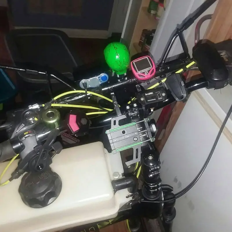

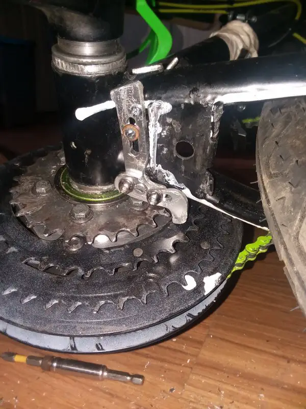

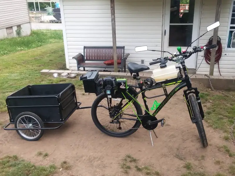

You replied to a very old thread. You wouldn't have a 18 or 21 speed either what you'd have is a 3X6 or a 3X7 drive system. Yes there's 18 or 21 different shifting combinations but several of those ratios are redundant.
Oh wait, I have triple chainring shift kit and I also have pedals. I have a Staton Inc triple chainring shift kit. It also uses two freewheels instead of one.
The Sidewinder gets shifted like this:
1(1-3)
Steep hill climbing, load pulling.
2(3-5)
Around town general use.
3(5-7)
Open road use.
All shifting is done with the left hand. The only time a chainring is shifted is when either using cogs (3) or (5). I also use a color system on the shifters [red gears, yellow gears, green gears]. The reduction range is 66.79:1 to 16.25:1.
