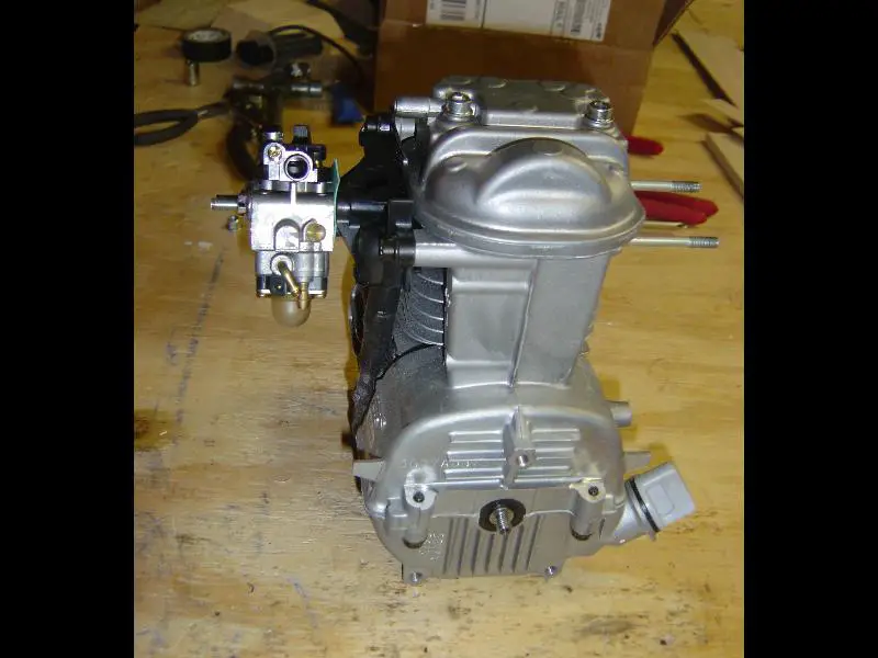

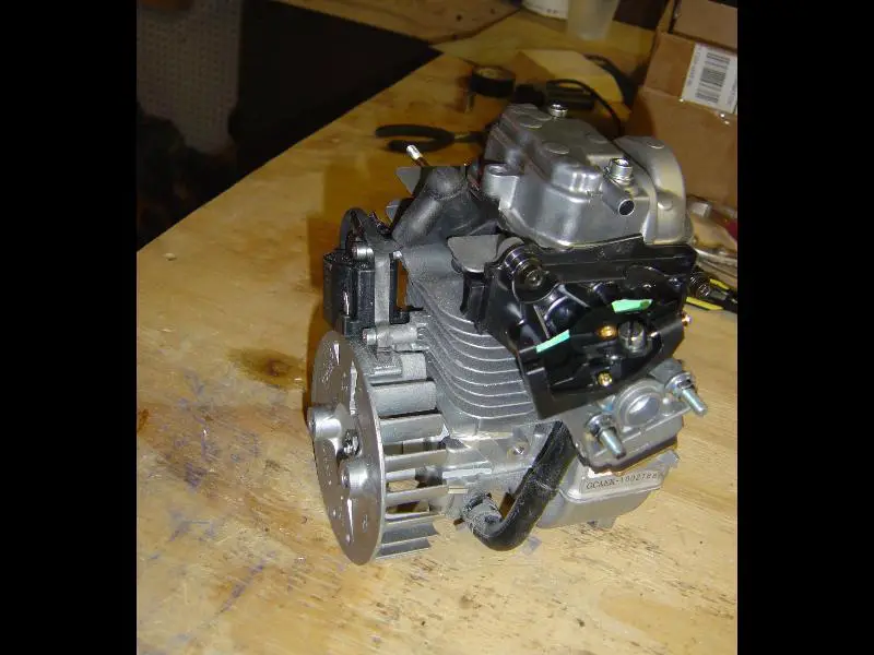

I plan to put it on my Micargi Rover (replacing my 2 stroke China girl). It won't look as cool...
Removing the top cover and exposing the motor helps with aesthetics, as well as removing the label from the starter. In addition, removing the stock gas tank and replacing it with a Sportster tank or a tank of similar style can help as well, as can replacing the stock muffler with a straightpipe going to the back. Actually, stripping the motor down to just the block, using a custom gas tank and exhaust, and exposing the block, can make the GX35 look on-par with a 2-stroke aesthetically.
A stripped GX35 should look similar to this on the frame.
Stripped GX35 with the recoil starter, and what I believe is EFI, although it hasn't been straightpiped and still uses the stock muffler.
