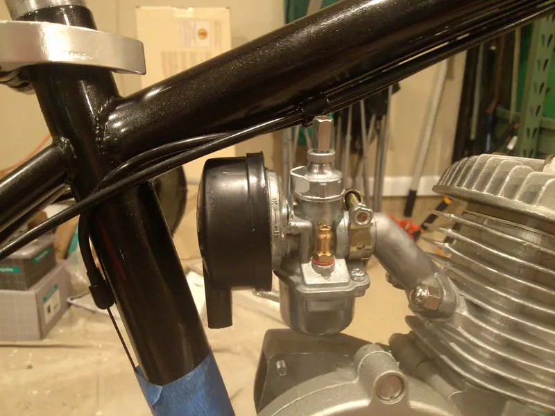

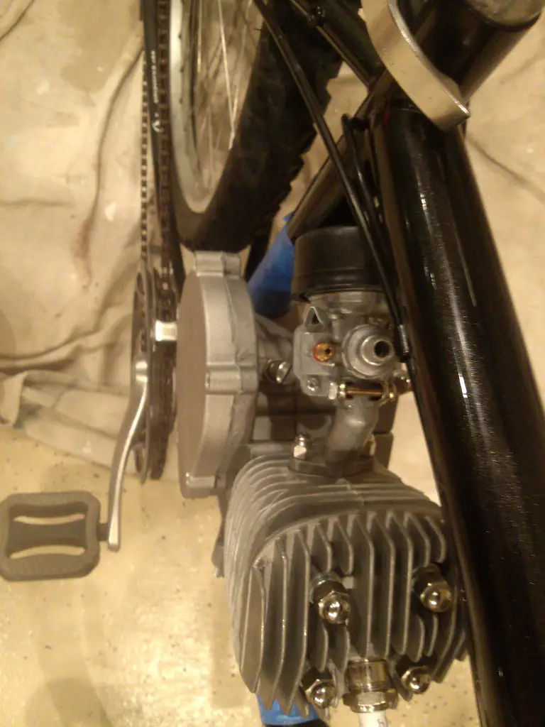

texan New Member Apr 23, 2013 12 0 0 Houston TX May 11, 2013 #1 The current bike I plan on using for my build is just a hair so small and it works if I tilt the carb by just a bit. Would this be okay or do I need a new bike

GearNut Active Member Aug 19, 2009 5,104 11 38 San Diego, Kaliforgnia May 11, 2013 #2 It should work fine. You may need to adjust the float height though.
maniac57 Old, Fat, and still faster than you Oct 8, 2011 4,484 22 0 memphis Tn May 11, 2013 #3 Looks fine to me as well. I had to remove the filter housing on The Pig and it runs great at a greater angle than your setup.

xseler Well-Known Member Apr 14, 2013 2,886 151 63 OKC, OK May 12, 2013 #4 I concur.....looks like it'll be just fine!!
2door Moderator Staff member Sep 15, 2008 16,302 175 63 Littleton, Colorado May 12, 2013 #5 Ditto: You're good to go. Adjust the float only if you have flooding problems but I don't think you'll have any. Not at that slight angle. Tom
