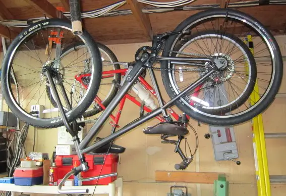

This is a 29" Dawes single speed mountain bike. It's hanging from the same hooks the Revive was on a while back. I was going to put the Robin 2 stroke on it, but I ain't building any more gas bikes.
This is getting the Magic Pie 3 28" wheel kit and that nice 48V, 20 AH battery in the sweet stainless steel case.
Yeah Baby!

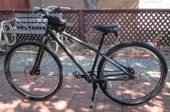

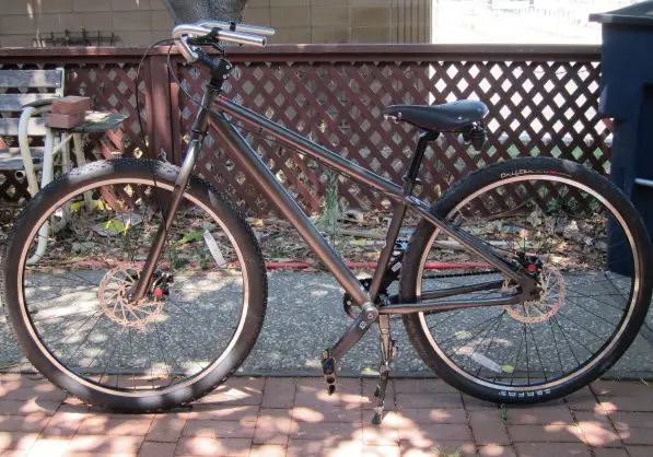

Dawes Bullseye
Pulled it down from the hooks, installed pedals & brakes, pumped up the tires and took it for a spin. I like it, nice bike. Pedals easy, rolls smooth and handles great. Very stable - :)
I have a nice Geyes leather cruiser saddle on it and my butt likes it. The handlebar is an aftermarket aluminum cruiser bar. I'm going to cut a couple inches off the handlebar and order up some shorter crank arms. This thing is goona look great with the MP3. Got the twist grip ordered up for this one too instead of that thumb unit. With the 20 AH battery I should have good speed and range as well as a smooth and stable ride.
The 29x2 Serfas Drifter on the rear is moving to the front when the Pie arrives. The Pie is getting a Shwalbe Big Apple 28x2.35, also on order.

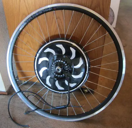

And it all here. MP3 is way better than MP2. Better finish, better axle, fan cooled, nice wires and the wheel was perfectly true. Just beatiful.

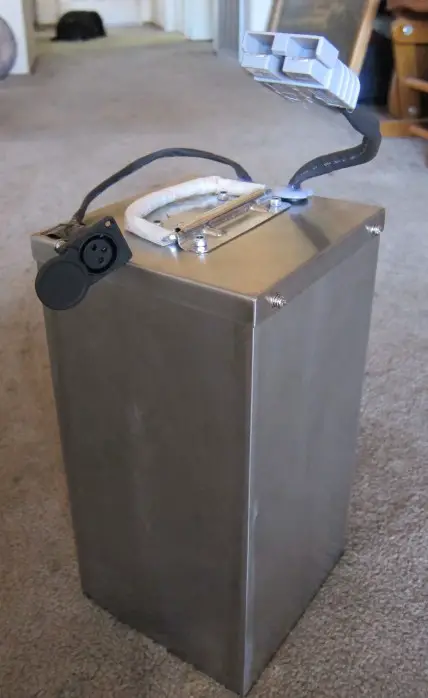

Battery is here also. High amp discharge connector, charge connector with cover, nice stainless steel case. Beautiful
And I worked on the bike too. Installed the drifter on the front, and the big apple on the rear. Try as I could, I could not mount the tire on the pie.
That's because I bought the wrong pie. I ordered and got the 28 inch pie. That fits just one size of tire 28x1.5. More properly known as ISO 37 (or 38) x 635. Not 622 like all the 700C and 29" wheels use. Damn I feel dumb.
Ordered up another MP3 of the correct 700C dimensions.
The good news is the bike just rolls so nice. I thought about mounting the pie on my existing wheels, but I would have needed new spokes. Just going to sell it, it's just so nice and true. My loss your gain.

Yeah, it would have been, but the rear spacing is a max of 124mm, not close enough to the 135 that the pie needs. I was hoping the 8 speed version would be 132 as I have seen that dimension on Shimano hubs and I could bend 3mm. Not going to try bending 11mm.
I rode the Revive into the local bike shop and the guy loved it. I told him my tale of woe re the 28 inch wheel and he offered to lace the hub to a nice wheel, so I deceided to do it. The hoop is a nice heavy double wall design and he can get custom spokes made if needed. The width is 24 mm too, so it will be better for the big apple tire.

[[Hey, I bet you get the exact pie motor in 700cc wheel. Those guys over in China break stuff out into a bunch of categories when they really only have 1 or 2 versions.
If you're open to a new learing experience, just use the 700cc wheel hoop that came with your bike if 36holes or order a 36hole 700cc hoop; run your numbers thru an online spoke calculator, and order spokes in the size you need. Niffty if you can buy a hoop, or find yours online with the ERD listed.
http://http://www.ebikes.ca/SpokeCalc.shtml
http://http://sheldonbrown.com/wheelbuild.html ]]
OK, you've got a solution on the wheelbuilding.
Maybe someone knows if the Pie has the same diameter as a 9Cont, EZ, or Crystalyte?
Kinda rewarding to build your own and it'll turn out straighter and truer.
What's this about a fan in a stock hub motor? Could you please post a close up foto of the fan in the future?

The pie is over at the bike shop and they are going to do it. Don't want to learn wheel lacing. Yes, all the hubs are the same, just the wheels change. The wheel is nice, I think it weighs almost a kilogram. The stock pie wheel is 18mm wide, 24 will be much better for the big apple - :)
You can see the "fan" at the golden motor site. They just slotted a cover on the hub.

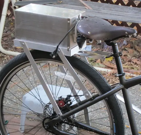

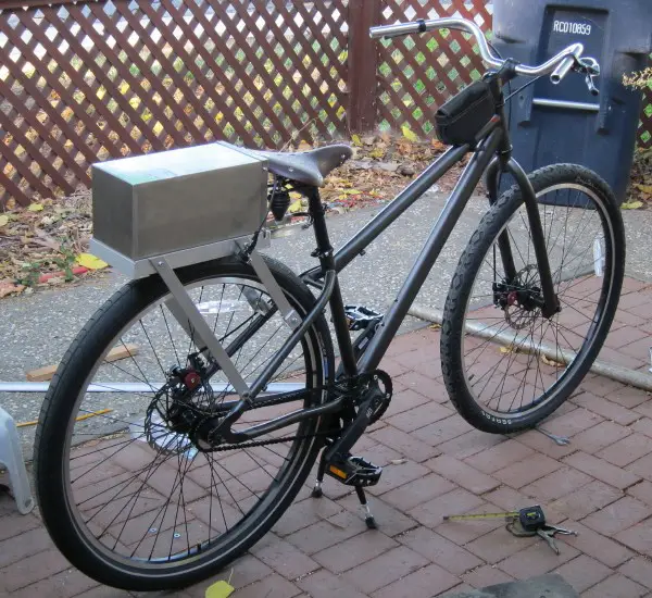

Getting closer.
Battery bracket almost done. Battery is going to be about a half inch lower, is sitting on the nuts right now. After countersinking the screws it will go to the bottom of the bracket.
Gotta lotta time in this mount. I need to add the tie down screws and some angles on the back for the tailight (gonna make another lottsa LED's custom) and then take it all apart again to paint it.
