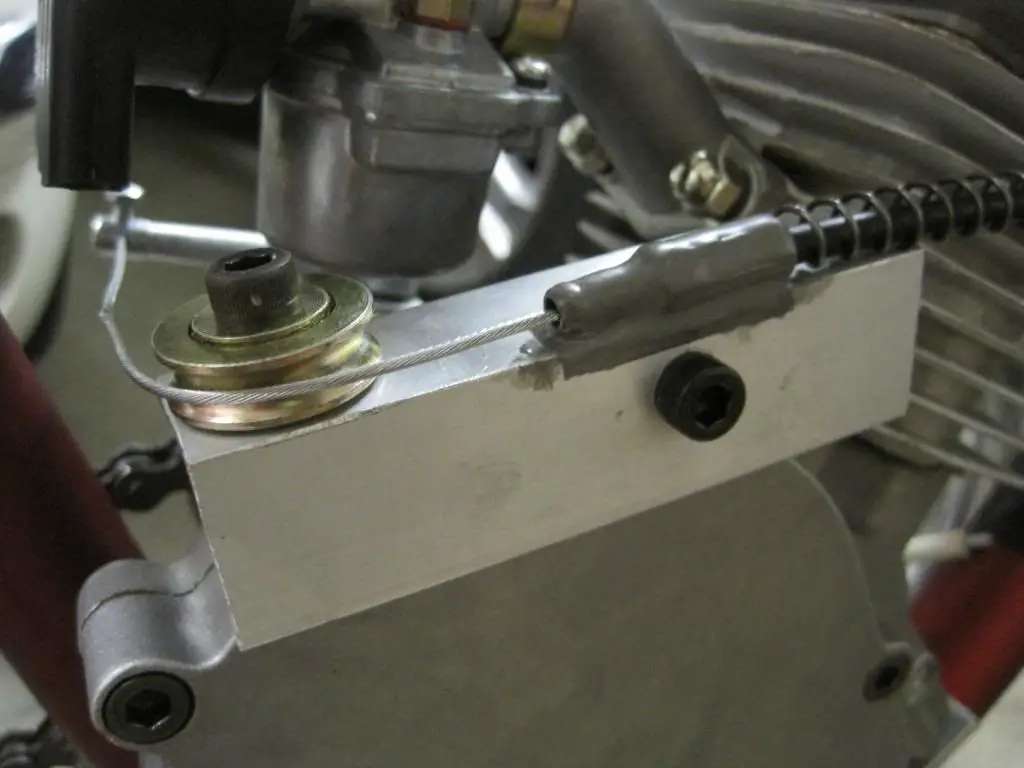

Tell me what you think!

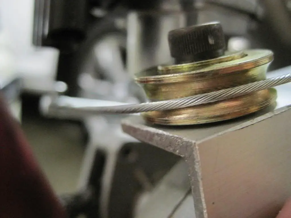

This makes it easier to pull the clutch in by 80 percent, looks sweet, and improves the angle of the cable to prevent it from braking!
Ok, so Al.Fisherman gave me the inspiration to create one of his clutch roller things.
Here is his:
Homemade Mods pictures by Ron-Becker - Photobucket

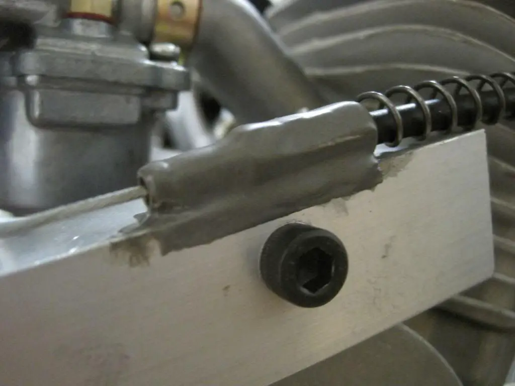

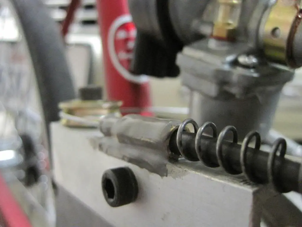

Now, i could not weld that cable barrel on the end, so i JB welded it!
The JB weld has held up great, and it doesnt look half bad. I learned after ward that you could put masking tape around the edges of the barrel to make a clean weld.

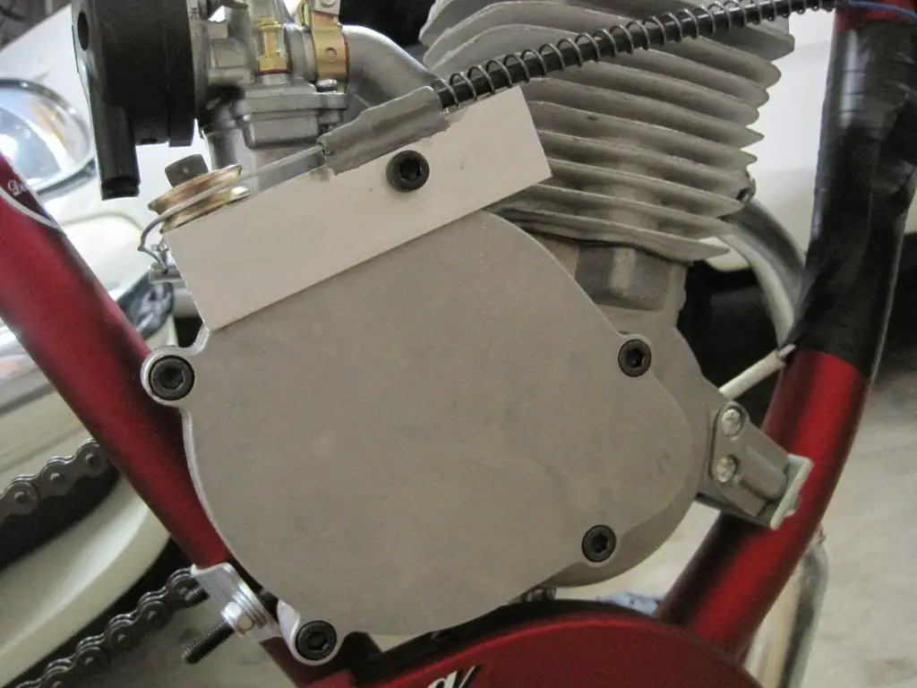

Here are more pics:
Al.Fisherman sells these premade for $17 including shipping. It cost me $18.22 to make it buti have more experience!

I also did a no welding variation of this clutch roller. I used the same roller, and same angle aluminum, but to make the cable stop, I cut a groove along the angle, and then heat bent up a tab. Drilled a hole in it and tightened on the cable stop assembly from the original engine mount method.
It works like a charm - no glues, epoxy, or welding required... Just a torch, and you could probably bend it without heat just fine.

Well... I literally JUST finished it yesterday. While all the threadlocker and gasket maker was setting, i made this clutch roller.
I also have trouble getting the rear sprocket to be true. How do i do it?
