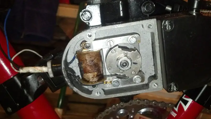

Here's an idea for you to check.
Make sure your magneto rotor in indexed correctly. It should look like this when the piston is at TDC, with the rotor keyway at 1 o:clock.

yeah it's like yours. I just checked it. At first I thought it was off, by moving the back wheel to TDC..It looked like my picture. then I put it in your position, and looked at the piston and it was TDC.

Honestly from the sound, it doesn't seem like anything is wrong compared to the sounds I get out of my motors.
