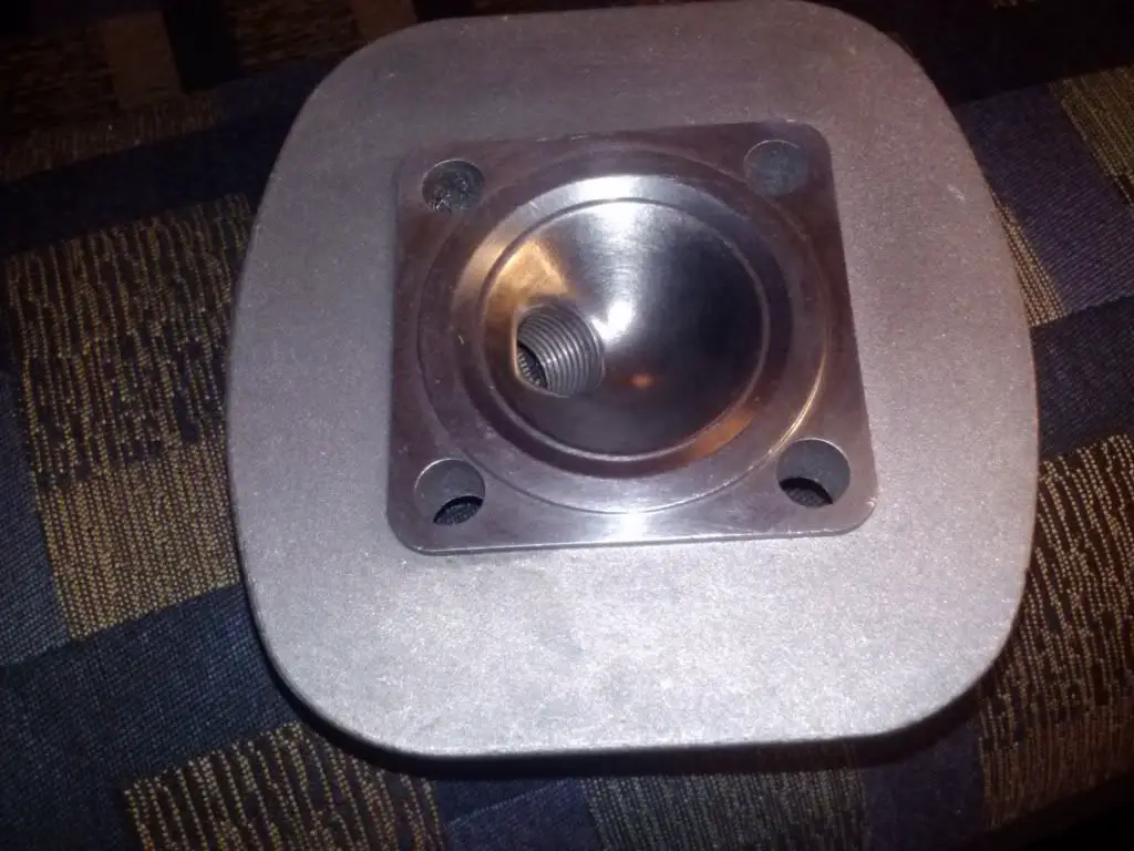

just wanted to share pic of head I got in today from Dax

I ordered the improved squish band angle plug head from Duane the other day just out of curiosity and for use on one of my engines of coarse, looks like it has been improved a bit, very nice clean machine work so I thought I would share a pic and get some feedback from whom may wish to comment on this heads improved combustion chamber.

looks good to me man let us all know how good it works
Yeah this is a much better looking chamber than the stock head has, not sure if it will make a noticeable difference in how the engine runs or not, but if it boosts compression a tad and makes the mixer burn more efficient then that should translate into little extra power at least on the bottom end and or for pulling hills, seen Duanes add in his parts list and just had to see one up close and try it out.

Naw man thats the way they come nowadays! Much better kits recently. All the motors I have bought recently have had machining like this

I'm using one on the bike I crashed. I was testing those heads, comparing with a standard straight plug head when I had the accident. I didn't get to check accurately the difference in performance but it was noticable.
The combustion chamber is smaller than the standard head, easily seen when you lay them side by side.

The two heads that are together here in one pic is a straight plug head off of what I believe is a Flying Horse Engine and the other with it is a Chrome Slant Head I ordered a couple years back from BGF, the single pic is the Dax Slant Head and it is a much better looking chamber for sure and smaller for higher compression, it may not cool as good as the Fred head but the performance may be very close, I think on my next build Im going with a bigger carb and this head with a expansion chamber exhaust and see what my bike will do with a 30T sprocket Id love to have one that would cruise at around 38- 40MPH, hoping the Dax lower with a good combo of parts will get me there on next bike.

Why did they machine that ring back into he head? For me, the head is junk because of the ring. It will leak and warp with no way to stop it.
After reading this thread. I checked the head on my latest engine from ebay and it seems the head HAS had some extra machining done compared to the older motors. I like the squish band and it actually looks like it will work as intended to improve burn. I wonder if this is why the last four or five kits I've built have seemed so much snappier...the chamber in my head looks like the Dax head above.

I've never had any leaking ssues with any of the stock heads, if the heads are torqued down evenly and with correct torque they work great and do not have leak issues , many of us here have hundreds and even thousands of miles on these stock heqds with no leak issues.

the issue with the stock squish band is it's not formed to fit. The piston is 47mm and the combustion chamber is ~39.5mm. Dax shaped his so it conforms to the piston better, allowing a smoother, more even burn. However the deck height for some of these motors is quite ridiculous (mines around 2mm, 2011 version). and the angled plug doesnt help. Squish bands are nice for compression but increase temps due to a slower, secondary burn (burning the gas that was protected by the squish band during compression) if properly applied, and you lose power from that. If you can get the entire chamber to burn as quickly as possible you'll produce more power with less fuel, and reduce the risk of detonation and reduce heat from the second burn. Honestly, shaving the straight fire stock head would be the best solution I would think.
But... then again I'm still learning 2-stroke tuning. But I spent alot of time thinking about these things and reading up on the physics behind it

I just installed this head today . I can tell you that the head is also Decked around 2mm compared to my stock head. I had to tighten my clutch to get the bike to turn over.

Their was a noticeable difference with this head. I would go as far as to say that it out preforms my first Jen Manic head for half the price. Hear is a pic of the head after I polished the dome.

Didnt do anything to mine, just bolted it on, my bike runs good with this head but compression is a bit low for my taste, once I get my puch head on this engine I'll shave the da. Head down a few .001's and put it on one of my other engines that jas the old style head on it.dnut
