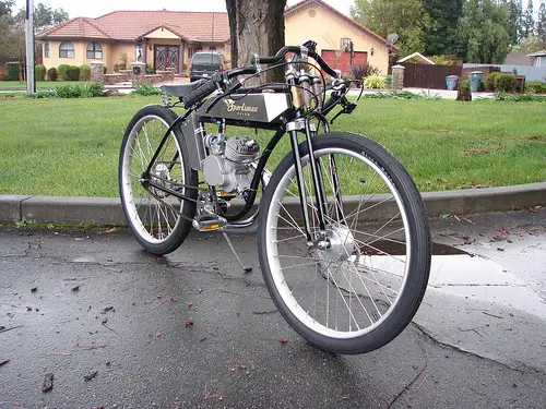

I am currently testing the prototype sprocket adapter. I quickly installed the adapter and went out and flogged the living s..t out of the thing on a Sportsman Flyer Deluxe that has all the little high performance tricks done to a 66cc Grubee slant head engine. The only concern I had was that the grease on the chain got my new sprocket dirty, otherwise it performed perfectly. After all, it is just a simple sprocket adapter.
