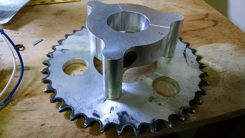

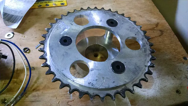

I also forgot about this little gem that I fixed.
My brother hooked it up with his old one. He had forgotten to loctite the allen head bolts and they backed out on him...luckily it was only at a few mph.
Buuttt...a little tap and die magic and those threads were chased/cleaned and the end of the threading was recut a bit to fix some of the damage that happened when the bolts wobbled out.
My bro ordered a new sprocket/adapter with a lesser tooth count...so he wasn't going to use this anyways...might as well use it!
