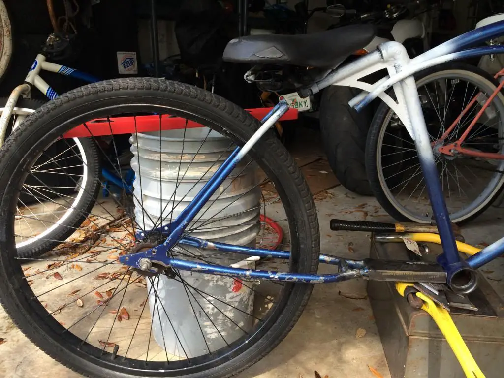

this is how i bought the bike for 30 bucks then went to chopped the back end off and added 5 inches along with a new support for my rear seat.this is how she sits right now.

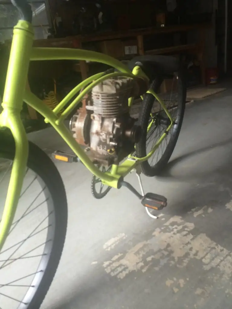

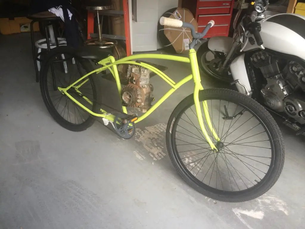

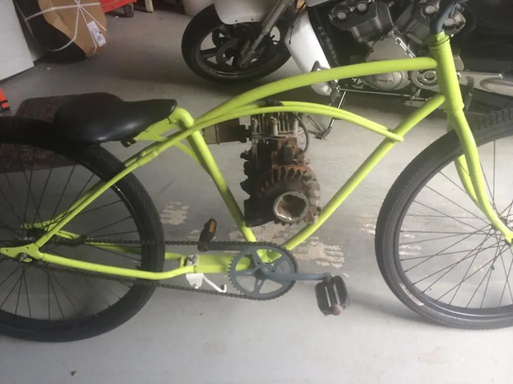

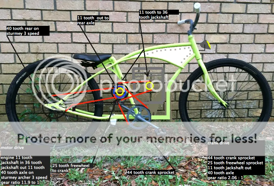

i am going to cut the down tub to fit the motor so it sits lower and more forward on the bike. i just sat it inside the frame just to get a look and this is the plan for my jackshaft set up and how I'm going to run everything.

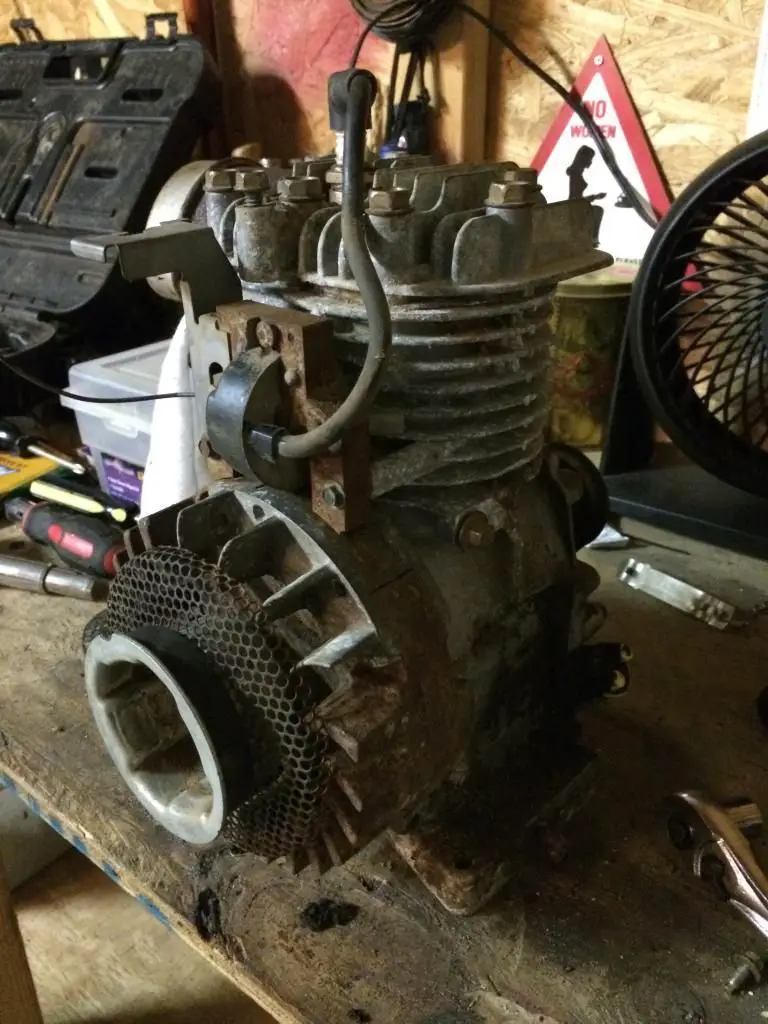

also going to be using a stormey archer front drum break. can anyone tell me how big of a problem it will be if i grind down my flywheel fins? will it throw my balance way off?
MotoMagz
Aug 2, 2010
1,817
1,154
Michigan
I broke off all the fins on a aluminum Gc160 flywheel. Then took a angle grinder to get em pretty close to flat. Next fired up engine ...let it spin at a slow speed then grab a file and press evenly against flywheel. This will get it smooth and even ..
gbginger
Apr 2, 2014
40
gulf Breeze florida
this is exactly how I'm going to do it! thanks

How Koool! You doing a good job,love the old Briggs builds. How about finding a old Schwinn or other brand ( Schwinn has the best curve )girls bike and taking the down tube and fitting it in yours would give you a lot more room for the motor..............Curt

If you tilt the motor forward, it will lower it considerably and fit without replacing the tube. I've been squeezing 5hp Briggs motors into stock frames for years. Although, the drop loop frame and upright engine has a more vintage look.

this motor has to be sitting upright. i just can't imagine it any other way. i don't see it being to big of a problem cutting the tube and bending it back to get the motor to sit just right

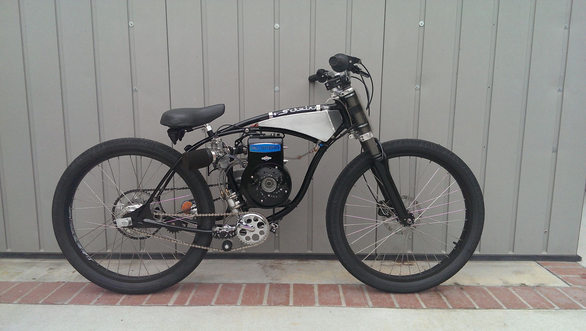

Here is a picture of my Briggs powered bike.
And when Andy say's "Briggs powered" here.......he's not joking as that thing is Unlimited Class material!!! That bike seriously rivals my 212cc build in every aspect and is top-notch in detailing. Not too mention 20+ HP Briggs!
Did I mention that already? :D
