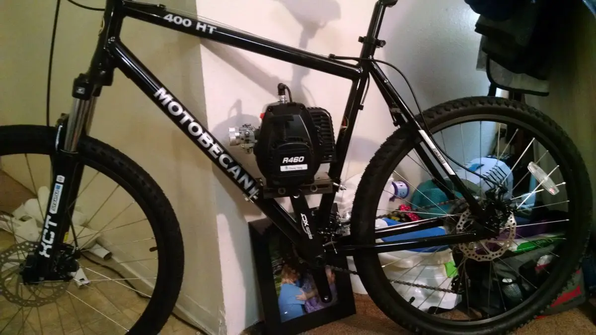

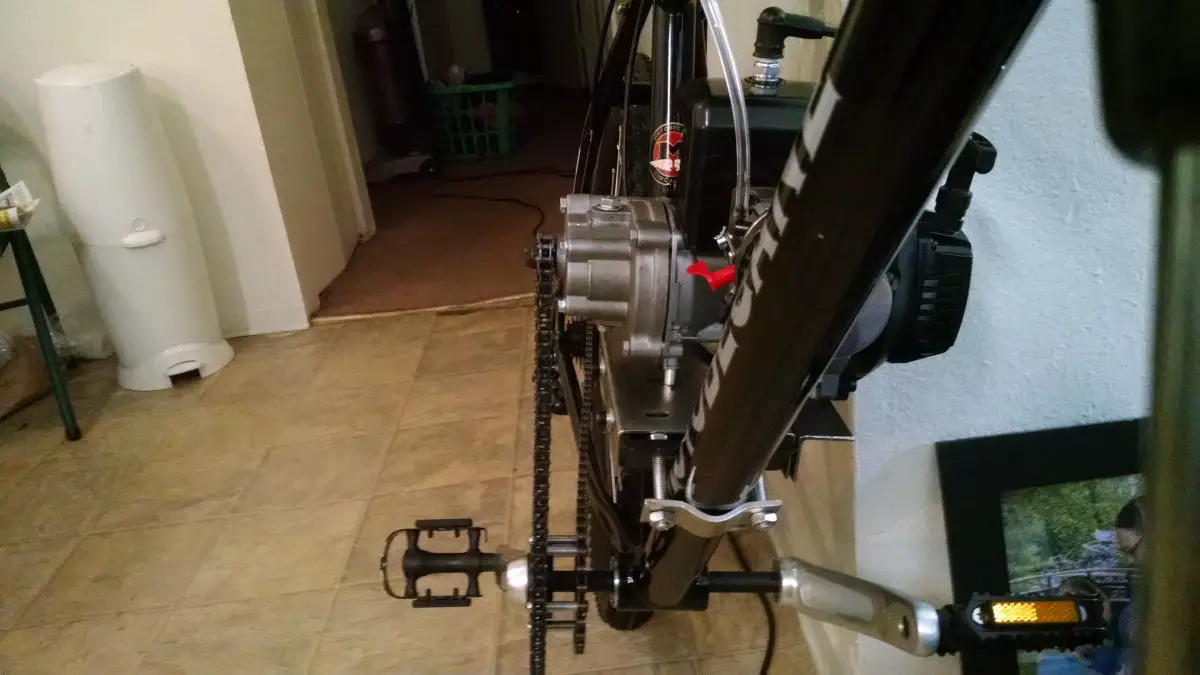

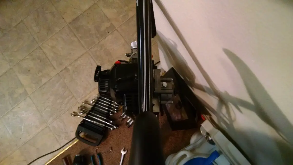

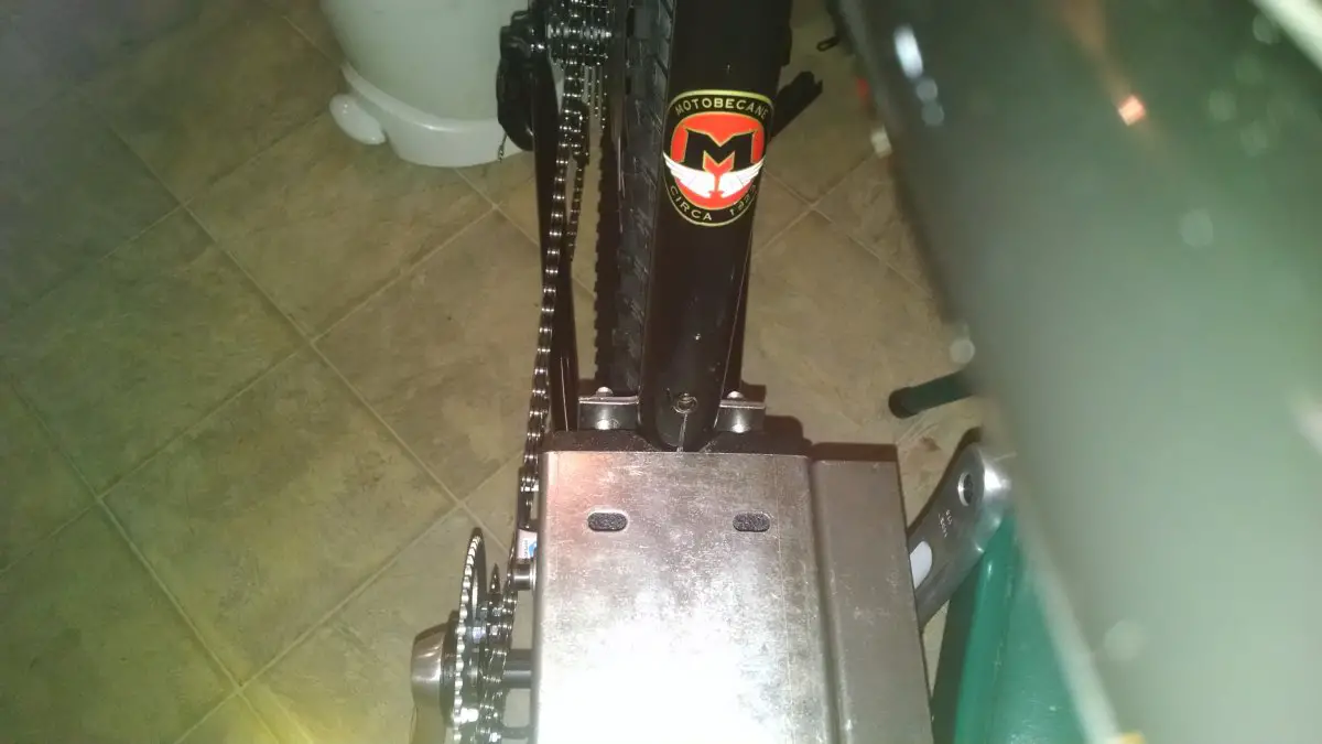

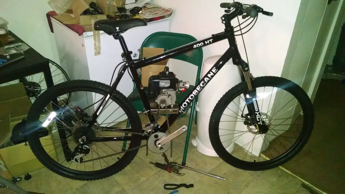

Well after some headaches acquiring appropriate hardware. I think I have sorted out the freewheel assembly. The 24t is spaced over an inch away from the 54t with some long m5 bolts and #10 spacers. It looks good.
But now that I'm this far I can see that the plate itself needs to come up a few mm's " handy adjustable mount " or just use some washers to take up the chain slack. The angle on the seat stay tube side of the HD mount needs a little work but the main downtube matches well. This is all coming together.
This one is with the sbp hardware installed and its not gonna jive.
I decided to use the left side 3spd shifter as a thumb throttle and leave the right as a is, since no one makes an 8spd triggershift for the left :,(
I hope the mounting of the motor goes well in the morning. I don't have the straight edge I'd like too, and my eye is only soo accurate lol.
I need to make the chain and mount the fuel tank, then I can run the new cable housing over the repurposed 3spd shifter/throttle cable and adjust it.

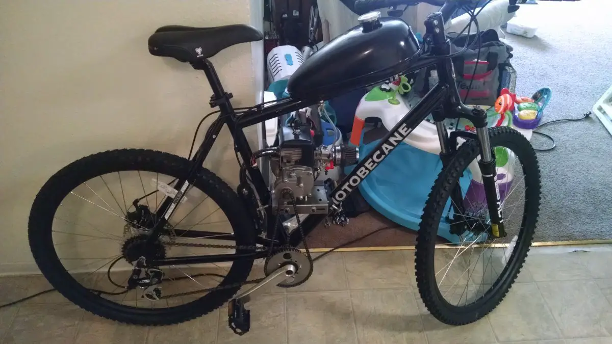

Thanks for your advise KC. I totally agree that it can't ratchet or lock. So I removed the latch and trigger completely, its now just a left side thumb throttle. I really can't believe how well it works and was so frickin easy! I also maintain the exact same look of the handlebars so I got that goin for me and that's nice.
dchevygod
May 23, 2014
54
6
Colorado springs
This is better
Now it functions thru all the gears but first, and I'll make a chain stay to keep the chain from falling off so 1st works.
