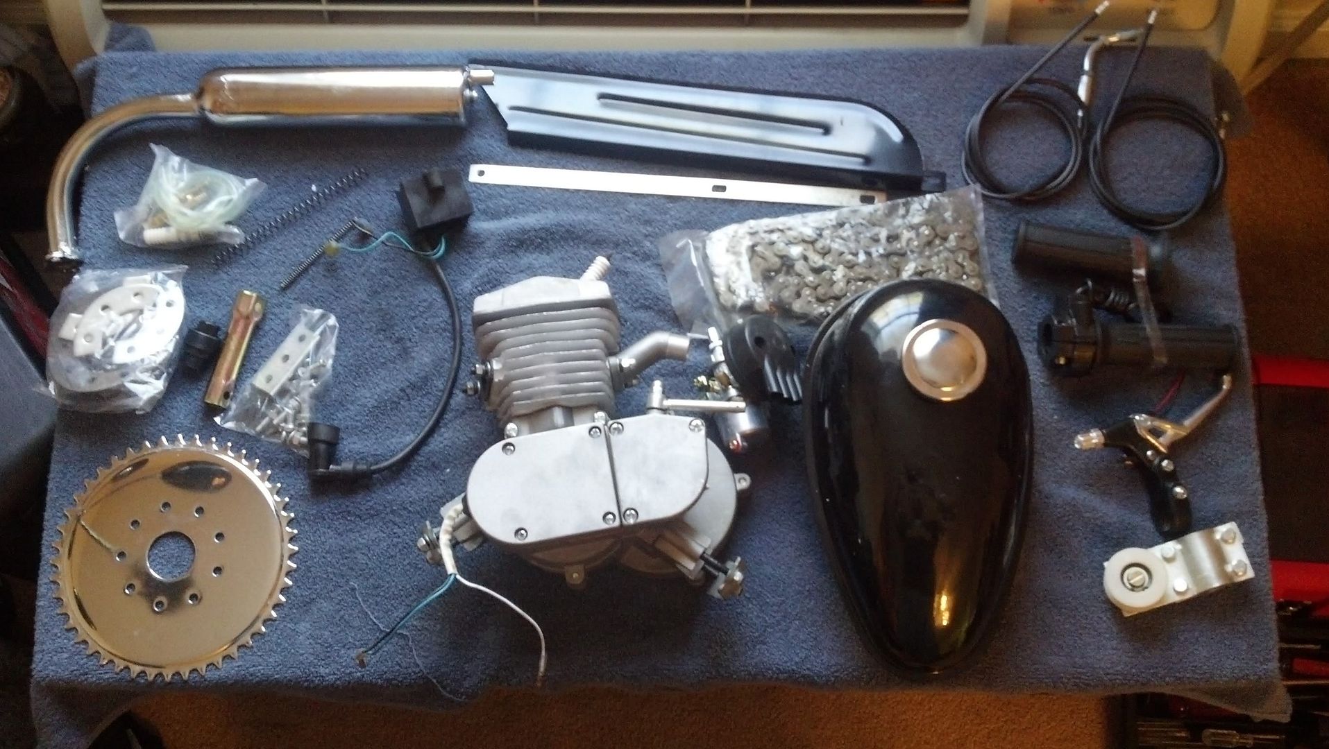

Everything that was inside the box

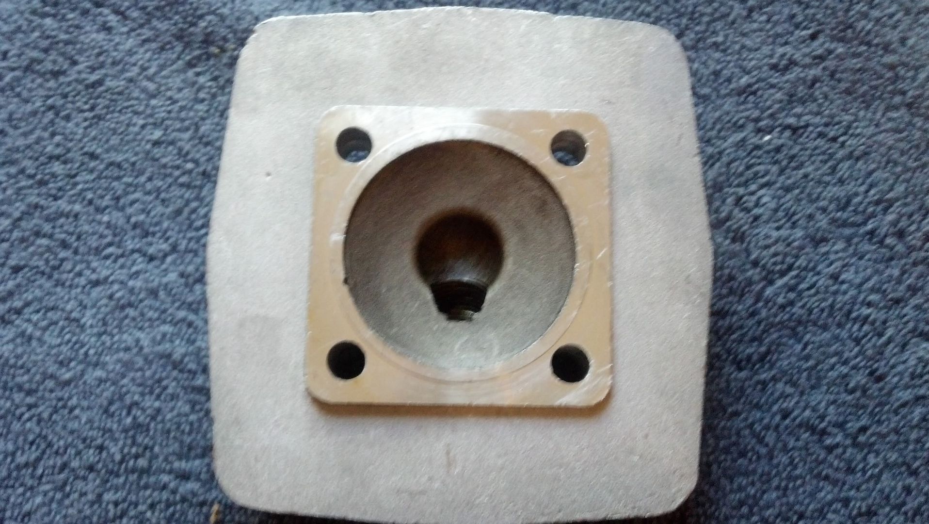

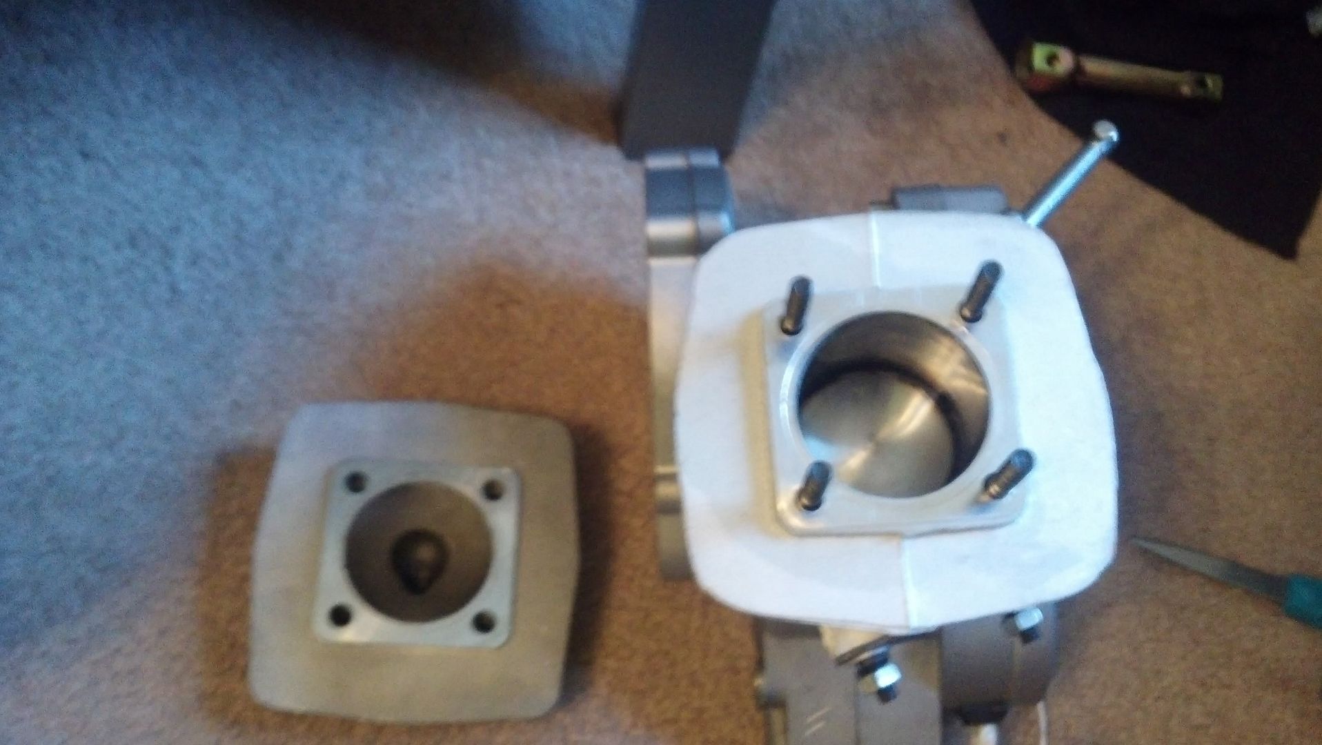

Rough dirty head

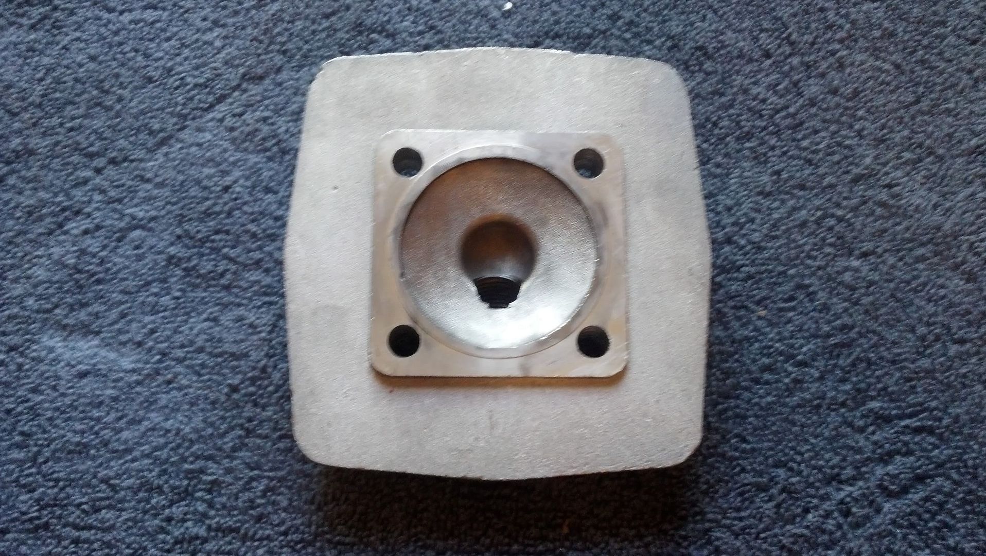

Smoothed out clean head

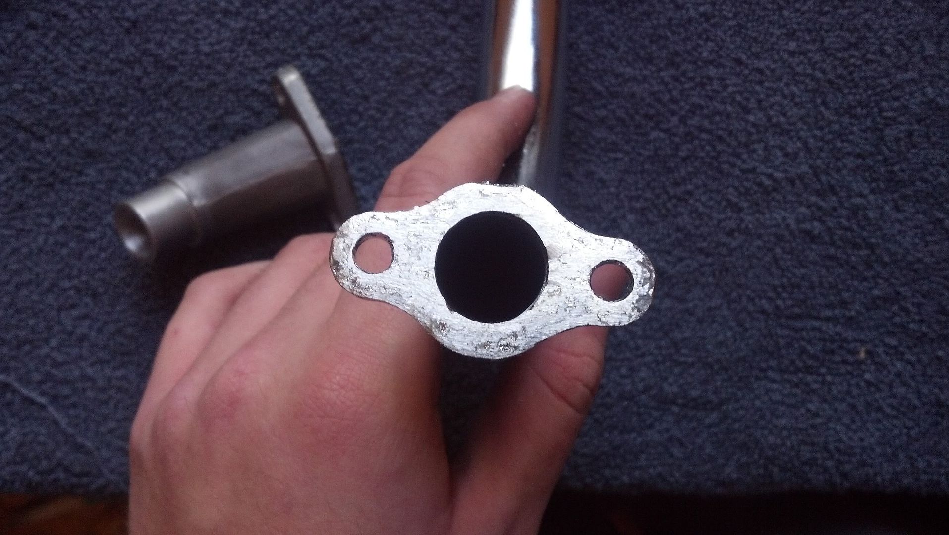

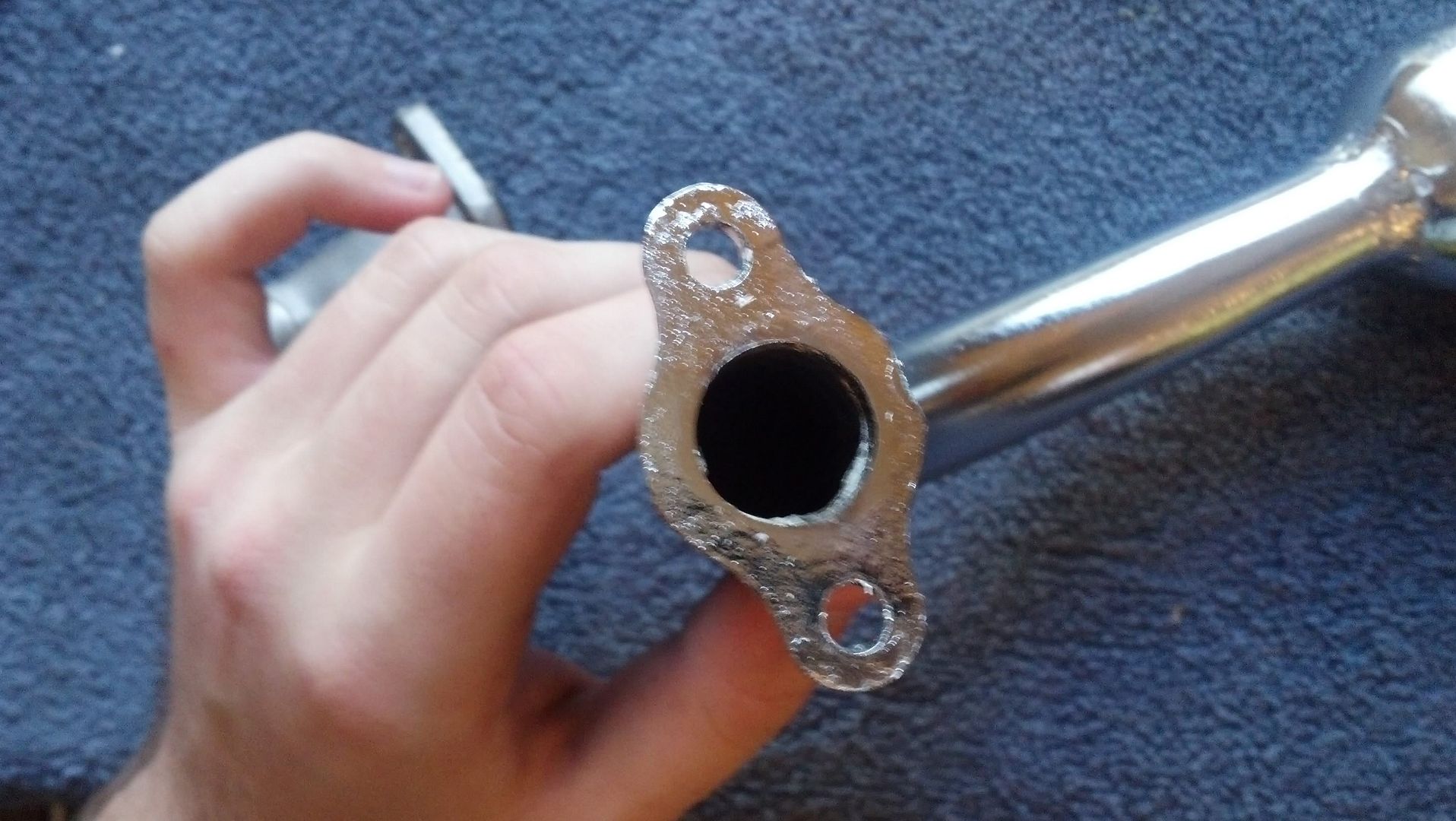

Janky Exhaust
Smoothed out exhaust

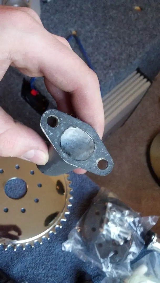

Forgot to take a before, but this is the intake manifold. It looked pretty rough

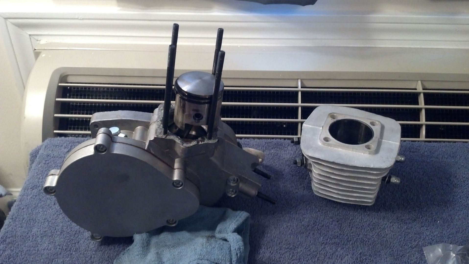

Then i got serious, I totally stopped taking pictures at this point but i took the cylinder or "jug" off to clean up All the casting burs and remove a little bit of metal out of the intake/exhaust ports. I also trimmed trimmed the gaskets and the piston (just a little, not enough) on the intake side to get a little better flow.

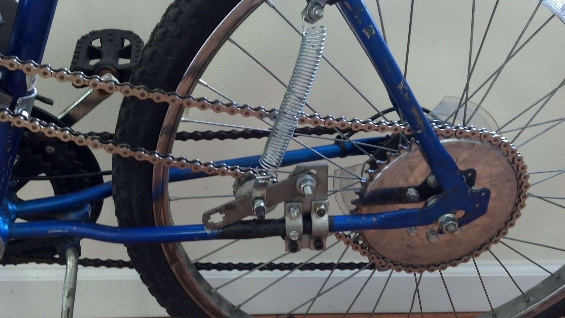

Well i fashioned up a tensioner and it still isnt keeping the chain on it. i cant get the idler pulley to be at the right angle so that the chain can roll over it smoothly. How do you guys adjust pulley angle? Ive moved the whole thing around just still having issues.

I have twisted them. With a vise, easy to over do it but can also be done with a couple of wrenches. Is amazingly weak metal so just a wee bit at a time.
The_Aleman
Jul 31, 2008
2,653
4
38
el People's Republik de Kalifornistan
Yup, like Dan said, a couple of wrenches will do it. I've used 2 crescent wrenches, opposed to eachother, to twist the idler bracket.
I've put over 3K miles on the stock idler with no trouble. Key thing is getting the chain to track true and don't overtighten the chain.

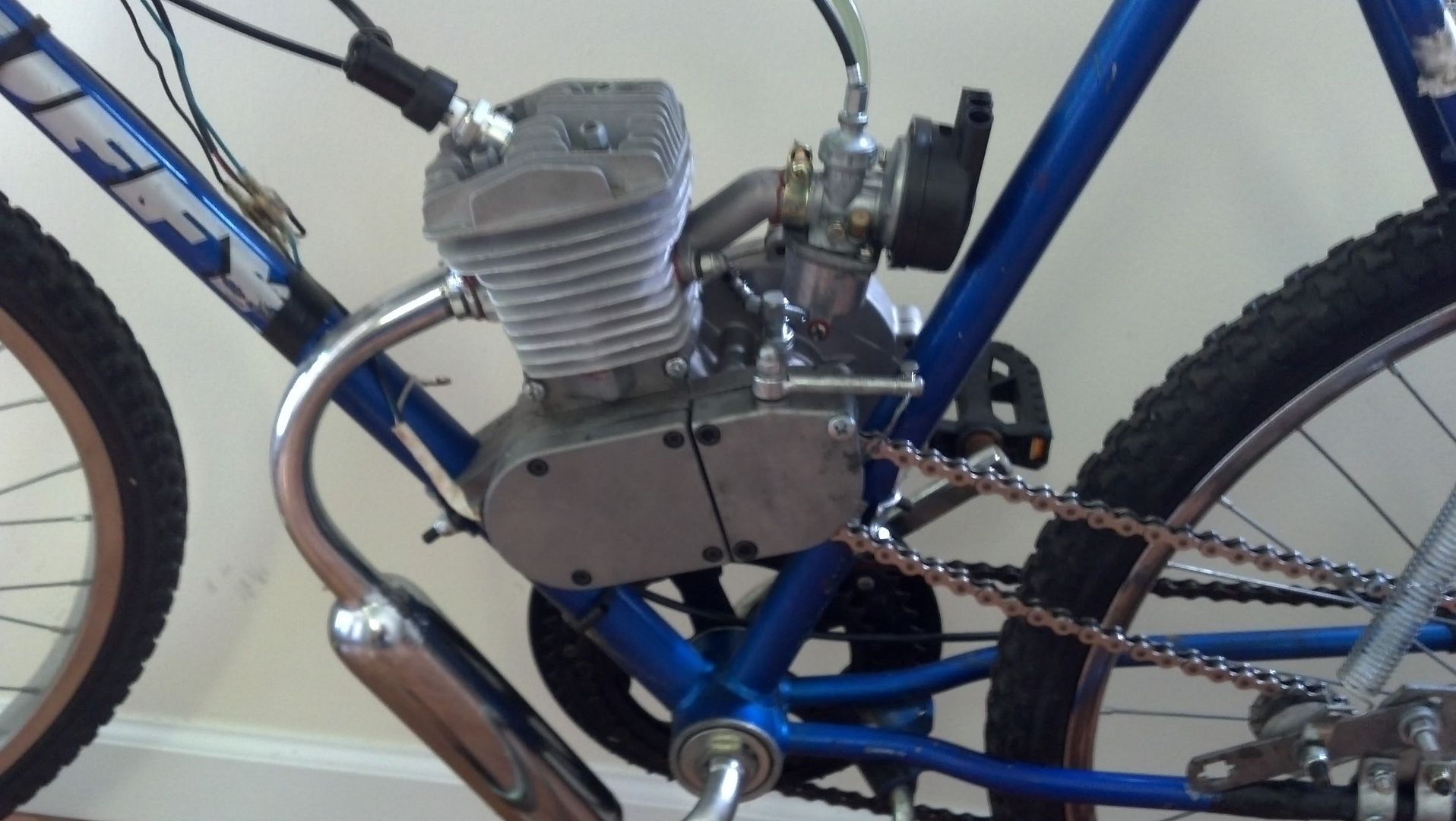

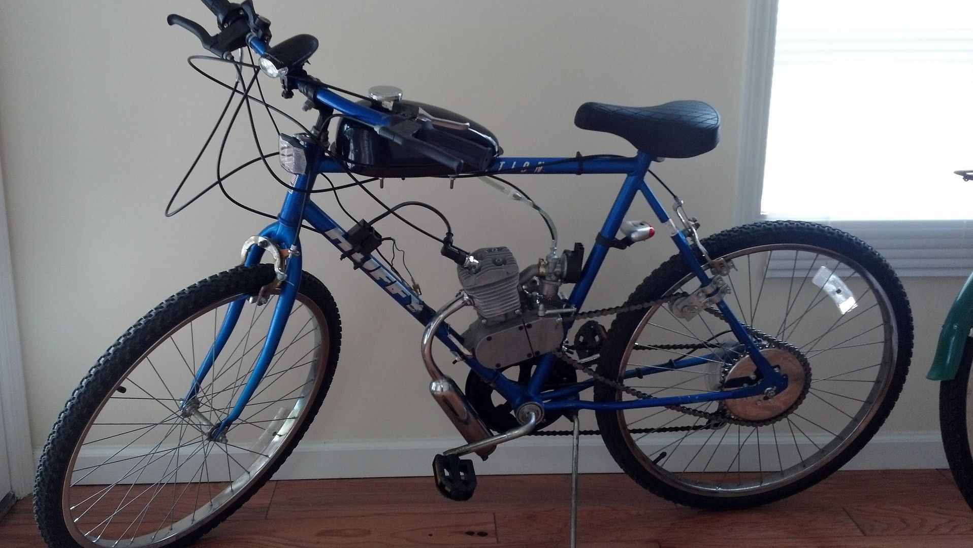

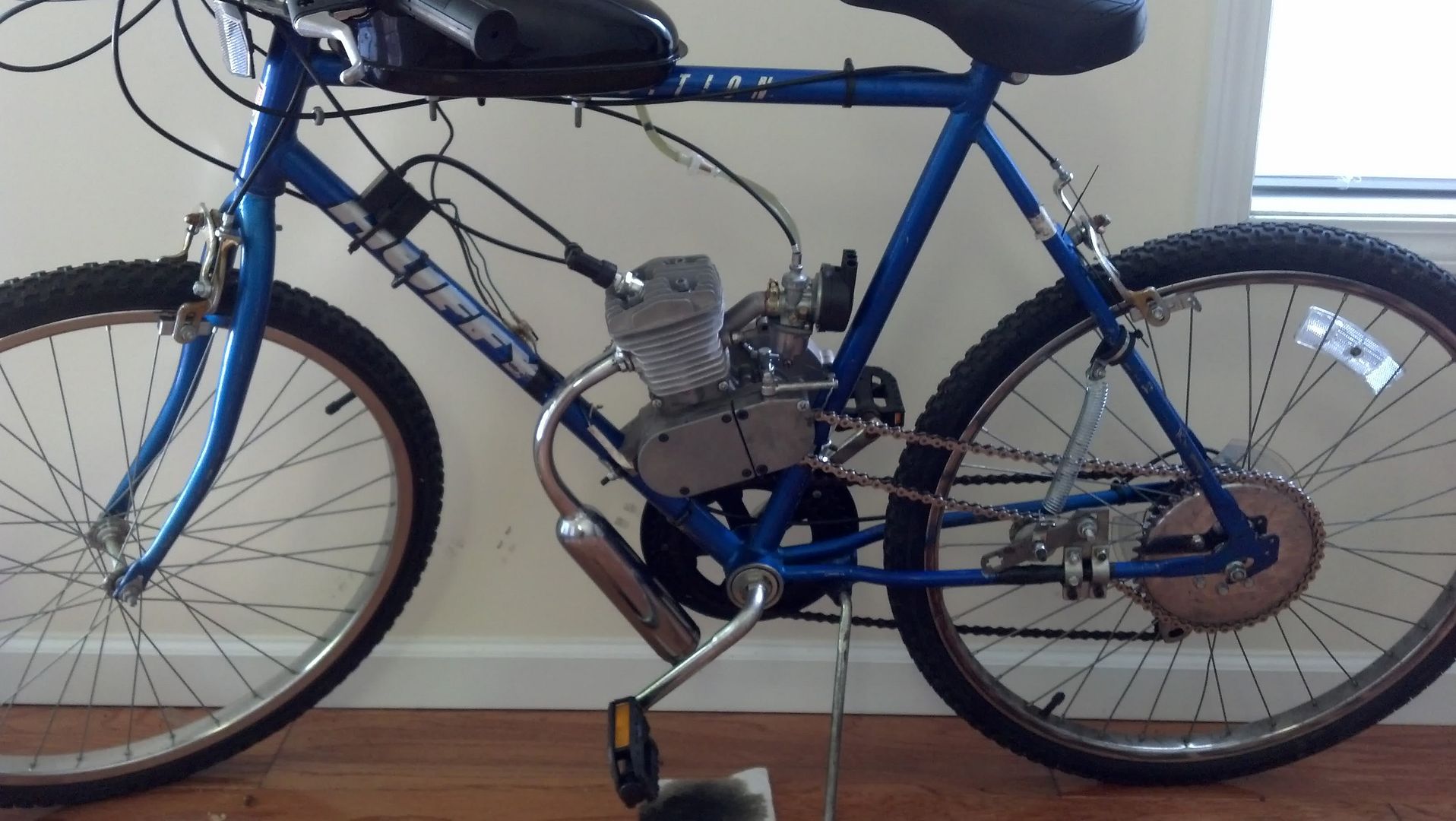

Well the bike was down for about a week but i have been working on it and i finally got it running right. The carb wasnt in the right notch on the pin so i changed that and it made a world of difference in power. I also got the tensioner straitened out and im fairly happy with it, but it still just needs a few adjustments. I have an awful chain slap problem at high speeds but im pretty sure im about to fix that.
Here are a few pictures
Over all i am very happy with the bike right now.

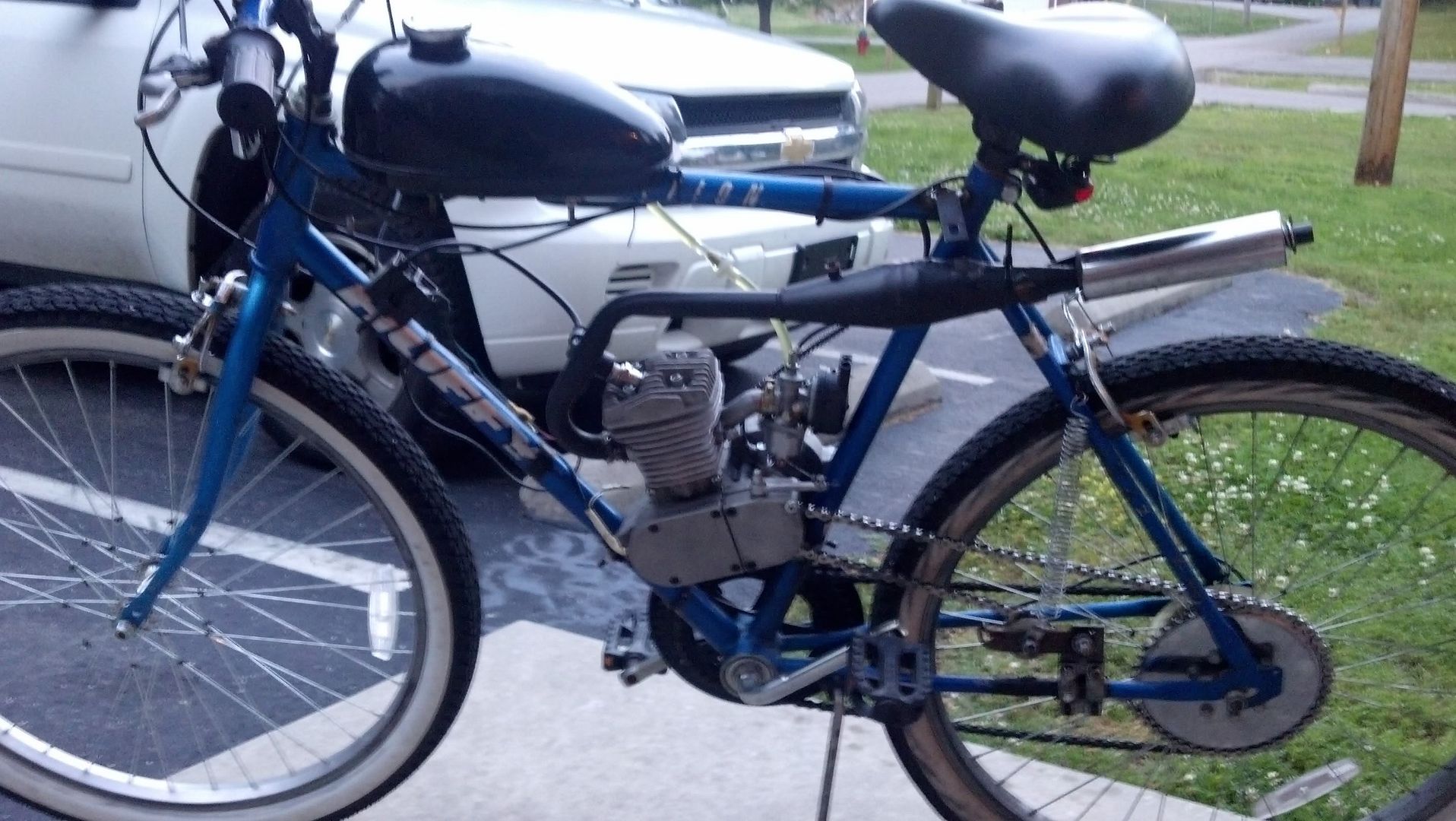

I got some goodies in the mail!
This is a modified mini pocket bike exhaust that i had an exhaust shot cut and reweld. Its only a little louder but it sounds pretty good i think.
I have one more upgrade but it will be a couple days before i get that straitened out :)
