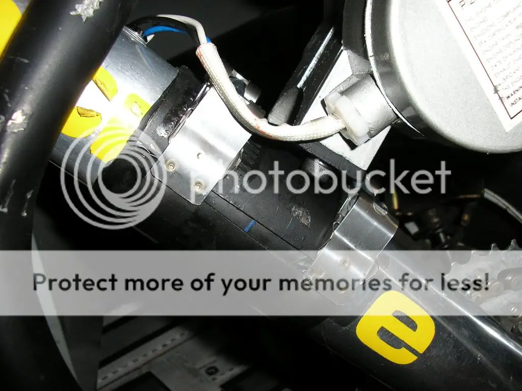

i would guess you are going to have to fab a frt mount. do you have access to a welder? it's 420 in the morning when i wake up later i will take a pic of my frt mount its really easy to make and is solid. you got me interested in buying one now.

heres that mount. i roll a tube that the id is the same as the od of the downtube cut it in two weld the mount tab to it then clamp it to the frame with industrial nut clamps not the cheesy regular hose clamps. solid!!
