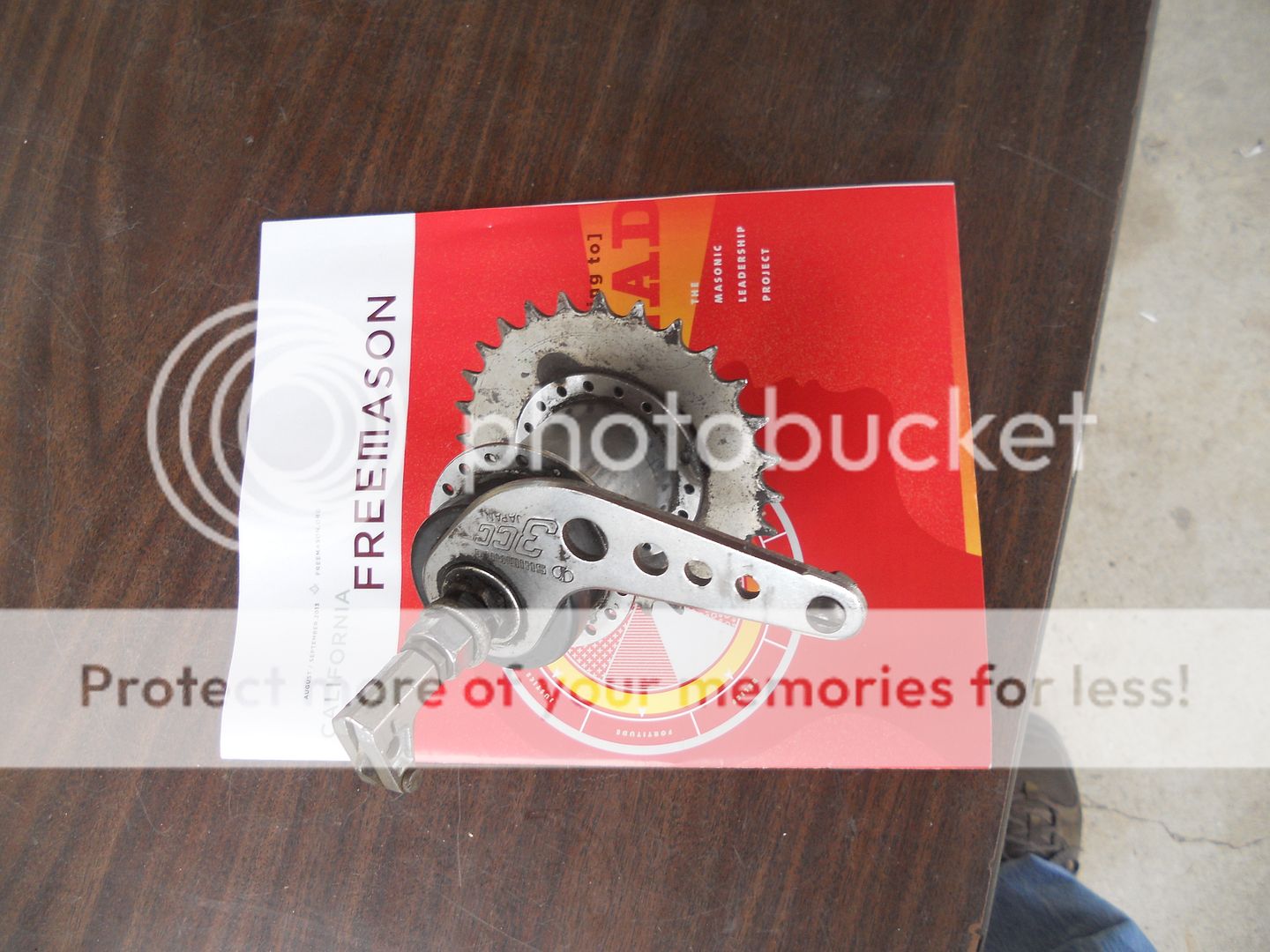

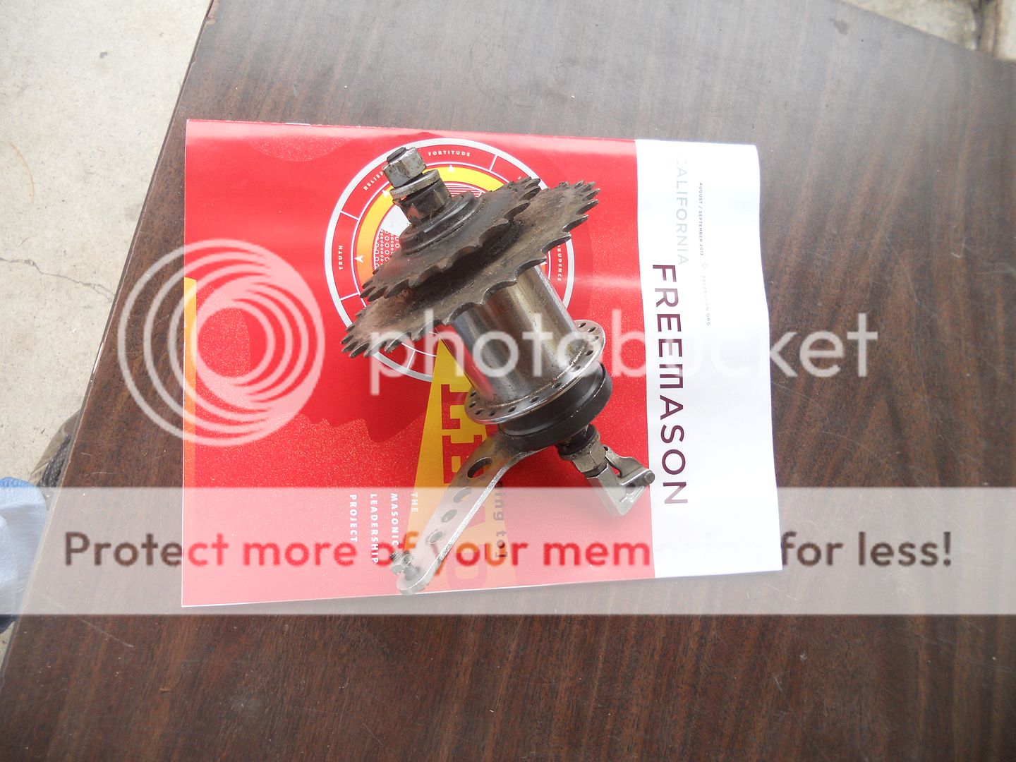

SB, I just found this one so far. I guess any heavy duty 3 speed coaster brake hub would work with a sprocket welded to the spoke flange. Let me know if you want it.
