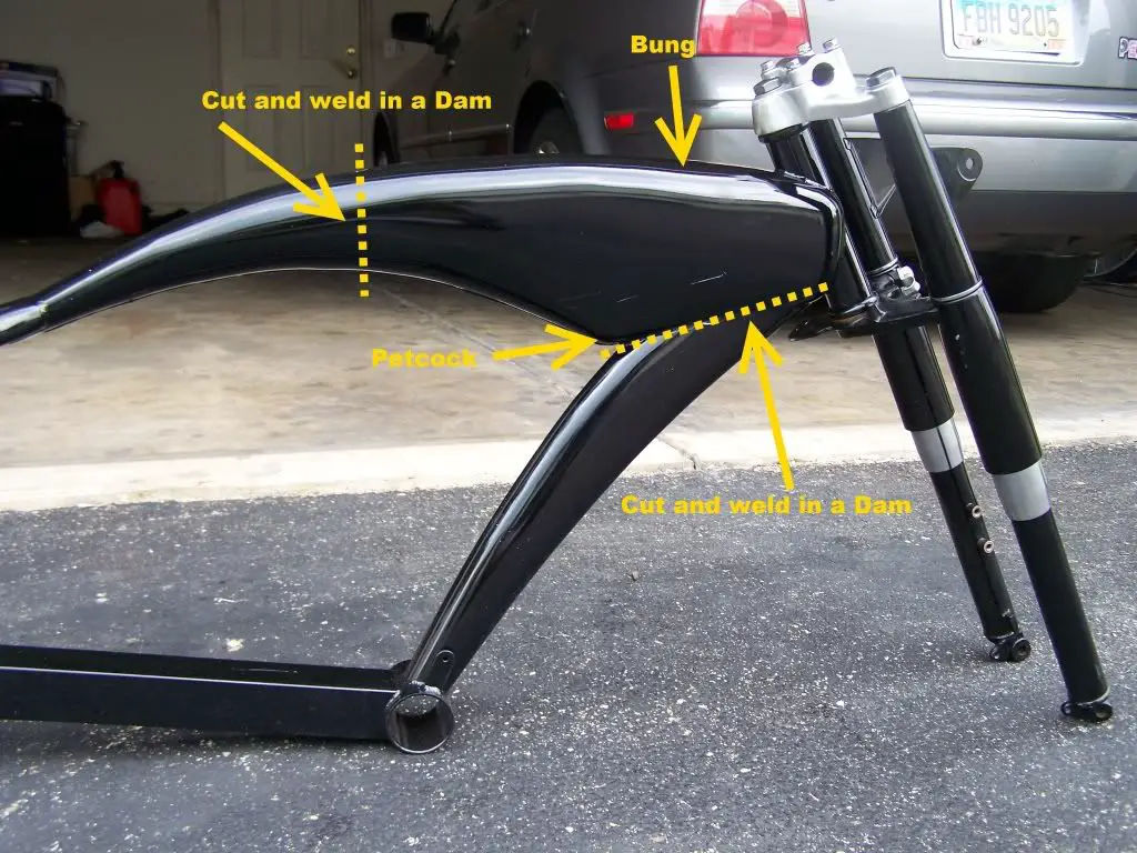

I posted the huge images to get a better look at the quality. Over all it is a decent frame but there is no tubed back bone or down tube per say it uses the stamped steel tank and front gusset in place of them. It looks like an easy frame to mod though for a gas engine and have an on board tank...
The Suzuki K10 forks fit like a glove but there will have to be some minor mods done before I am happy. I just cant wait to get the 1965 17x2.25" K10 front hub, rim and drum brake for it (suppose to be here on Saturday) and see how it sits with a 26" CBE-110 rear hub and rim...
Questions and suggestions will be appreciated for this one... I am still debating if I want to make it a 2 or 4 cycle...

I think you might be able to get away without cutting & welding in dams.
Just figure out what filler you will use & after you drill the hole for it, you will be able to see inside, & maybe it will be easy enough to seal without the dams?? ;)

That frame will make a sweet tank. I concur with Venice it will prolly be possible with no welding. Gonna be a nice ride!dnut

Venice I think it is open into the front where the down tube would normally be and it will have do darn sure have a dam there but it would be near impossible to do without splitting it on another axis.
My thought is to make the dams at both junctions out of something like 3/8" to allow a running pas to loin the pieces of the tank together and then a small fill pass to smooth it out. The thing I dont want is for it to separate and I am a real tweek for strengthening things...
My point is when you drill the hole & look inside, you'll know for sure.
On most every bike that I've done the 'in frame' tanks on, there is only a very fine open 'seam' where the down tube meets the steerer tube... (& thats easy to seal!) ;)

Thanks Venice and I will be doing exploratory surgery tomorrow to see what is what and where is where with this frame... One good thing is that I do have a USB fiber optic mini cam that was great for top end inspection when I was still wrenchin seriously that I haven't got to use for a while and don't have to be really destructive (darn it).... SCALPEL PLEASE NURSE..
Good point though we will see what we will see.

I agree with Norm, drill the hole first and see what you have. I have never sealed up a tank like that but Norm has. Cutting and welding in dams would be a lot of work. Cool looking frame!

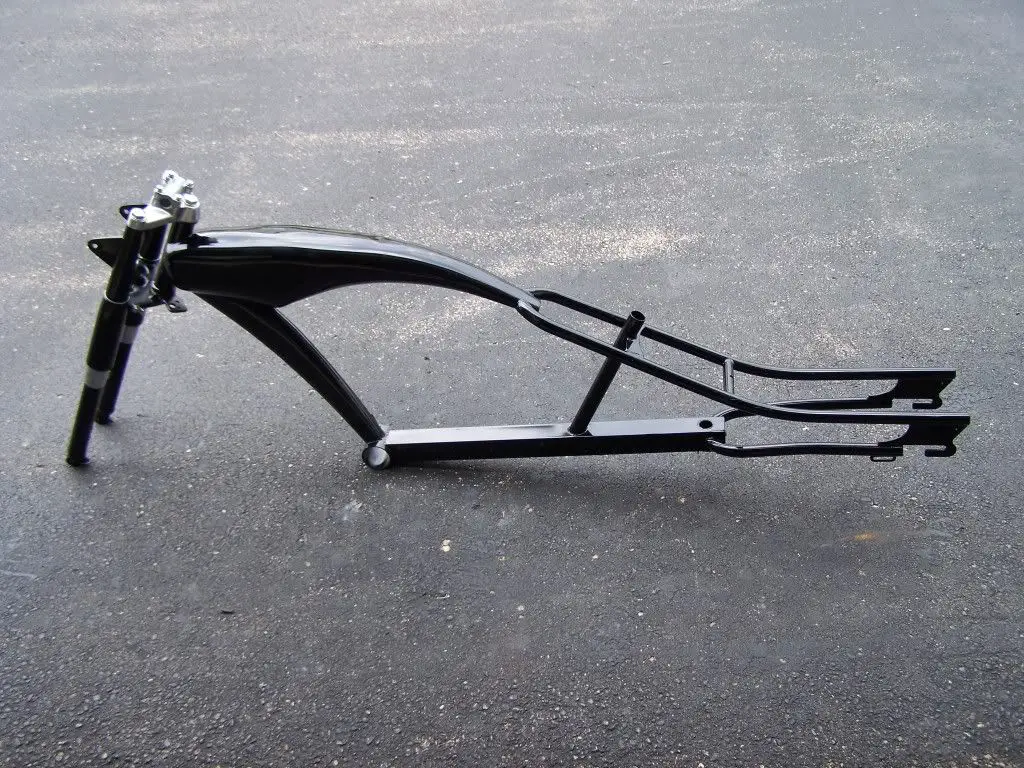

OK I havent updated this thread in a while have been really busy with other stuff.
I got my inspection cam out and for some reason it is not working so I have a call into Snap On about getting it repaired so I have not got a firm plan for modding the tank yet.
I finally got the original 1965 Suzuki front rim and tire in today so I took a break from the real world and mounted it up on the K10 forks. Unfortunately the axle bolt is 3/4" short from extending past the forks but the supplier of the wheel is sending me the proper one. It is actually a 17x2.50 tire and I like the looks of it with the 26" rear rim and there is plenty of room for chain clearance to run at least a 2.50" or maybe even bigger rear tire.
One thing I wasn't prepared for is the amount of S T R E T C H!!! Gads is that thing long...
Oh images are 800x600 click to see larger view.
More to come...
