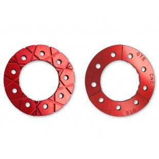

When you say pineapple adapter, do you mean a real pineapple adapter:
Or a rag joint (the one that comes with the kit):

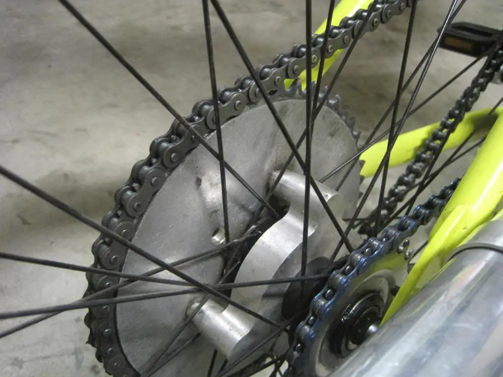

I will never use one of the rag joints or pineapple kits again. I bought a sprocket adapter from Phantom Bikes and absolutely love it (and I also got my dad one, we have had no problems). It drives the wheel from the hub rather than the spokes, which can prevent some VERY nasty wheel failures down the road.

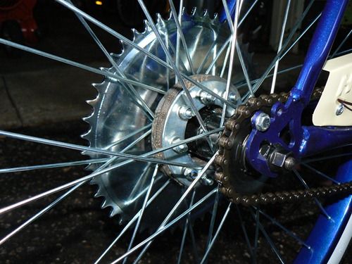

Here are some pics of the one they sell on my bike (sorry for the dirt :))
Hope I helped, and ride safe!
