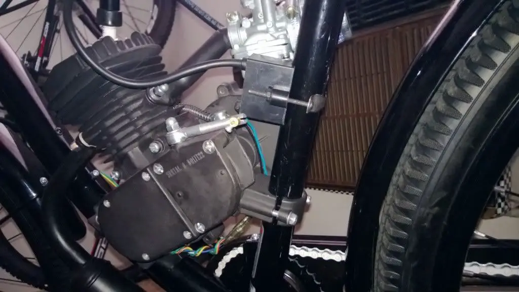

MOUNTS:

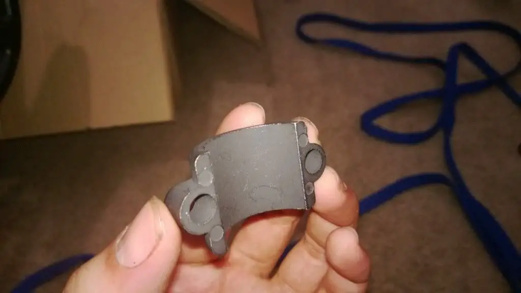

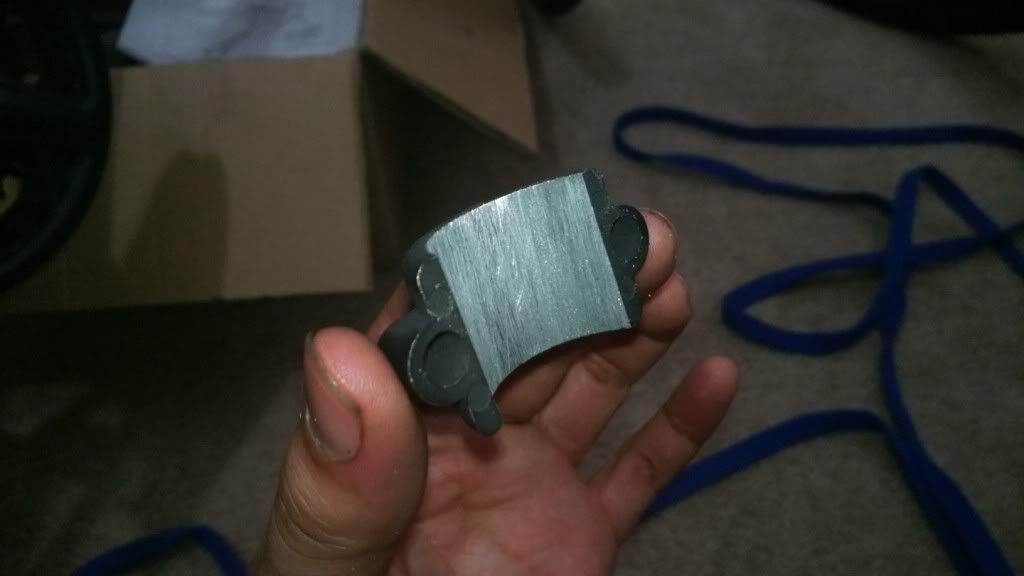

The rear mount should have been an easy fit but the bracket for it was a little too small in diameter, so to overcome this I filed the inside with a round file until it fit snugly.
this is just an example of where to file, I didn't wanna un-mount it just to show you.

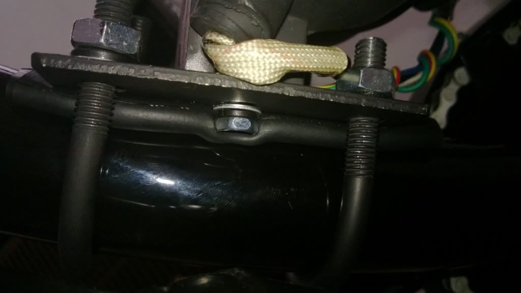

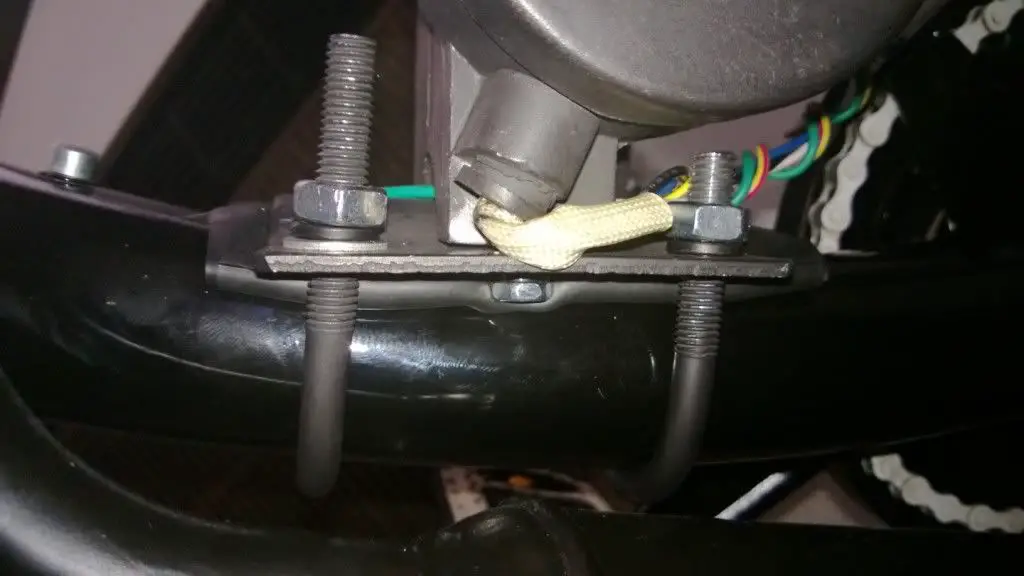

The bottom large adapter 15$ extra and it worked ok. The first thing I did was remove the bolts that go into the bottom of the engine completely. After cleaning off the bottom, I attached the supplied "large frame adapter" plate to the bottom of the motor where I removed the bolts. I used 2 hex-bolts found in the Grubee skyhawk kit to do this. I don't remember what they were initially for but I ended up not needing them. After securing the plate to the motor with the 1" hex bolts I cut out 4 rectangles of old tire tube to fit the plate. and fit them under the plate as shown.
After I fit everything together i realized there was one problem, the u-bolts for the large frame adapter were a bit too long in one case, and I had to cut off about 3/4 of an inch to make it clear the engine itself.

After all those minor mods, it fit together well.

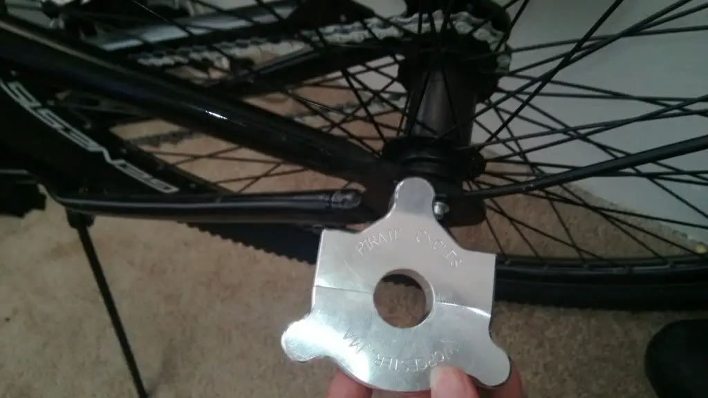

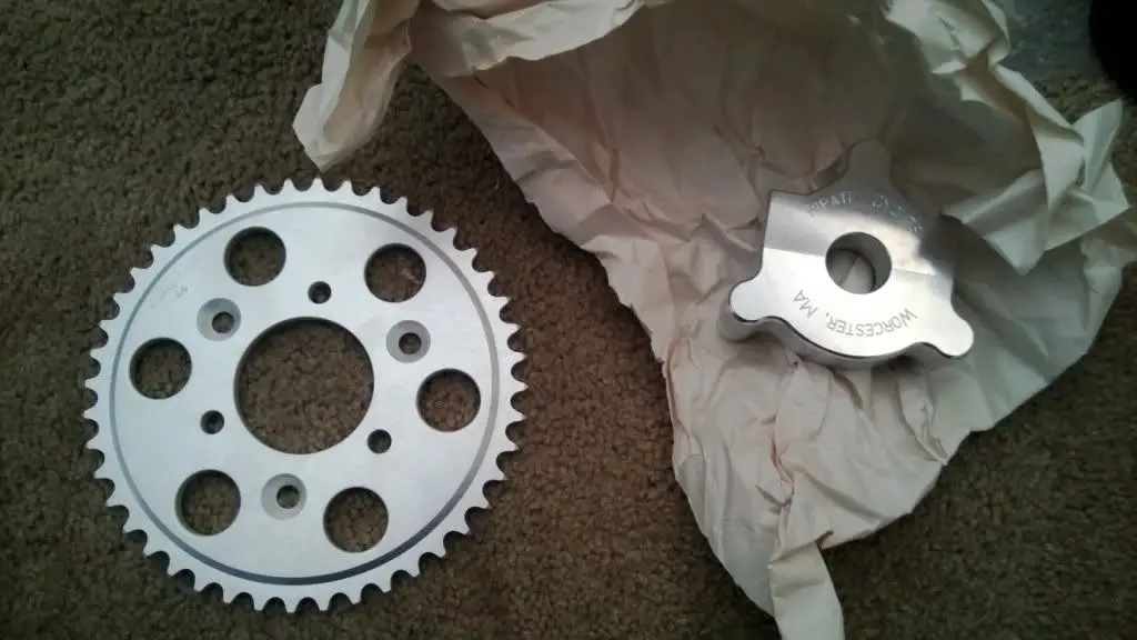

The Pirate Adapter
As advertised, The site says 1.003-1.008" fits the Walmart big 29er (THIS SHOULD BE WHERE THEY SHOULD HAVE WROTE MOUNTAIN BIKE)as well as the alloy 567 FW
Look, It would require re-bore' ing at a machine shop to be precise enough to fit on the hub.

The first pic looks almost the right size for your axle hub.

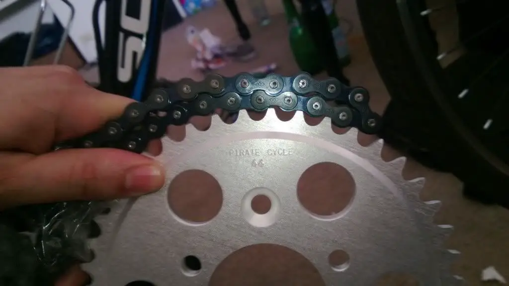

What size chain do you have, a 415? I can't see them machining the wrong tooth pitch.
Get your self a vernier caliper and measure your axle hub and send it back and get another one, someday.
Or get a wheel that will work, boy that is one small hub that fits on eh?

The KMC 415Heavy Duty BMX chain is what you want:
This is a bad price (shipping cost extortion), go to your bicycle shop, or look elswhere on ebay, just showing what the box looks like, you may need two as one is a tad short, this chain destroys chainbreakers.

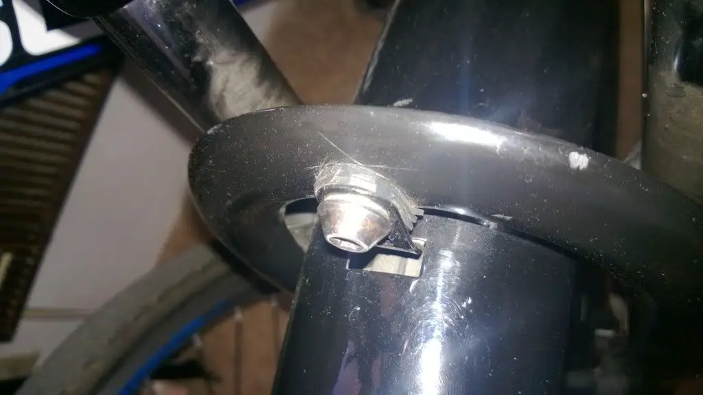

I ended up putting in old flat rubber tire shims in everything I could, from the bolts that hold on the fenders all the way to the large frame adapter itself here is an example of the front fender mount.

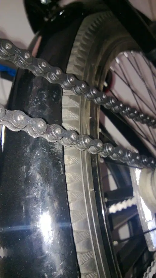

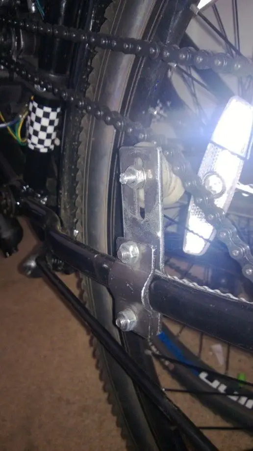

A minor bend was required for the back fender because initially the chain rubbed against it. If you look closely you can see some of the initial wear.
The chain tensioner couldn't be lined up perfectly but the straightest configuration I found looked like this.

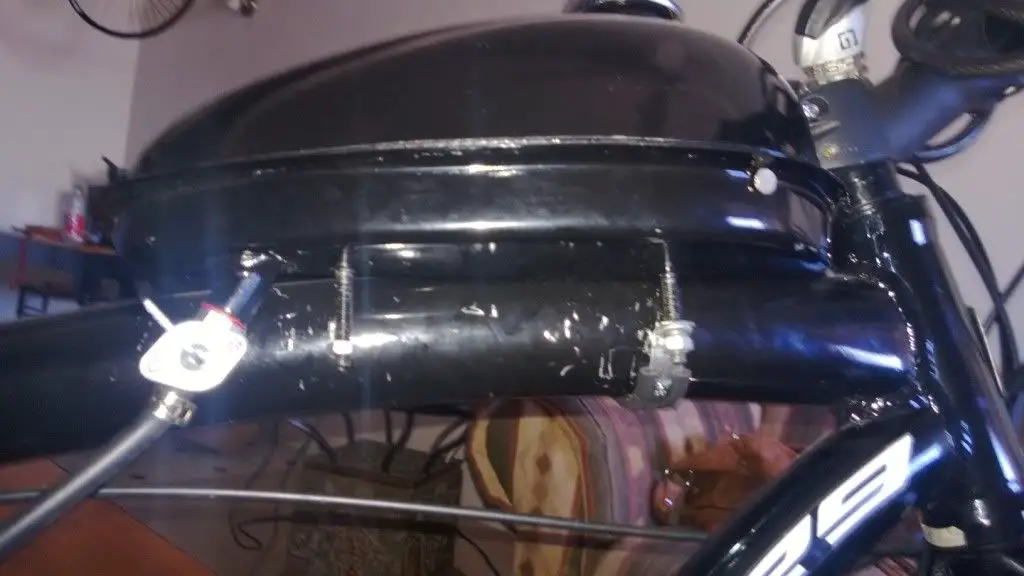

As for the gas tank A ghetto job was done by me. I just grabbed some pipe mounts and screwed em on and hoped for the best. it seems to work though. there hasn't been any slippage.

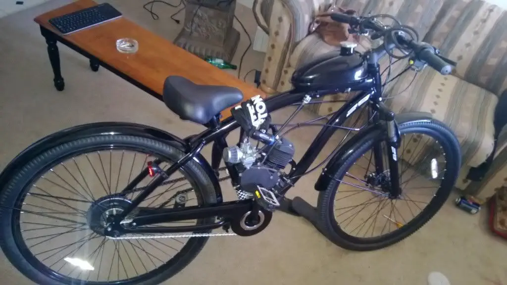

So the bike is finished and this is what it looks like.

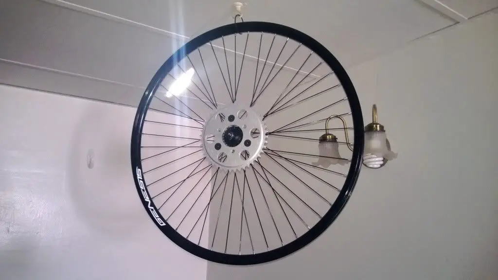

And as for that pirate adapter? I guess it will make an ok wall piece.
