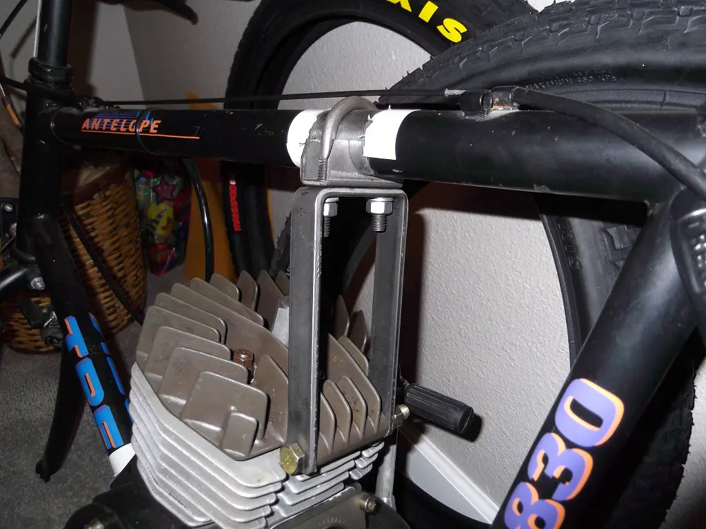

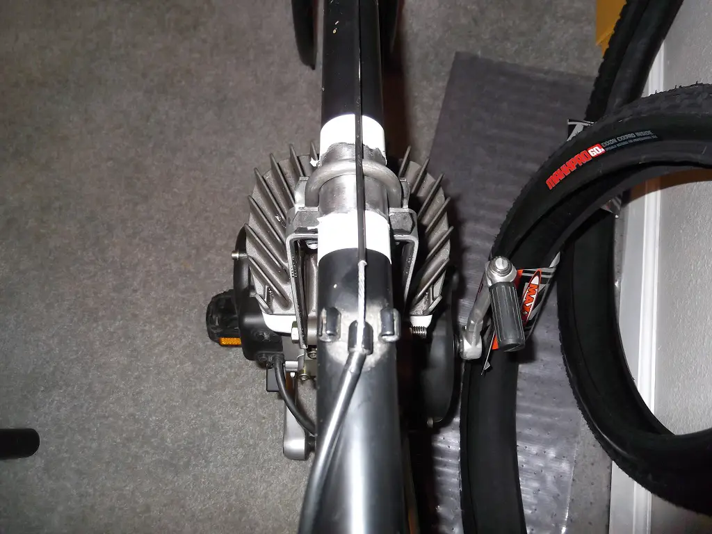

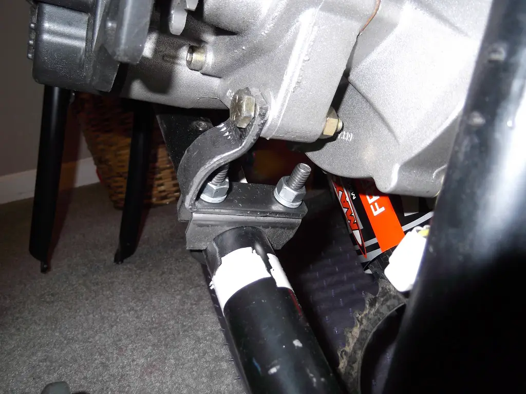

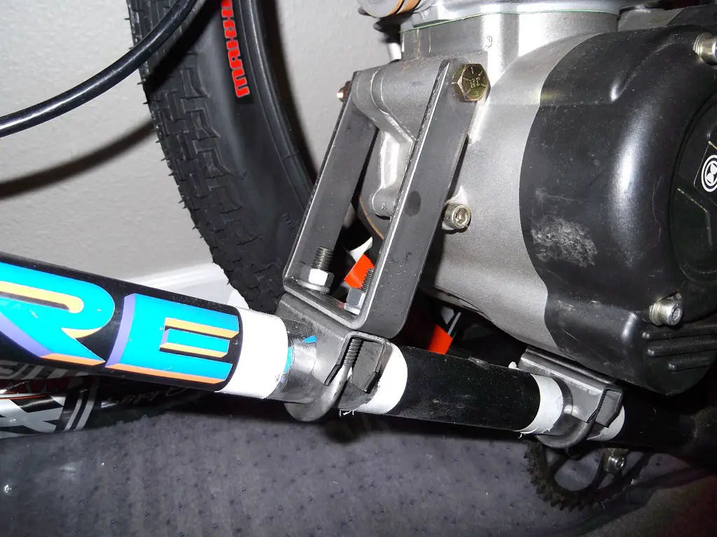

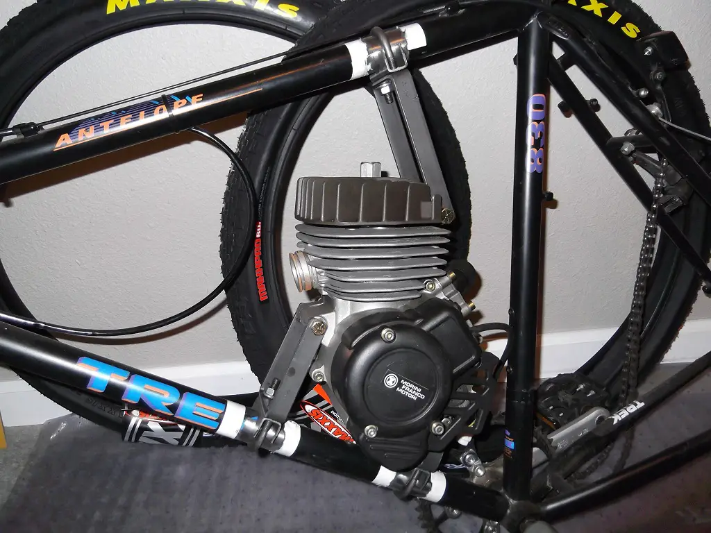

Hi all!
I have sold my first build and now I am starting on my next kick _ss build. I have purchased a Morini S6-S motor, had it bored out, and re-sleeved. Then sent to me. I am told that the motor will be producing 12+ hp with no port work! When I positioned the motor on the bike, I choose that the bike cranks do not have priority on the placement of the motor. The motor sets nice in the frame with the exhaust system in place. I choose to make three motor mounts out of 3/16" plate steel. To hold these motor mounts in place, I am using 1 and 1/8" U-bolts that will be welded to the metal frame. I have positoned the engine dead center on the frame.
Here's a couple pics of the build. As I move further in the build, I will post more pics.

Is there another rear engine mount just under the carb? If so, I would attach a forth mount to the seat tube.
The motor does have four mounts on it. I wasn't sure if it would be necessary to have four engine mounts that where welded to the frame? I thought three welded mounts would do the trick.

All I'm saying is those Italian engineers have 4 mounts there for a reason. If it didn’t need it, it wouldn’t be there.
I have thought about this a few times. I think it is coincidental to different motorcycle manufacture arrangements dunno? My bike got's just one of those used the bottom one ,the jug bolt last the front bolt and has worked perfectly. Solid as rock no bolts have ever vibrated loose or anything.

At least you have plenty of room to do that. Most bikes are really no good for a Morini mount due to the center exhaust port but that bike has lots of room.

I run three welded mounts with zero issue on a S6-S although the thickest pieces of steel on the entire bike are the mounts.
