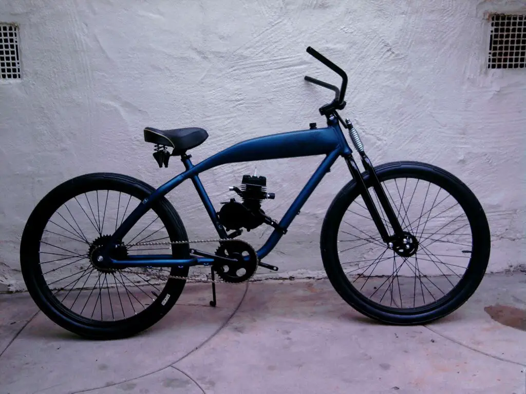

I'm now building my dream bike... a Felt Slater!
This bike is new from the box. ;)
I'm finished with the 'in frame' tank & I'll be starting on the rest of the build in a few days... I'll post more pics as it happens.

All I can say is "it's gonna be a beauty!" Love that frame, love that fork and blue is my favorite color....what else can I say? Can't wait to see the finished build....have fun!

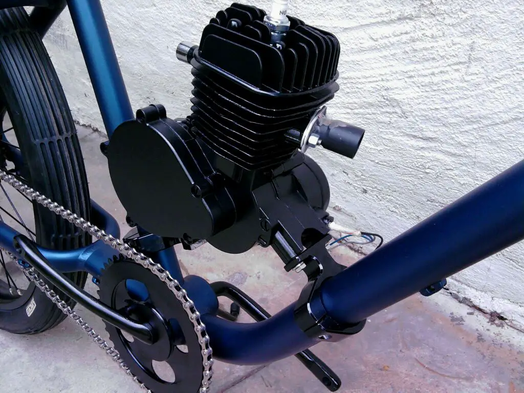

Here's a little update for today...
I just got the engine painted & installed today using those Ampt mounts... Here's a few new pics.

Ive seen this bike in person and she's gonna be sweet....The black tires/wheels and engine really set the blue paint off and the "in-frame" tank is HUGE!!

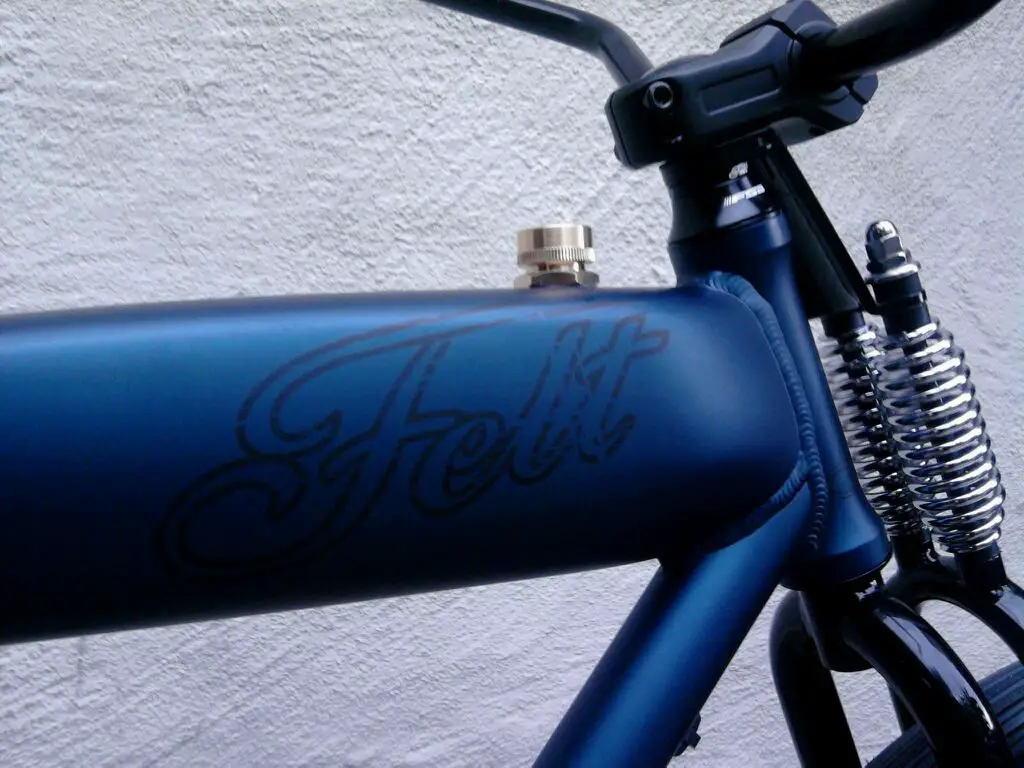

That's a very nice bike.
How do you seal the tank inside the frame?
There are many threads on making these tanks,; just search around... My new way of making them is different & a patented design. (very quick & easy.) ;)

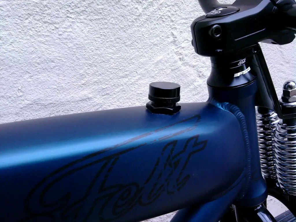

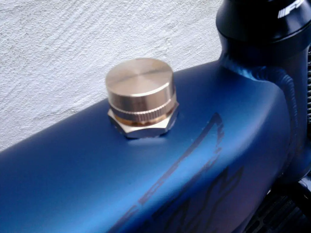

How are you venting your gas cap? Also are you planning on keeping the 3 speed the bike comes with and go with a jackshaft or change it up? Thanks for any advice. I just bought a Felt that I'm planning to convert and any help would be appreciated.
The cap is vented by drilling a tiny #71 hole in it.
I swapped out the rear wheel for a wide Felt wheel with a Shimano coaster hub in it & I have a sprocket bolted to it.
SBP shift kits are nice, but it's really hard to use on a Felt because of the custom engine mounts needed.
Is a hole that small big enough for a vent? I drilled about a 1/4" hole in mine for the vent.
Yep, thats all it needs! That's the size of the carb jet, & the tank can't drain any faster than the gas can flow through the jet. ;)
