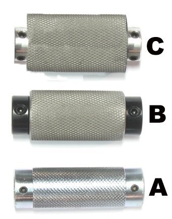

My 1.25 Friction drive roller is about shot/worn out so I threw on the 1 inch extra roller that came with my kit. It slowed my bike down to max speed of 25mph. and it sounds like I'm riding on the interstate in a car in 3rd gear. My muffler also is getting very hot driving under normal conditions (15-20mph). I was just wondering if anyone has ever blown an engine from having it undergeared or using a 1" friction roller? I've got a harbor freight 52cc waterpump engine. Playing it better to be safe than sorry. Anyone know or have experience? Thanks,

The change in spindle size is in effect a gearing change like changing the rear sprocket size on a chain drive. The smaller spindle will give more hill climbing or may be better for a heavier rider but will offer less top speed. If you rev the engine higher to get the same top speed or feel you had with the larger spindle, you're likely winding it out at the higher rpm range for the engine. Sounds like you'll have to choose between a lower top speed or replacing the 1.25" spindle.

The 1.25 roller size is excellent for Florida Flat ground with the engine I have. I made a new roller out of wood, but not having success mating it up to shaft collars to mount to clutch bell drum shaft.

Yesterday I bought some sanding screen from the hardware store and rolled it around the 1" roller and then zippy tied the ends of it to increase the diameter of the 1" roller and give it some bite. It didn't work.....................

Today I bought some athletic fabric tape and increased the diameter of the 1" roller to about 1.25" It worked well for a short while and the engine sounded like it should cruising with the larger roller, however the fabric tape melted and it didn't work out.
The 1.25" roller I had got shot on my thatsdax kit. I was jumping around from bonefish flat-to-bonefish flat in the florida keys on it, and the coral rock that makes up the Florida keys took its toll on the roller. The coral ate the metal roller and made it smooth.
I've got another 1.25 roller on my BMP kit, but it will not fit the thatsdax kit. I think I'm going to do an engine channel swap, but my BMP clutch bell drum makes noise.....
