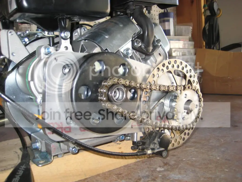

Jackshaft, bought clutch,shaft , gears and collar form Agk, made jackshaft plate and hub. I have mounted a disk brake and Calliper to the jackshaft plate, I hope this works!

I sanded the crank shaft for about 45 minutes and now the clutch
slides right on. I need 1 more mini hub to mount the rear 22 tooth sprocket
to finish up the jackshaft and it looks like my brake setup will work.
The lower half of the motor mount and the rear drop outs are done, ounce I get the rear wheel laced up I will be able to finish the motor mount and gusset the frame. I hope the Photo bucket link works.

I'm not sure how well the rear disk brake is going to work, the clutch will have to disengage before it will work like it should,,,unless I'm missing something.
wayne z
Dec 5, 2010
1,743
5
38
louisiana
I don't see any issue with the disc brake working as long as the throttle is chopped. The rear brakes still work without the clutch dis-engaged. Why wouldn't the jackshaft brake work the same? With chopped throttle, the engine is doing some braking too until the clutch dis-engages.
