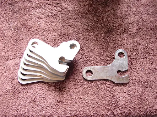

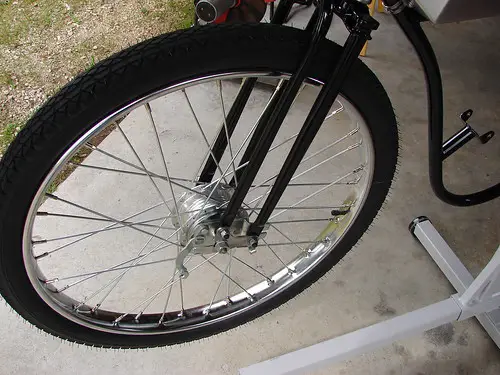

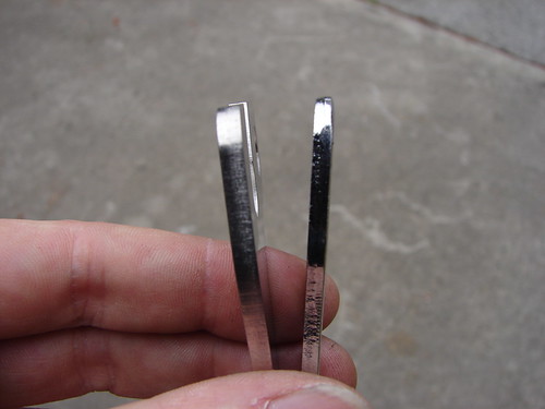

The Worksman drum works well on the Monark fork. First you flip the swing arm brackets to the outside of the fork blades, then you need to anchor the torque bracket to the left rear shoulder bolt. Norm showed me this trick and it works great. There are a bunch of other tricks to beef up the Monark fork and the latest one I have come up with is heavy duty dropouts.
Racer by Sportsman Flyer, on Flickr
Monark Forks by Sportsman Flyer, on Flickr

Hi GasX,
It is hard to tell from your picture exactly what is going on but it looks as though your trying to place the brake arm between the fork blade and dropout. I run the dropouts on the outside of the fork blades. I drill out both the fork legs and the drops (or use my custom drops) and run the shoulder bolts through the drops and then through the fork blades. The hole size must be exact or the fork action will be sloppy. I then tig weld a stop pin (small piece of round bar) to the head of the left rear bolt to act as the locater pin for the brake arm. If you can't weld the pin properly it can shear off under heavy braking and cause you to crash. Also, Worksman from time to time runs out of their standard front drum and will substitute a different one in it's place. Not sure if that is part of your problem.
