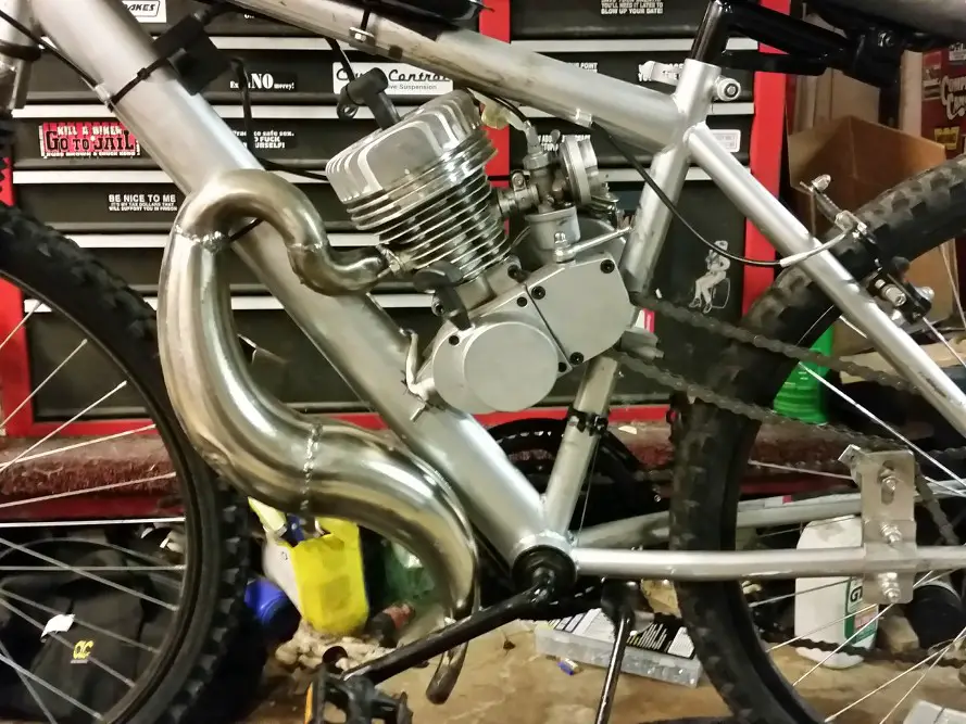

Here it is... with the pocketbike pipe... I basically hacked up the stock pipe and part of the pocketbike header so I could get the bends in the right places and welded up the header, then slip fit the expansion chamber over the header. It leaked a little at the slip joint but still made good power.

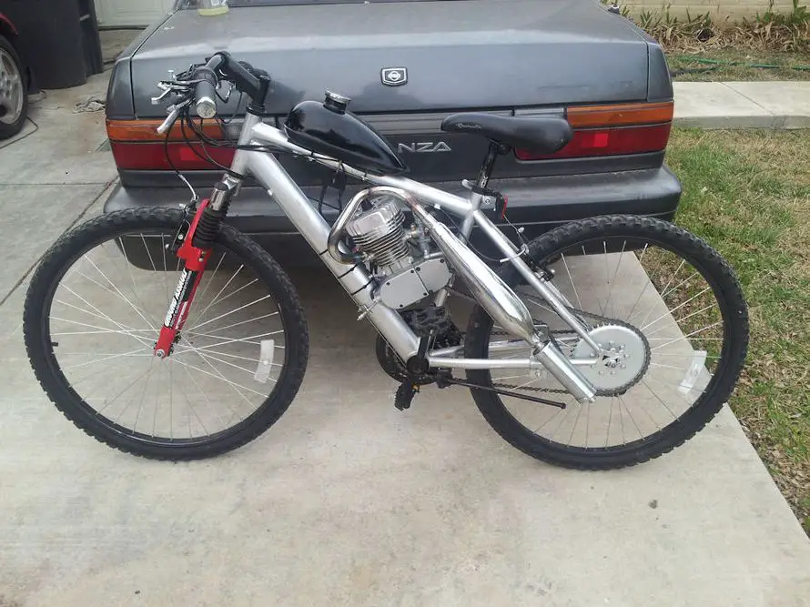

lowaus, here is a pic of the pipe I am running on one of my bikes, I cut about 4"/10cm off of inlet pipe and I'm using flex pipe of about 30cm/12" from engine exhaust flange to the expansion pipe.
This pipe is doing a better job than any of the others I have tried so far, other set ups did good for low and mid power but were lacking on the top end, but this set up is giving me good power all the way around and I did not loose top end speed, this bike currently moves me down the road at 69+kph/43+mph
It has some port work, a ramped piston and a well tuned carb, the lower assembly has preety nice balance also, no harsh vibes at any RPM from start to wide open, that make a big difference also.

Yep this is the best of the small pocket bike pipes I've seen, got one on my heavy 26" cruiser and with my 215lbs on it I cruise right along at 43-44mph with a 34 or 36T on the rear wheel.
Good pipe with a short larger dia. header pipe leading into it.
