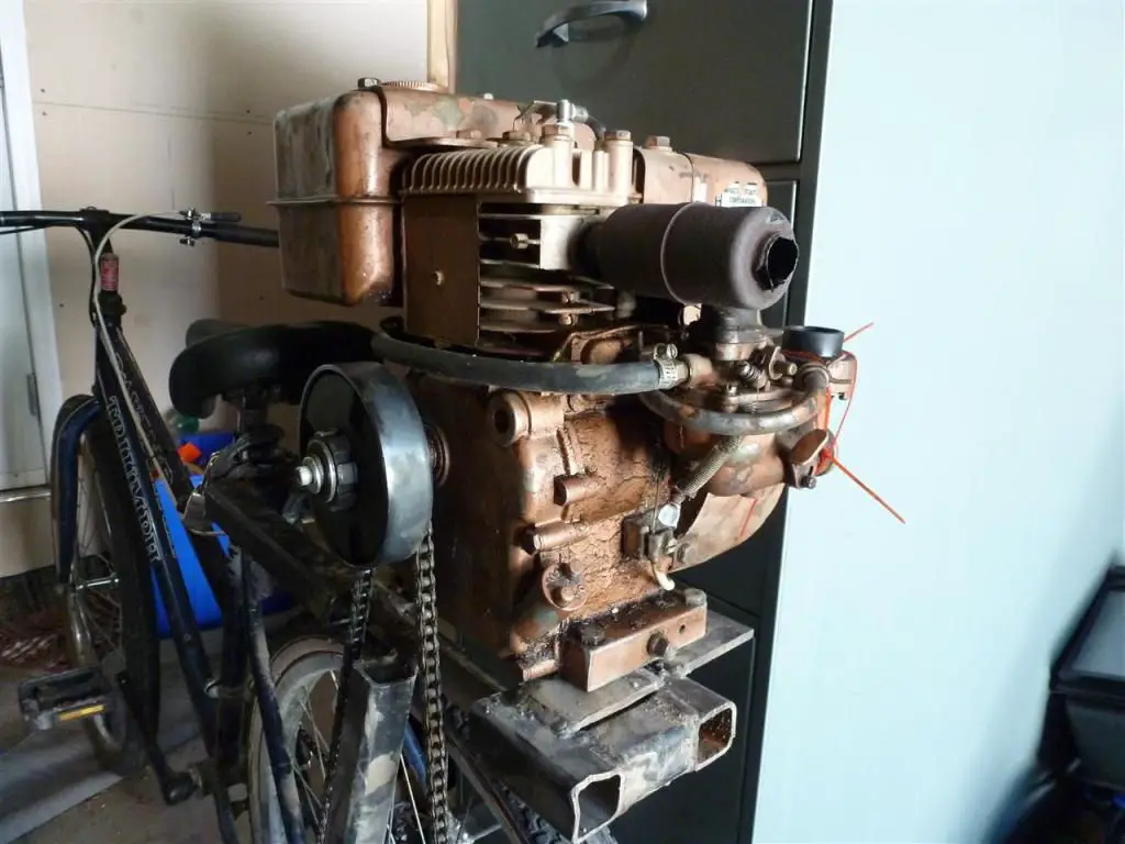

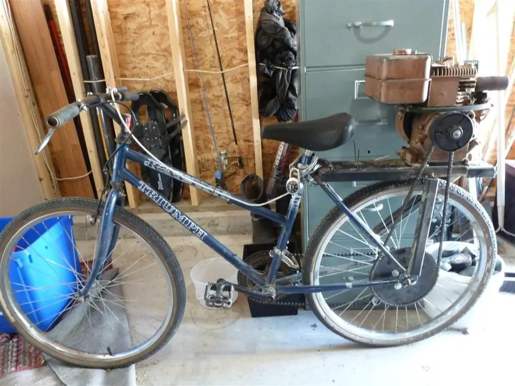

i just finished this bike the other day and wanted to share it with you guys. it has an old briggs that i've had for a few years just sitting around not doing anything. i found an old bike at the dump and brought it home, did some welding with some scrap steel square tubing i had lying around, bolted a sprocket (from ebay) onto the wheel, threw on a clutch and there you have it.
top speed was 57.5km/h, but that was before i modified the camshaft. it'll probably do 2 or 3 more clicks now. there's only one brake, but i'm going to put on the front tire from a mountain bike and some better pads to get a bit more stopping power.
this thing is geared reeally tall. at 57km/h it's only turning 2800rpm. still another 800rpm before it even reaches its rated horsepower.

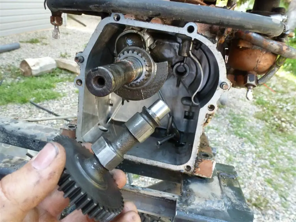

here's after i removed the "easy spin" feature. what it does is pop open the intake valve during the compression stroke, and while that makes it easier to pull over, it's bad for power, especially low down, so i ground the lobe off the cam.
i'm gonna have fun cruising with this thing. i might even go on a road trip or two. already put 80km on it

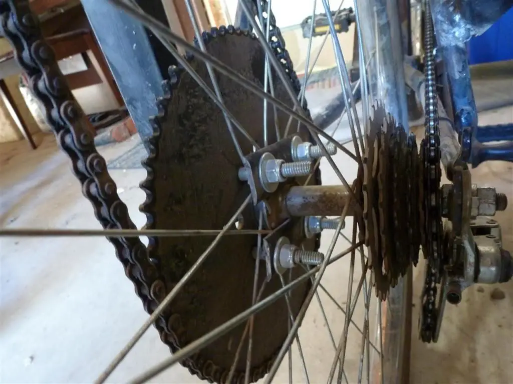

Looks great! Only advice I can offer is find a better way to attach the sprocket to the wheel. Broken spokes at 60 kmh isn't my idea of fun. Even a rag joint would be better, what you have unevenly puts strain on only some of the spokes and will damage the wheel. Everything else looks good though! Have fun!

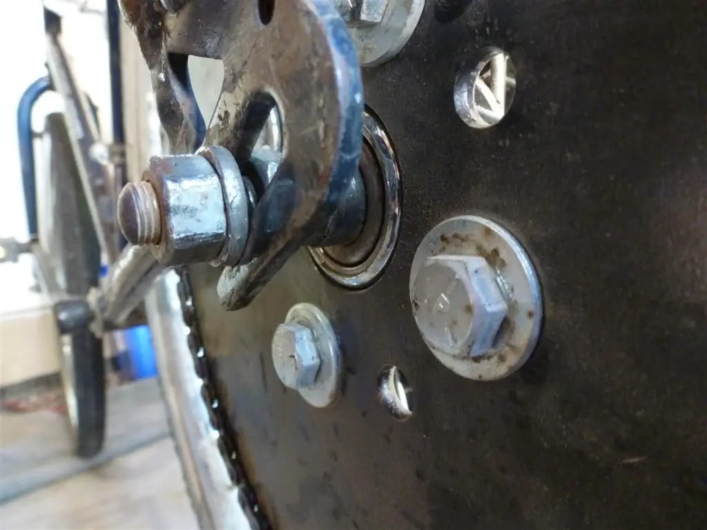

Suzukirider, I was wondering that bike brake for just one (the front wheel) was the way it was made originally.
For thoughts, I felt that I’d show the bosses I made for the mounts for v-brakes ( the original Shimano V’s) from trash picked stuff.
You do welding then you could try this. My bike had coster brakes and now that there are no pedals anymore (not trying for on road legal only OHV an Parade) there would otherwise be no brakes.
One picture a little fuzzy shot at night shows the rear welded on angle brackets without the v-brakes yet installed.
The rear pair of brackets I welding in the position a nut that has a flange. They were fit in and stamped in to a tight fit to a hole I drilled in them. To hold them securely I weld a few spots on the flange to the angle bracket. Then the brackets were attached with these threads so that would be in the right position for the mechanism to move the brake pads to match with the rim*.
The nut threads are the size that fit the threaded portion I scavenged off the bike the v-brakes came from. That is the post that makes the bearing surface that allows the brakes to pivot and clamp the rim with the pads.
All went well until I found that the pulley attached to the rear wheel needed to clear the frame in the back. With a spacer on the left side which fixed that problem, it had caused another. The left rear brake pad shoe had to have a little extra length to rear the rim. I made special extra length onto the shoe to the v-brakes which I made a spare to keep on hand*.
This I don’t think you would run into this depending on how much clearance is needed with chain and sprocket, but if I had known in advance I would have shimmed the left side rear boss so a modified brake pad would not have been necessary. I may still cut the left side boss and adjust it someday.

The mount to the spoke with a washing machine pulley with plywood covered resorcinol epoxy type glue and painted sandwich might stress the spokes, but I never broke a spoke with my build that was a similar type but more crude way back when I built a motor bike when in my teens. If you could spread the pressure of the rag joint over more spoke surfaces it may lessen the chances of wear and tear on the spokes. If you are think about it, even though the old Whizzers clamped spokes clamped differently, it could possibly be adapted to a sprocket.
