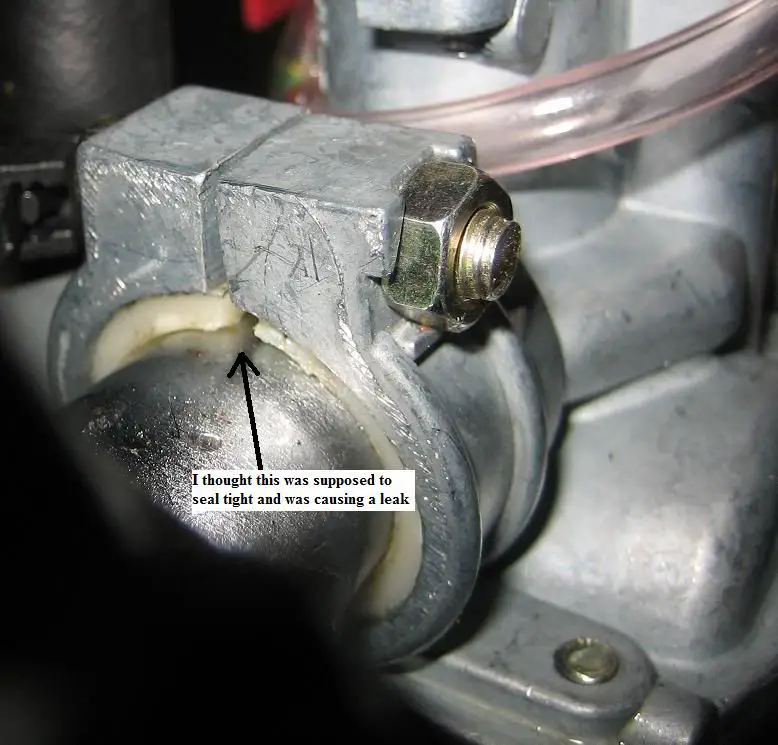

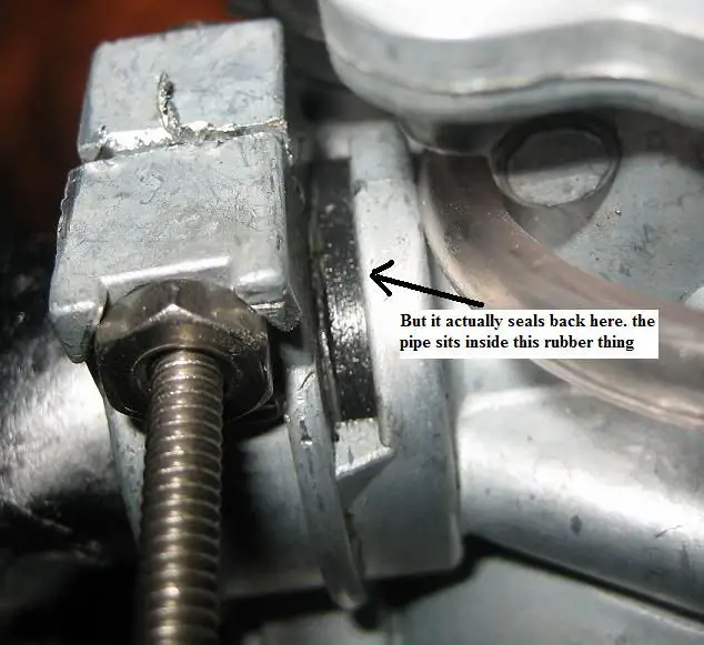

The way this carb meets the intake I originally thought there was a giant leak because theres a plastic sleeve that doesn't go all the way around the intake pipe. I took it off and messed with it and tried to clamp the carb down tighter, but then realized thats not what makes the seal anyway. I think the intake is supposed to sit all the way against some rubber in the carburetor, which is weird because theres nothing to tighten or anything to improve the seal other than pushing the carb on very hard before securing it in place. I'm not sure if filling it with silicone stuff would do anything.

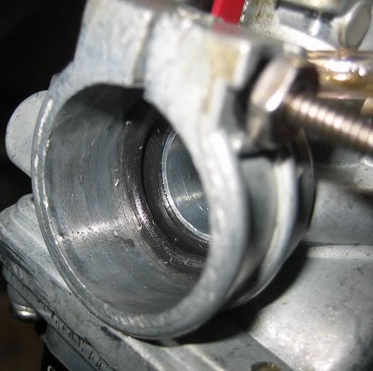

On your second pic,what's that between the slot on the top of your carb?
A screw-driver burr? don't try to "over" tighten if you break off one of those tabs your going to have a big leak that the only fix will be a new carb.
That little supplied screw should do the job.

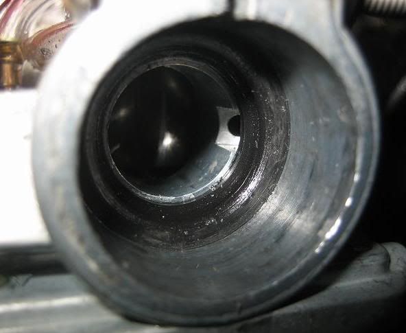

Heres are pics of what the inside looks like. The intake pipe sits in here with that plastic bushing (that blatantly is not to keep gas in/air out, its just there to hold the carb to the pipe) and presses up against the back piece of rubber. Its hard to tell in the pictures but when the pipe is up against the back rubber, the outer rubber piece sits around the outside of the pipe. but just barely.

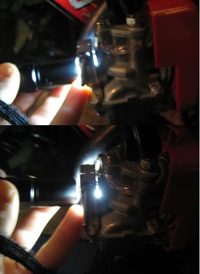

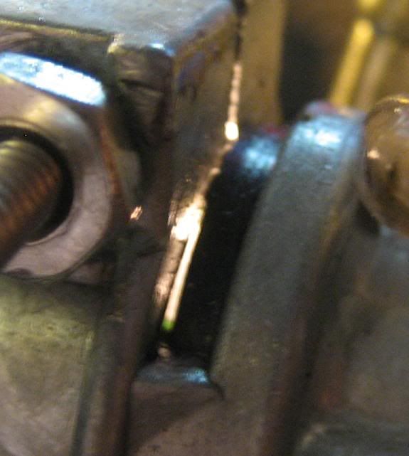

and this next pic is shining a flashlight into the carb, so you can see that theres only roughly one centimeter of rubber between the end of the pipe and the outside world, with nothing actually clamping it down.
This design is blowing my mind...
Sorry for all the super close up blurry pics but i'm really trying to get the message across.
Does anyone agree with me that this is a really BAD design?
Or is it possible that I don't actually understand how it works?
If I try to seal this up with gas resistant RTV should I spread it everywhere inside and out with the pieces off, then put them together? Or should I put everything on tight and then try to seal it from the outside. I'm really worried about getting the stuff inside the carb if I were to put it where it really needs to be (all in/around the rubber part)
