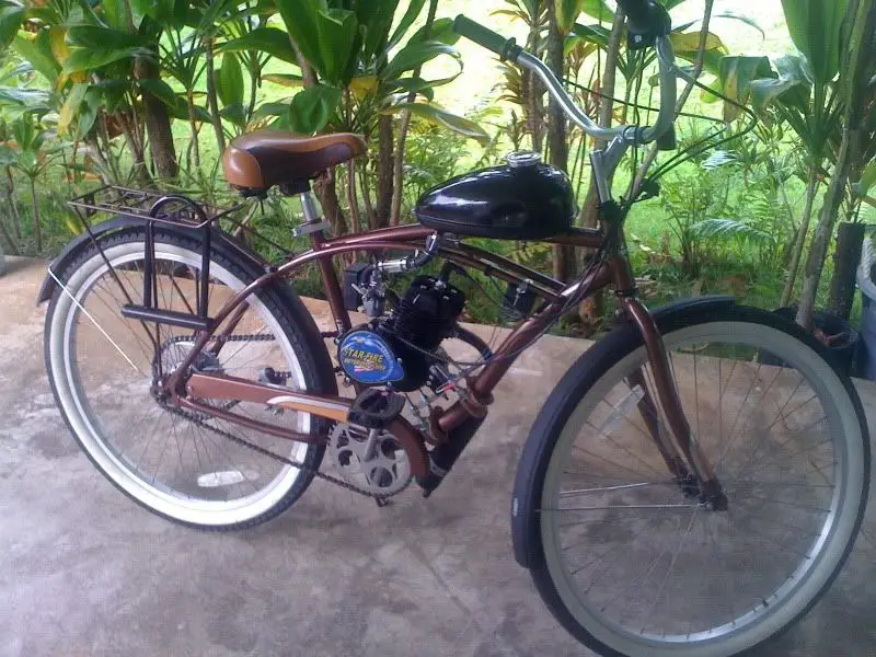

Just finished my first build. Had a lot of issues with everything. Felt like I di everything twice. But now I know how to do it all so that's cool. I initially wanted to build this on my Electra but I would have had to do some frame cutting and welding so I kinda sissied out. Now in kinda bummed I put it in such a dinky bike. It's just a huffy from walmart or something. I got it off craigslist for eighty bucks. It's pretty much brand new. New oil line and in-line filter after having some issues. Had the sprocket machined on a lathe so it's perfect. Cleaned the tank really really good and tht turned out well. I built my own custom mount using two sheets of nail plates. I widened the holes for the 5/16th bolts and just made new holes for the engine bolts. Also made a custom exhaust strap. Everyrthing came out well. It's all sturdy. Not really any shaking or vibration(I put a good dampened on all three frame mounts). I am having chain tension issues but I got that somewht taken care of. I took out another link but I still need a new chain idler(broke on test run). Anyway here she is. Thanks to everyone who helped on this forum. Next build is either my Electra or I've been scoping out that new felt mp model. Oh schnap!

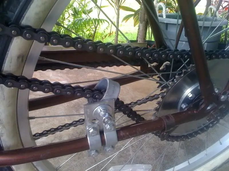

try a skate bourd wheel just make a grove in the middle they work awsome!!!!!dnut

You just made my day! That's an awesome idea. And it'll roll so much faster than the stock one. How do you groove out the wheel?

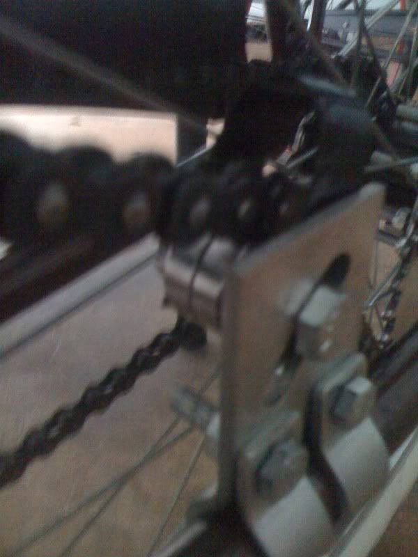

Thanks Kla63 for the idea. Too hard to carve
out the wheel so I just used the bearings on the bolt with some washers then put that black metal piece that came with the kit over the bearings and chain so it's surrounded by a track. It's not coming off this time. Here's a pic.

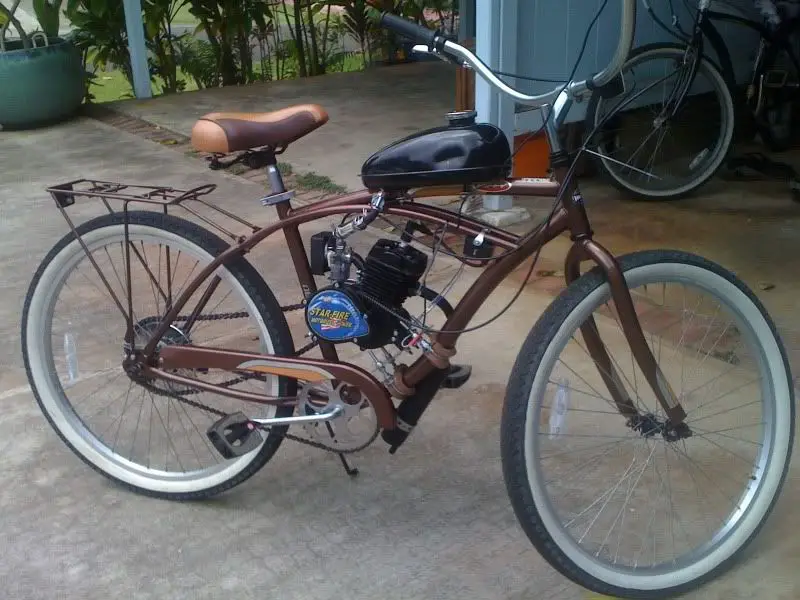

It's a "nel lusso" huffy. Thought I hit the jackpot for eighty bucks but then found it on yahoo that it's from walmart. Damn you walmart! It looks nice but the product shows it's cheapness. Well I been tinkering here and there and she's riding a lot better now. Built a new chain tensioner roller and housing. Raised the fenders up for safety so it clears my wheel. (was riding really low before) the engine is running better and better everytime. It's only been a few days so I hope it'll still get a little bit faster which I'm sure is normal for break in periods. Did the fuel lines......three times. I guess like everything else on this bike. But it was fun and it actually works so I'm stoked.

Cool bike, you need to have the tank painted to match the color of the bike. I see both brown and tan. Two tone like a classic harley.

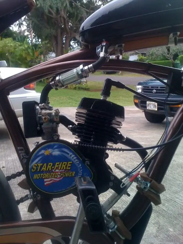

Thanks a lot guys. I had to tinker with it like everything else....multiple times. What saved the day were these "hose clamps" from ace hardware Hawaii. The filter and line is from Napa auto parts. It works really food and the glass chamber ia always completely full. I actually run my carb fuel lever at not fully open cause the flow is so good. Here's the most recent photo.
so I was ready to go last night after thinking I fixed every last thing but gas started leaking heavily out of th air filter area. Any ideas? I'm so bummed. Been working hard and it seems lime there's always something next. Thanks for everything.
