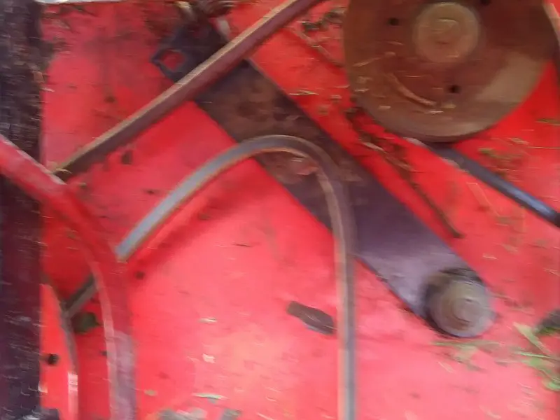

when it rains it pours! the missing pulley had the bearing lock up and the way the Gravely mower designed the deck the locked up bearing spun the lock nut right off and chucked the pulley off without destroying the $80 blades belt. so a bit of bad luck and a bit of good luck.

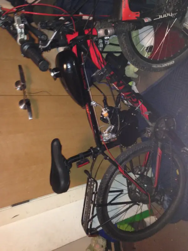

Ever since I swapped my motor over to my new frame it doesn't want to start although it sounds like it wants to so I don't know what to do if anyone is there that's had this problem could you please reply to my trend telling me what you did to fix the problem

Check wiring to be sure it has good connections. Also, if the engine is mounted, tipped too far forward it will cause the float in the bowl to allow too much fuel in. Flooding the engine with fuel. The carb should be as level as you can possibly get it. A little forgiveness is built in but the carb should be level.
Let's see a pic of the motor in the new frame.
