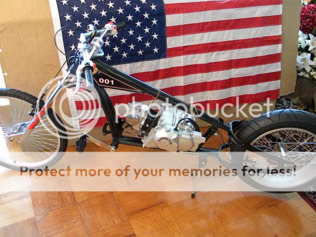

For those of you considering a Stretch Cruiser / Chopper Build using a Horizontal Cloned Honda 4-stroke 50cc ATV/Pitbike/Dirt Bike engine.
Here's a lil History bout those Honda bikes / engines the first one's Honda sold in the USA were the Honda Cub's or Super cub that was around 1960, then Honda released the Honda 50 Mini Trail around 1968, then came others like the Honda CT 70 Trail Bike, using the same 4-stroke horizontal engine used on earlier Honda models.
It is my understanding that the Honda Patent for these Horizontal 4-stroke engines expired, and the Chinese then jumped on this and started producing them, probably since 1995 is my guess.
There a many forum members here that have used this same cloned engine for their Stretch or Chopper builds.
I have a few builds ongoing that will be powered with this same style chinese cloned engine, one is an OCC Stingray Chopper and the other is the XL-Chopper ( extra Long version ) chinese cloned Chopper.

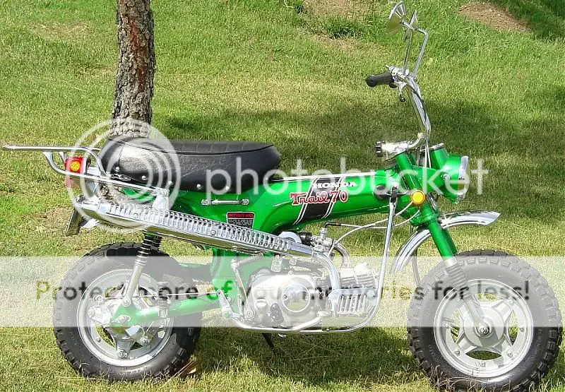

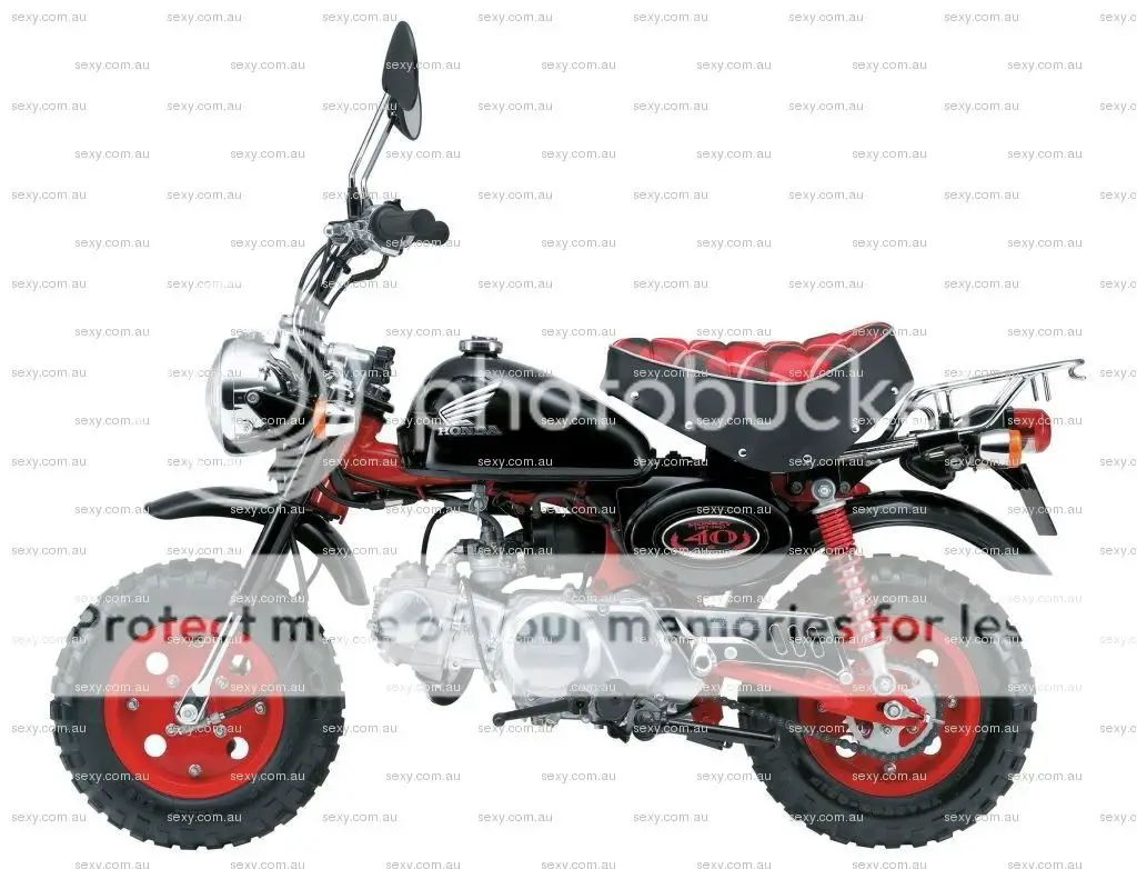

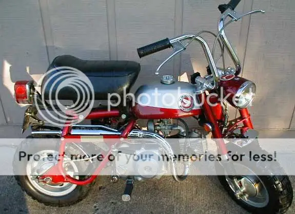

Here's a few pic's showing the Old Honda CT 70 Trail Bike and the Honda 50 Mini Trail Bike it's now a Chinese clone sold as the Monkey 50 Trail Bike:

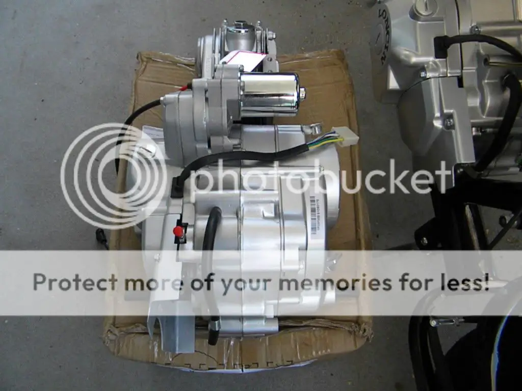

Just wanted to ask has anyone else thought about using this type of engine!
Well after purchasing 2 Loncin 50/70cc engines at $139.00 a piece new in the box, I was searching the net and low & behold I found a new and totally different engine!
It's still an E-22 copied engine aka Honda chinese cloned horizontal 4-stroke 50cc, this is same type of engine used on Honda Monkey bikes, Honda CT70, Honda Mini Trail 50, Honda CRF50, pitbikes, dirtbikes, & atv's use this type of engine.
There's a big difference in this engine being that the shaft where the Kick start would normally be has been removed, and in it's place is a pedal crank. So now we have another 4-stroke option for our builds.
This engine with pedal option is coming soon to a very large distributor here in the USA, and I was fortunate enough to order the first one. This distributor is most likely to have 20 engines on order.
Here's the engine some of you have already seen this in another post where I'm building an XL-Chopper with this type of engine!
Leave it to the chinese to come up with more use's for these Honda Horizontal 4-stroke engines, here in pic below shows this type of engine used for a moped!
