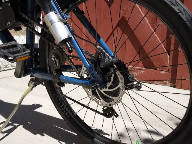

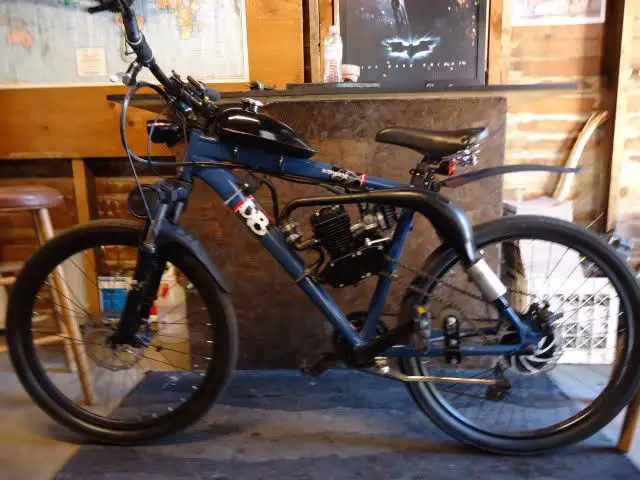

After careful consideration and time wasted day-dreaming here it is, a dual (f/r) disc brake setup without the use of a top-hat adapter or and SBP shift kit. Let me know what you guys think, feedback is appreciated. :) More picture to follow.

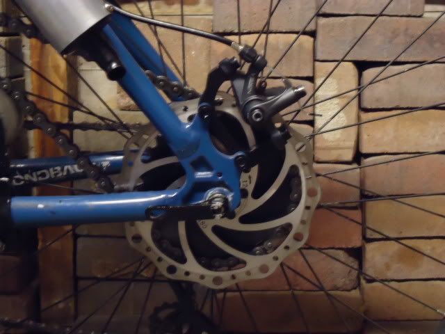

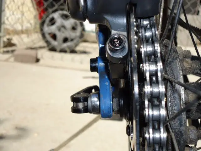

I love it, Frank. I can't wait to have a close look. What 'T' sprocket is that? I couldn't get chain/caliper clearance using a 40T, even with a 203 rotor.

I run a 34T sprocket from Andy. I didn't think it would work; but when I got all the components on hand it was pretty straight forward. I had already bored out the sprocket to sit on the hub when I swapped over to this bike, so that was time saved.

anyone think about using the sprocket as the brake disc also like they do on modern choppers?
I considered a modern chopper type setup with a single sided caliper and sprocket as the rotor. Although it may work for others; I have a smaller sprocket then most, so it wouldn't have worked even with a 140mm adapter. Why take shortcuts and sacrifice braking power and have potential problems, when I can say "I'm one of the few that made it work right". :)

Okay, now I'm jealous. I'm going to pick up a small sprocket from Duane and start playing again. My previous attempt might have worked if I had wanted to fudge a little on pad/rotor contact area. If I went for full contact the caliper and chain would touch. If I go to a smaller sprocket, something I've resisted because of my hilly neighborhood, I might be able to squeeze it all in. I want to see Frank's set up first and see what he did for a caliper bracket.
If you get a 36T sprocket and a 185mm rotor/adapter then it should work without having to grind, chop, or shim. I have Tektro brakes, which don't offer a 185mm adapter or rotor like Avid does. So I had to play with it a little bit. There is about 99% pad contact with perfect alignment and it stops way better then I ever imagined, especially with the wavy rotors. George has already seen it in person, you guys can see it on our next ride or your welcome to come check it out. Let me know if i can be of assistance :)
