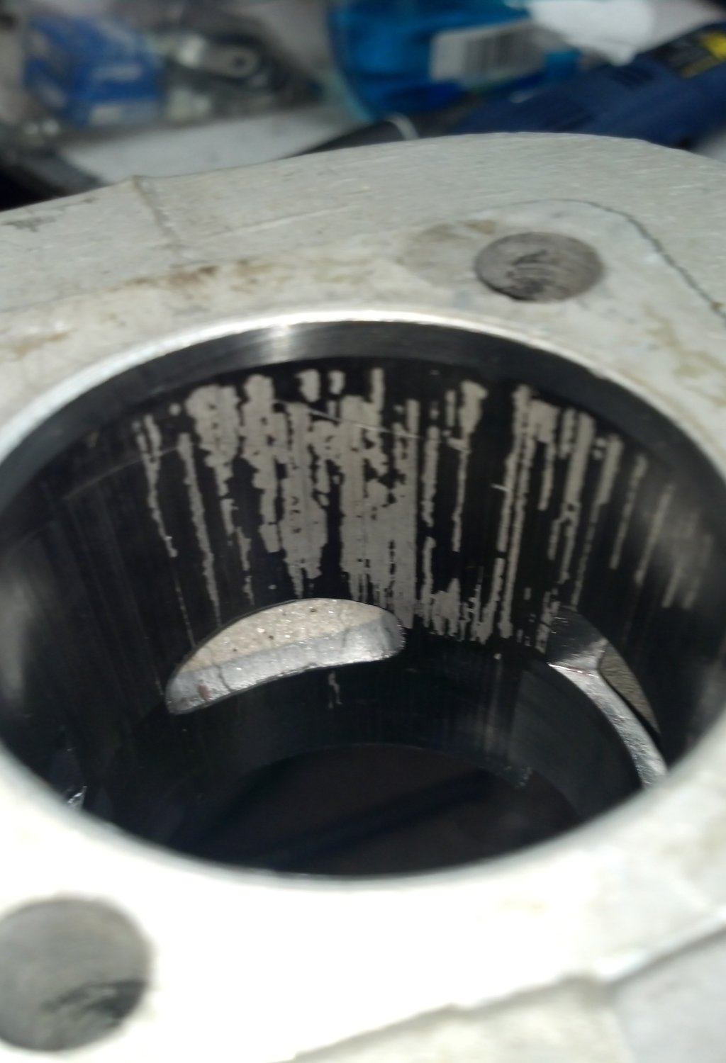

I would still not ignore the fact that if you don't break in correctly or long enough the chrome plating WILL flake and score.
Just curious.....have you had a problem with chrome chipping in your engines?
I run mine about 10-20 miles fairly easy and themln pretty much run thek from that point on the way I plan to ride, I run 70 -100:1, never had a single issue with cylinder damage of any kind and my engines break in and run well.
I undersand what you are saying here but I have seen no proof of it being an issue.

That cylinder was a week old was still running 25:1 and still breaking in. My current cyl is doing good at 25:1 so far but has premature scoring.

Chrome and Nikasil failures do occur (a growing number of companies specialize in "re-plating" Nikasil cyliners of all types). However, most of these "failures" are most likely caused by excessive piston clearances, FOD, piston/ring seizures, and high sulfur content fuels rather than a failure of the plating itself. Modern Nikasil bores are occasionally known for premature failure due to manufacturing defects (such as excessively thin plating and improper cylinder preparation prior to the plating process). Otherwise, they're known for lasting through as many as 6 piston changes in high performance engines (in other words, they either fail "right away" or they last "forever" ).
Here's a couple of links with more info on the subject:
http://www.kenoconnorracing.com/Cylinder plating VS Cylinder Sleeves.html
http://en.wikipedia.org/wiki/Nikasil

All I have to say is that I use what I believe to be the finest and the best 2 smoker oil made and the other here that use it have never had any such failures that I'm aware of, if there is a manufacturing flaw with the plating nothing anyone does will likely prevent failure but any failure of the plating that is not related to manufacturing defect is likely caused by improper lubrication and nothing to do with break in procedure.
Best of luck with everyones cylinder plating....... use a quality oil and if you dont have a flawed pert out of the box you'll be just fine.
