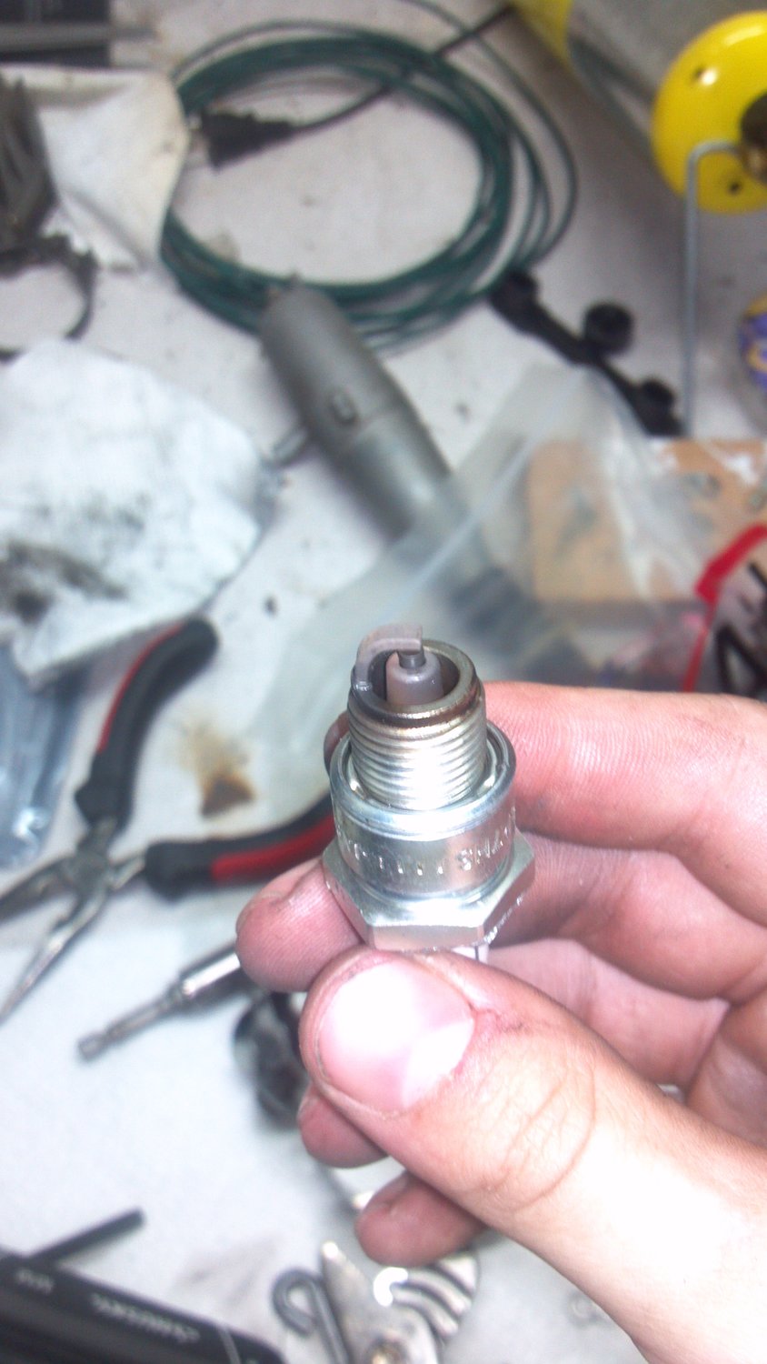

Well after a hard run and shut down with no idle or turn over, what does your plug look like?
I would say if you jetting for 16:1 oil and now you went to 25:1 I would say you are running fuel rich. (but it could be not related to air fuel!)

thanks pablo im new to tuning but ill take a pic of my plug and post it the plug looks perfect to me.. but doesnt run perfect. i also have 4 other jets ill try a smaller one tommarow!

Here is the plug now it looks perfect to me.
i did a few things, i raised the fuel level a little bit in the bowl i also drilled out the pilot jet a few sizes bigger and turned in the idle air all the way in and backed out 2 turns.
Bike hits power band faster and runs good!
Thanks for the help all.
