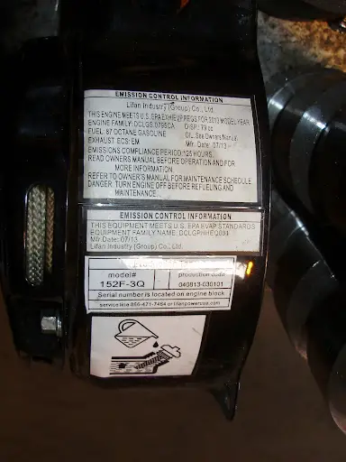

To put this thread back on track, the 152F engine has been OHV for at least a year now:
That tag says 07/13 for a MFG date, as well as 79cc.
I have had the engine for more than 9 months, so any flat head 2.5hp Lifan engines out there are old stock that is still flushing from low volume re-sellers.
The OP asked about longevity. So far running a stock rod & valve springs, the engines are holding up well, even with running 6200 rpm.
