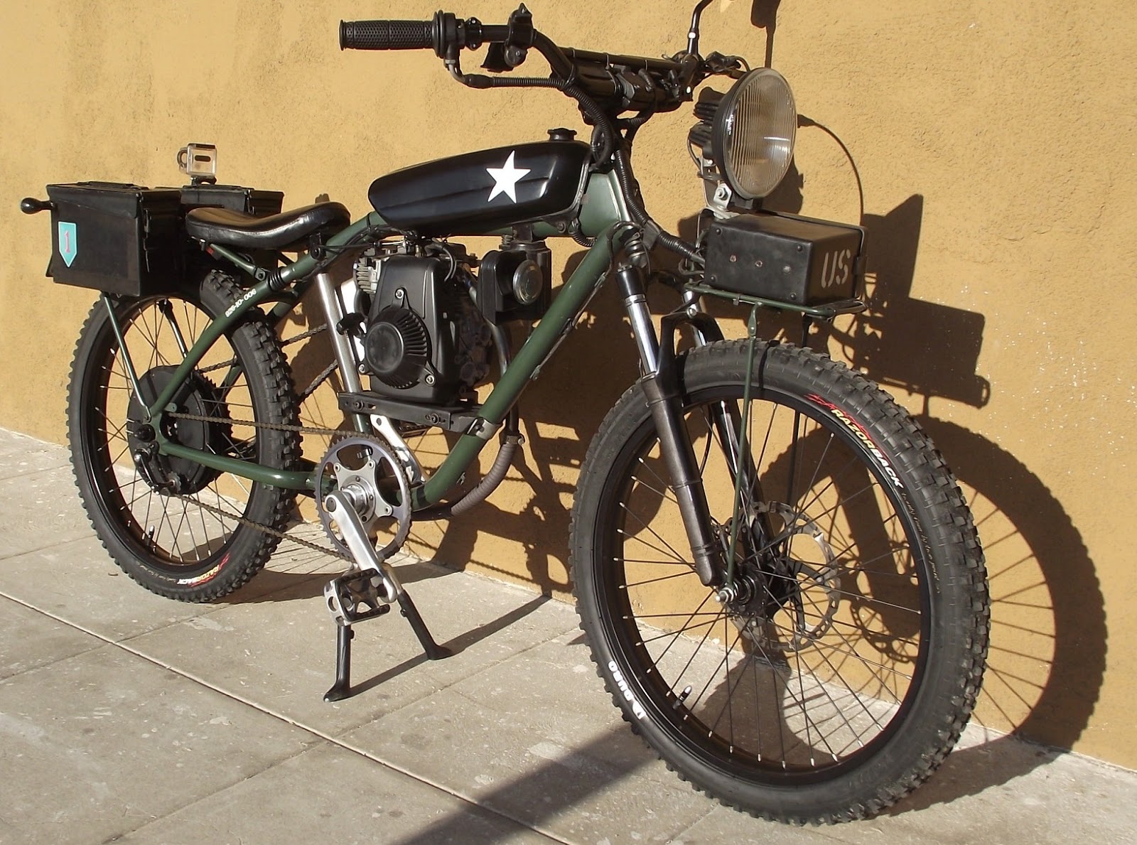

Combined mileage from Crystalyte HS3540 electric hub and HS49 is now approaching 4000 miles. Both motors are almost bulletproof. Only the HS49 requires routine maintenance of any kind.
Bike originally came with fenders. The front fender quick broke off thanks to the streets of Los Angeles. Rear fender lasted much longer but finally gave way. Fenders are just too dangerous to leave on unless they are heavily reinforced at the mounts, so I reluctantly tossed them. It's just not worth the risk..... for or to me. I bruise easily and I'm not a big fan of pain. LOL

Also why is that hub in the rear so huge? what kind of wheels are those?
The rear hub is electric (Crystalyte HS3540) with 2250 watts feeding it from the battery in the right ammo can. It is instant monster torque from 0 to 30MPH.
Tires are Duro Razorbacks 24"x2.6"
Rims are 50mm Felt 24"
I got 1/4" clearance on both sides of the wheel. That's about as minimal as I want to get.

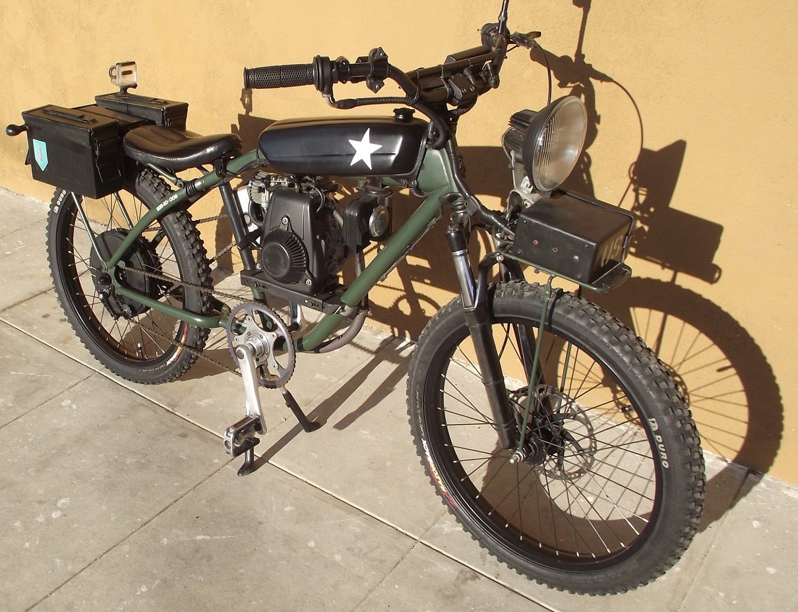

wow, so ur utilizing electric n motor. thats a first ive seen. whats the top speed on that?
Top speed of the entire bike is only limited by the size of the gas engine. 40mph with a 49cc engine. The gas engine does all the high speed, long distance cruising and when the brakes are applied, the electric hub recharges it's batteries like a Prius.
Top speed of the electric hub motor is only limited by the watts powering it. 2250 watts will get this thing to 30mph by itself. 4500 watts would almost do 50mph by itself. And it gets to that top speed in hurry as well. Electric hubs have monster torque. From a deadstop, at a red light, I'm usually the first one across the intersection when the light turns green. Unless there's a motorcycle next to me, then I'm a close second across. Most motorcyclists will gun it, if I look like I'm gonna make it across the intersection before they do. LOL

lol wow. must be a blast to ride! i only see a front disk brake, do u have a rear brake?
Rear brake is internal electric (brake regen). It's what recharges my battery.
It feels a lot like ABS braking in a car.
Yeah it's fun. I just wish I could fit a Honda GC160 for the extra top end I need in LA. If I could just do 50mph then that would be perfect for LA streets. I could then ride on any street and feel comfortable while doing it. Not be so glued to my rear view mirror all the time.

My bad.. Spelling.. How did you wire the brakes/throttle with there being two separate systems.
The Tektro Auriga Comp-E Hydraulic brake has a electric switch built into the handle that activates Brake Regen to the controller when you crack that brake handle. It alone can pretty much stop the bike on it's own without the front brake pads ever engaging, on level terrain.
Throttle are separate. Electric thumb on left handle, twist gas throttle on the right. From a stop light or going uphill, both are engaged simultaneously.
