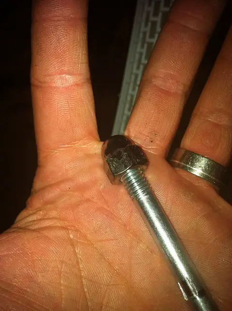

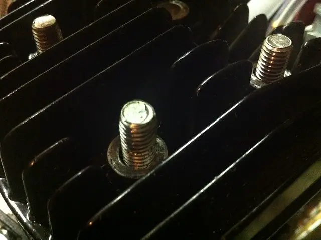

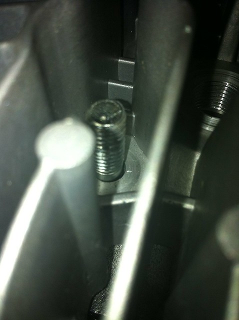

Here's some pics to clarify:
Stock head stud with nut:
Stock head stud with stock head clearance
Puch head with stock head stud clearance:

Yup. Was just down in the garage rethinking things. I'll grab some more hardware this Monday. Wouldn't it be wise to just replace it all, though? Or is this size of thread gonna be hard to find?
What have you done as far as tuning with this head? Right now, I have the CNS V2 carb, exhaust/intake port matched, SBP xchamber on a Jet 66cc. Nothing has been ran or tuned. I have a RT carb from Dax on it's way. Seems to me that it'll be wanting more to drink with these mods. The Dax carb comes with a jet kit. Maybe I'll just leave the CNS on for a day or two and see what happens.

One of the problems with the Puch head is you need the smaller 13mm nuts and not the standard 14mm. You can't get a 14mm socket into the space between the fins. This is on the 66cc motors not the 49's and their smaller M6 1.00 studs.
2 ways around the stack of washers thing, tap the holes to the bottom. Many times that is not done, I think to cut costs. 2nd is to get the sick bike parts head stud kit. It has a stud of hi-grade steel all-thread. Plus the M8 kit comes with the 13mm nuts. You do have to enlarge the holes a bit more that 8mm because they don't exactly line up. The Euro bolt pattern is slightly smaller than the Chinese.
