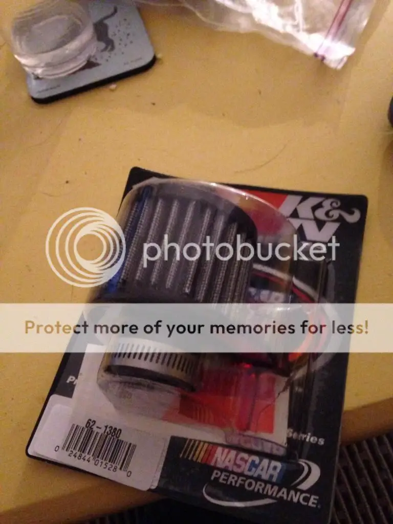

so iv had constant trouble with my skyhawk running rich, found it would always run better (almost perfect) with no air filter. first thing i did was located an oil breather i had at work. it was made out of the same stuff k&n filters are and was a fair bit bigger then the stock "performance" filter. boy didnt that make a difference!
only problem i had with it was the rubber boot was missing. to make it work i retro fitted the stock rubber filter boot to the new filter but never had a tight fit. after it fell off tonight i went and searched online for a new filter and found this:
http://www.4wheelparts.com/Performa...aspx?t_c=74&t_s=383&t_pt=3434&t_pn=K/N62-1380
the only way i noticed i had lost the filter was because i had more power. this filter is 1" longer and 1/2" wider then the one i currently had on there. plus its 1 1/4" ID for the intake which is a perfect fit! cannot wait for this thing to show up!
fyi. 4wheelparts had it cheaper then summit!

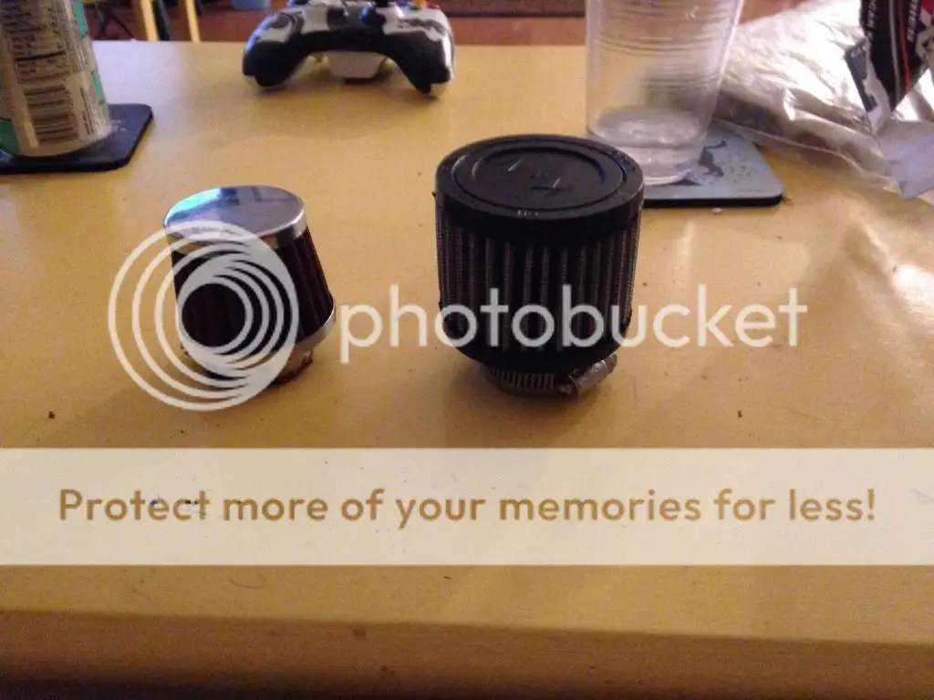

its here!
on the left is my prevoius air filter (about twice the size of my "stock" perforance filter), and on the right is my new filter. even comes with filter oil.
i ahve yet to try it out, its currently 8 degrees here.

update. long over due. this air filter works amzing! thats all i can say. plenty of power to boot. i still had to adjust the pilot circuit a tad smaller but thats a lot less then i had to do before!
