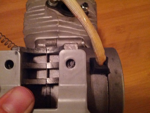

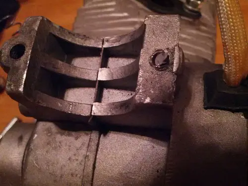

Ok so I tried using the other easy-out. Turned out to be a bad idea haha, despite you're warnings the easy-out has snapped inside the whole (my fault I felt it grab and just kept forcing it till it snapped). What's done is done and now I'm looking for another option.
So now I'm wondering if it's possible or if anyone has done it here before, but could I drill a hole under the existing front mount hole? It seems like there is enough space to but not sure if it would be a bad idea or not. The thing is I already have the front mount from sbp so that would be the most simple solution. If this is a bad idea, I'll have to go another direction with the way Al.Fisherman did the front mounts.

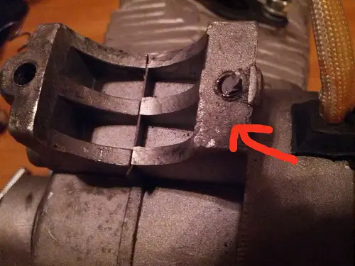

Maybe the stud could go here?
And drill the mount for the new location.

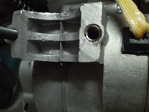

Ok so instead of trying anything further and possibly messing this up even more, I figured I'd take to someone more experienced lol. So I took the motor to my step father, a couple days ago. I went over tonight to see if he did anything.

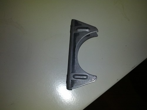

So the next thing I want to do is weld the piece the u bolt goes through on the sbp front mount to frame and it should be ready to go.
This piece:

That looks like a helicoil repair, it should work just dandy.
Why do you want to weld the muffler bracket? I have installed dozens of those and so long as you have the right sized muffler bracket they hold just fine as is and you aren't stuck with a fixed mount which you may really regret some day.
That bracket you have looks pretty big, is that why you want to weld it?
That would be silly, muffler brackets are a $3 item at the auto parts store and come in any size you want so just get one that exactly fits your down tube.

That looks like a helicoil repair, it should work just dandy.Why do you want to weld the muffler bracket? I have installed dozens of those and so long as you have the right sized muffler bracket they hold just fine as is and you aren't stuck with a fixed mount which you may really regret some day.
You are correct sir, the exhaust clamp that came with the mount is too big, and the smallest one they carry, which is the 1-3/8" exhaust clamp. If I where to get a small exhaust clamp that would make the U bolt smaller, so would I need to do any modifications the other bracket that bolts to the motor?

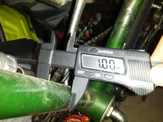

I did get a caliper and measured the down tube, but it's smaller than when sbp carried. I don't have the measurement right now I'd have to measure again and see if there is an exhaust clamp the same size.

So I measured the DT again, as you can see it says 1inches. I noticed exhaust clamp that came with kit is from napa auto parts, does anyone know if they sell a smaller clamp like a 1 1/4 or 1 1/8?
