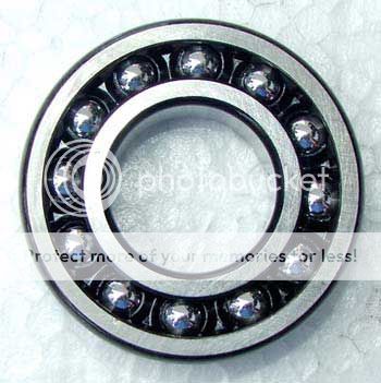

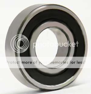

So because they make bearings which are both heat resistant and able to seal the vapor of the crankcase at a mere few hundred degrees F, I see no need to purchase both bearings and seals separate. What you want to do is find a bearing that is sealed in itself - all-in-one like this:
Sealed bearing
Without seal
..........and the crankcase pressure cannot get through this quality bearing, therefore you do not need another seal also. (referring to the top picture)

There's shaft seals and then there's sealed bearings they are not the same.
You will still need crankcase seals.
But go ahead and try your idea, you'll soon be looking for proper seals.

Hey Norman, my engine didn't have a single crank seal installed from the factory. When the bearing came apart it caused a huge vacuum leak. The bearings I installed are a sealed bearing, much better than the metal seal the engine came with. I am still not running any crankcase seal without any problems. My engine does not lack any power from idle through WOT.
The funny thing about this forum I've noticed, is that everyone sticks to the book and never tries anything to see if it will work or not. That is the only way to find out how tolerant things actually are.
So with this, I will say that you can run without seals if you have a good quality sealed bearing. I've put several hundred miles on it this way. My magneto is completely dry (no fuel/oil), and I have no problems with my clutch getting wet with (fuel/oil).

Like I said go ahead with your sealed bearing, you will need real shaft seals before long. Sealed roller bearings are not designed to seal like shaft seals.
So you have a couple of hundred miles on it with no problems.... how do you determine the mileage?
You can get away with using something not designed for the use intended for a while........ for a while.
I would not recommend anyone do this to their engine.

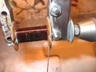

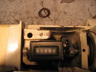

coils are easy to rewind. It's cheaper to buy a coil than to rewind them, the price of copper wire is high compared to buying a manufactured coil.
starting a coil
all of the fine wire on the coil
you will want a way to keep track of the number of turns.
Thanks for the pics. Yes, I have found prices for the wire I need and it is definitely more to rewind than buy a new one.
Just had magneto #2 burn out on me. I've only got one spare now to run on the bike, so I need to get with winding my old ones soon or I will be buying more.
I am thinking the coil failures are mainly caused by the quality of the wire they use. If the wire is made in China as well, then I can imagine the quality control on the diameter is poor.
