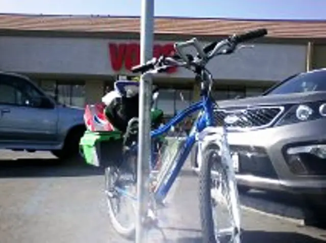

Bike Intro
Really simple e-bike set up.
Target Dept Store Schwinn bike
And I threw some Scwhlabe tires on
Q100 cute motor
K63 controller
Both motor/controller can be found on this site:
http://www.bmsbattery.com/rear-drivi...-bike-kit.html
I'm running 10S/37V lipo. They allow 1.25K for the metric 100K run, but figure since it's only 63mile I'm good with 0.62 or 0.66K of lipo. More on this with decent photos later.
With 3 weeks to the Feb 9th run, I finally got in a 30mile ride before picking up some steaks and diet cheery Pepsi. Bike feels good, but I won't be in such great shape by then. That's what the motor's for.

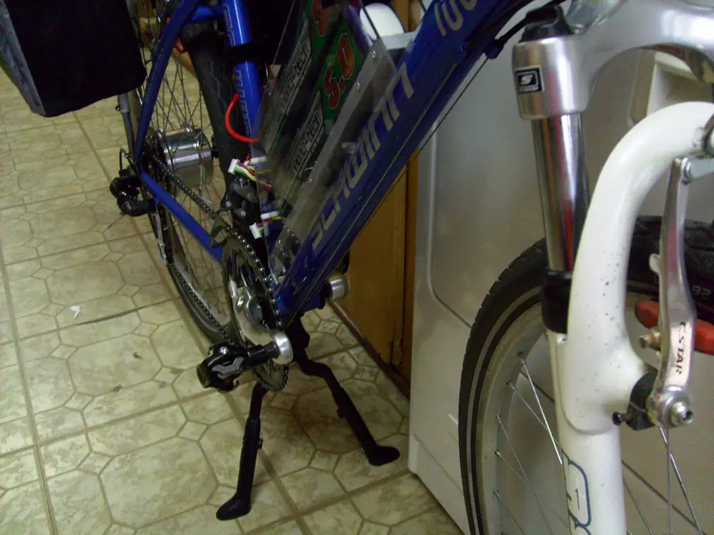

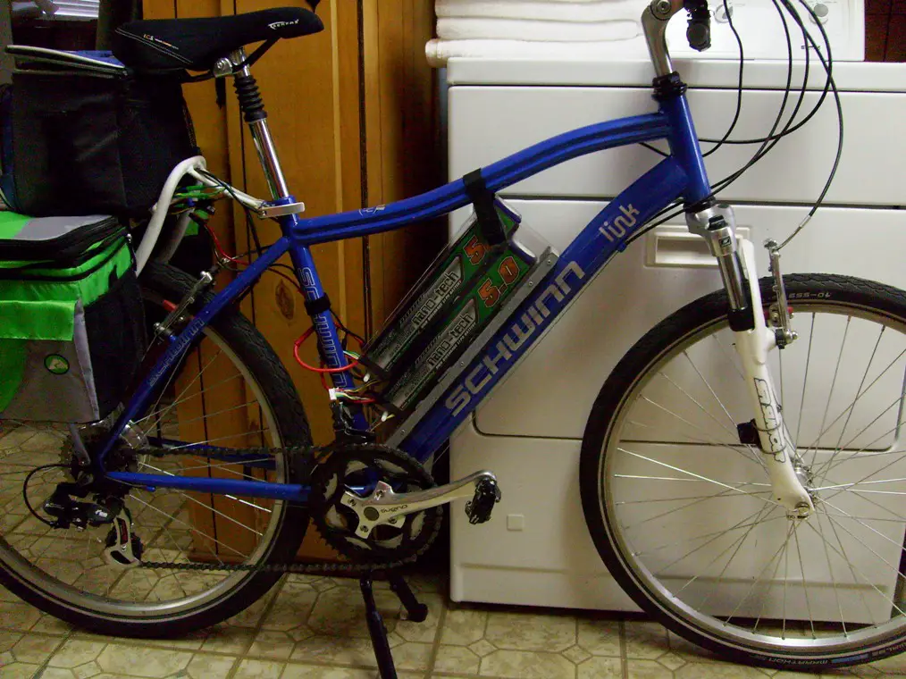

Bolted longer 175mm cranks with bigger 48T vs 42T chainring.
Thinking here is to match my pedalling poweress he. .he.. to motor strength. The Q100 cute is defintely a mini. If my 190lb mass heads up a half-mile 8% slope without pedalling, it's little heart 'll work to death and puff out its' magic smoke. The motor turns 325rpm, good for 'bout 25mph if one assists a bit; has a sweet spot at 19mph that matches an 85rpm cadence in 9th gear on my 26" wheel set up (just a 10 speed these days). 19mph will serve to meet my goal of a 16-17mph average with a 10min break at the 32mile mid point. (Low-Key site posts times and average speed.)
Another advantage of the taller, 29mph+, gearing is coming down mtn. No reason to sit at 25mph when some efficiency is gained with light pedalling. Sometimes it pays to spin up to 33mph a moment, tuck in and enjoy rather than get limited down in the high 20's due to inadequate gearing.
How to have a nice afternoon: A sunny near 70 day, the fat pregnant ground squirrels darting over the bike path, having to dodge 'em as the babies will birth come early Feb. 18mile out and pause at a cement bench with a low southern sun beating in. I'll make another run out here and if it's warm again, the coyotes should be out snacking on the little fellows. Pretty laddies out on the path too, excellent barbados tacos at the Chiptole outdoor restuarant. Only used 4.6K batt (or 7.5 of the 10 amp/hrs) for the 36mile run, have to step it up to a 19mph pace!
And yes, some sort of clip in necessary. I'm using Shamaino pedals from my mtn bike days.
38/48T chainrings, 28/13T 5speed
