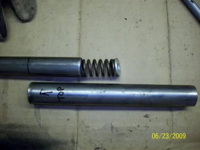

Here is some photos I found...
I used a 1" seat post and a 7/8" seat post, spring, washer and a bolt.
The 7/8 post slides in the 1" seat post
the washer butted up against a small piece of 7/8 seat tube welded to the 1" seat tube to hold the washer in place.
The seat tubes have a channel slotted completely through them for the bolt. This eliminates the seat from wobbling and spinning and to keep the seat from lifting up. Once the bolt is through just cut the head off and grind down so it all slides in the seat tube of the frame.
A little more to it but that's basically it. I cant seem to find any pics yet of the bolt and slotted channels I made.

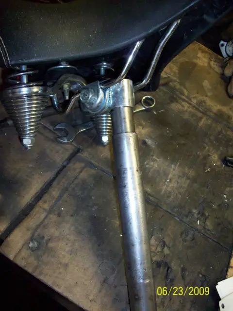

What I meant to say was the 7/8 seat tube has a channel slotted the same width as the bolt, the 1" has a hole drilled for the bolt.
It's hard to see but what I am pointing out is the bolt shaft that goes through the 1'seat tube and through the channel of the 7/8 tube that is inside that cannot be seen.
