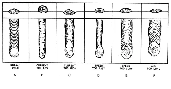

...no matter the material, the welds mean everything. Be it an $80 bike or $800, steel, chromoly or aluminum - if the welds don't look like example A below, you don't want it regardless of price or what it's made of;
Lots of the steel box store bargains suffer a combination of B & D, which isn't really a surprise ;)
Example of good welds & gussets on an aluminum frame;
Example of garbage gun gloop on a cheap steel bike (I chopped it for scrap);
Exactly... Good welds are mandatory and sloppy or poor welds can be dangerous, especially on a bike frame.
