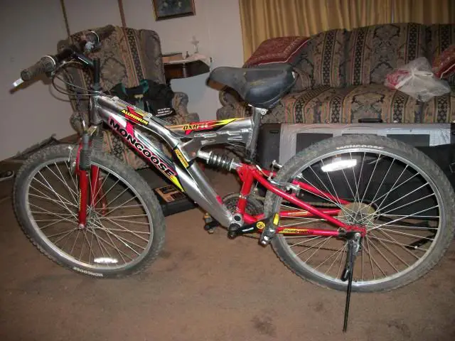

The bike is a Mongoose 26" DXR AL mountain bike. It's an 18-speed bike with a fairly decent suspension setup, and side-pull brakes. I'm not sure of the age, maybe 4-5 years? It doesn't need much to get going and I'm getting a good price on it.
It needs a rear inner-tube and possibly a new set of tires, as the ones on it show a bit of dry rot.

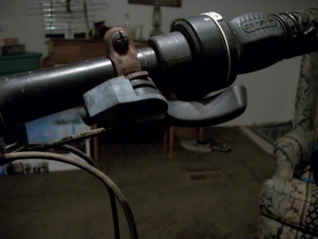

I've got a bit to figure out, but it should be a nice little rig if I can do it right. I've even got my first real piece figured out; a thumb throttle that lived on my old MTB as a thumb shifter...

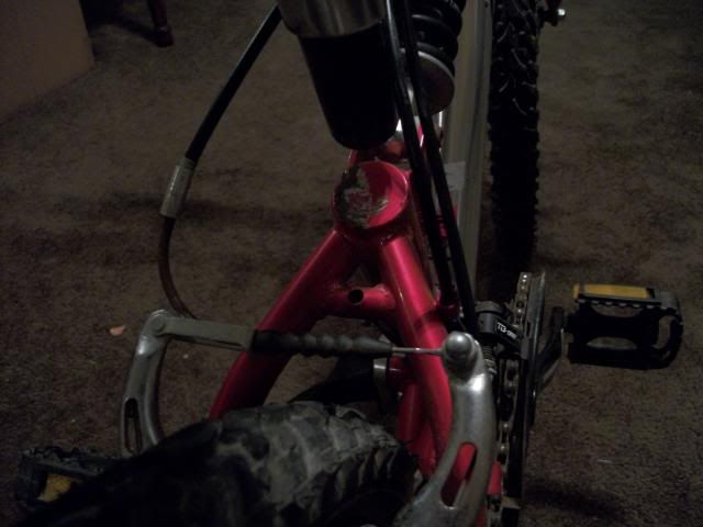

Thanks Curtis, I hadn't come across that post in my searches yet. It looks a lot like what I'd initially planned, but the rear fork on the bike looks like this...
Not much room for a latitudinal clamp. I'm thinking I may use a similar hinge setup, but clamped onto the rear seat post, that way even with the movement of the suspension, spring tension from springs mounted to the rear axle could help hold the tire down. I'm gonna have to get creative somehow...

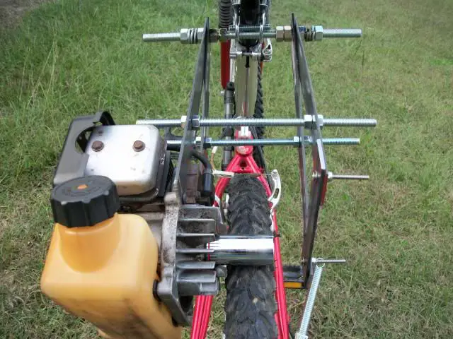

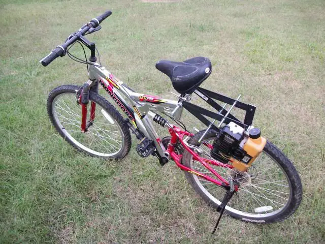

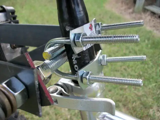

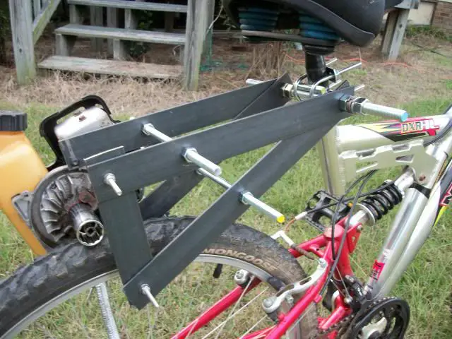

Progress!
The mounting frame for the engine is done!

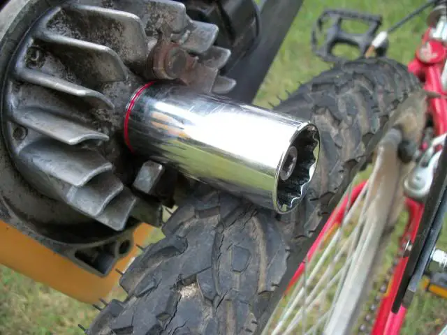

Drive peg is a 7/8" deep-well socket, 1.25" outer diameter.
Frame is made out of 1/8" weld steel.
No welding, everything will be bolted.

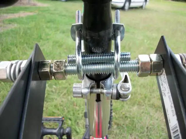

The threaded rod at the seatpost mount is 1/2", the rod bracing the frame is 3/8". The seatpost mount is temporary; I didn't have enough weld steel left to make a couple solid plates for the U-bolts so I'm using the janky plates that came with them to hold the bar on for mock-up. Just have to brace the frame to the bike frame for side-to-side movement, and then...
Throttle linkage!

I like your dual triangle shaped swing arms for mounting the engine. Some kits and home builts use a single piece of steel or aluminum for a swing arm with mixed results. Are you going to install a lift clutch (engine lift mechanism)?
Need For Steve
Oct 5, 2013
12
North Carolina
I'm not gonna use a lift clutch right away, though I'm sure it'd be quite possible with this frame. I'm just gonna pedal to start it, I figure a few calories burned starting it up won't hurt :D
It initially was only gonna be the engine-side triangle, but I very quickly found that this just wasn't strong enough, being mounted from the seat post. The second triangle tying it all together keeps the engine side from bending or twisting. I still have to run some braces from the seat post mount to either side of the bike frame to prevent twisting, but other than that, the mount should perform well as pictured. The roller is kept on the tire by spring tension.
