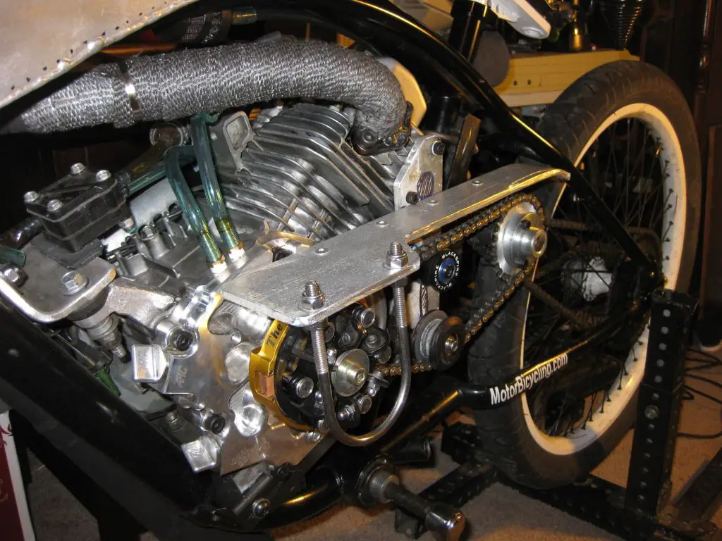

Huh? Reeeeeaally?
http://motorbicycling.com/showthread.php?t=32789
.wee.
Been looking around on the site for a while and haven't spotted a complete 212cc build, i mean you would almost expect one on a stingray for a cruiser, why don't people put these engines on i mean they are what , 120 bucks at harbor frieght? seems like a steal to me so whats the hold up? Don't they push you at over 50 mph?
Mine sure does.
