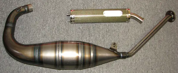

Just ordered this Arrow expansion chamber and kevlar silencer..Will cut it up and use the 'header' from the FMF pipe that came on the YZ to make the exhaust fit..

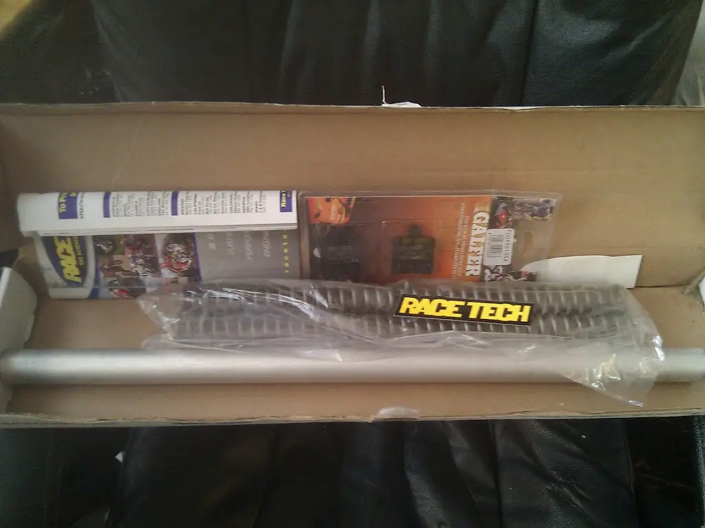

Unfortunately found out my fuel line was kinking up and starving the engine of fuel at high rpms. Fixed that with better fuel line, ant the bike feels great.
Tops out at at a speedo indicated 85mph, so more like ~78mph.. Could def. regear a few teeth smaller on the rear sprocket. The tires are shot so I was pretty haired on going too quick, so with some good sticky rubber I can tell it's going to be excellent. I got a racetech progressive spring kit ready to go on
a properly fitted K&N in the mail... The VFORCE reeds need to get installed..Got a new clutch kit coming because it feels like its slipping a bit...
