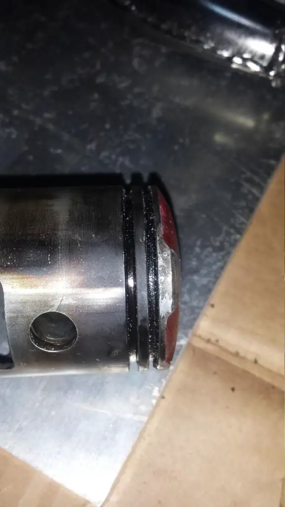

I'd be leery of grinding that deep down I to the ring groove, I ramp my pistons on exhaust and at thr transfer ports but I dont remove near that much material, when Im finished with mine half of the material between upper ring groove and top of piston edge is still there, seems you're putting a lot of hot gas behind that top ring with that much material removed.
Not saying it wont work but im not sure thats a good idea to have that compression ring xposed fully to combustion in that area.
