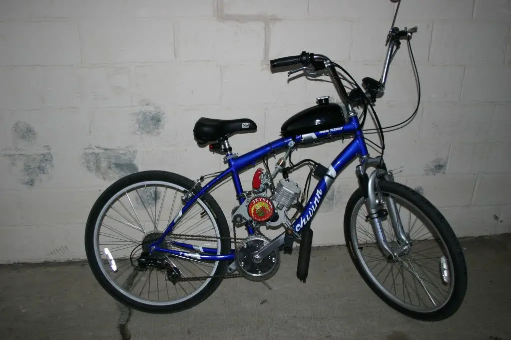

Hey guys...
Finally, after five long and hard days of working on this build...
I FINISHED!!!!! :)
I could have not done it without you guys, especially the ones that gave me advice on the problems I posted on my other threads...THANK YOU!
After putting it together, taking it apart, putting in back together, taking it apart, and finally putting it together...
here it is...
My First Motorized Bicycle Build
Finished Build
Grubee 66/80cc Slant Head Engine & SBP Shifter Kit
More Pics
Schwinn M Searcher - $160
Grubee 66/80cc Slant head - $175 w/shipping
SBP Standard Shift Kit - $170 w/ shipping
Hours spent working on it - PRICELESS
TOTAL - $505 plus priceless Labor
Let me know what you guys think...constructive criticism & advice is always appreciated.

How difficult is it to install the SBP Shift Kit the first time?
-it is not difficult to install...all it takes is patience and the right tools. Make sure you go to downloads and look at their jackshaft manual, bottom bracket description, and freewheel maintenance.
Also...if you buy a bike with a cartridge bottom bracket-the Searcher-make sure you buy the cartridge removal tool on sbp website...without it you're gonna waste alot of time. Also...get a crank removal tool, a chain breaker, and some freewheel oil.
What would you give a heads up on for any problems to expect with the same set up?
1. You're gonna need a grinder/file and drill for the shift kit.
2. you're gonna need to make a custom front bracket. I used two 2'' muffler clamps to intsall the engine. But i would suggest you get the custom clamp from sbp. PM if you need help with that.
3.You are gonna need alot of patience if its your first time like mine was. After you finish the first build, you learn alot and i am sure if I were to do it again...which I will lol...it will be 100 times easier.
Good luck with your build, and if you need more info just post or pm.

Nice bike, however, I would reroute the wires, they seem to be a little close to the exhaust. looks like shes fun to ride. Good job!
